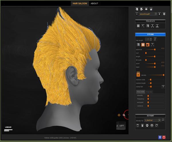

    I got using the scroll to zoom in and out but is there an easier way to pan the scene easier? That little move icon being so close to the edge allows for very limited panning, more like scootch, then scooth, then scootch.... :P
    Screen grab shows the visible hair settings for this redo. Shows the cursor to the side there where the edge of the UI stops the mouse dead in it's tracks. I think there's a way in the code to allow for the mouse to continue after it hits the edge so that the end user can continue to move, zoom or pan.

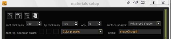

    OK... exporting the hair at 120,000 still is giving me a very thin haired render. Bringing up the Materials Setup I set the roots to 240 and the tips to 190. So this is the area that's going to confuse folks. Even the PDF doesn't help me there too much.

    Hi Richard to pan the camera right click and move the mouse, that will do. In 1.1 update we fixed the issue about the mouse "limited" to the preview screen...

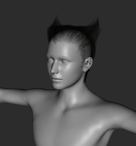

    Rendered with 120000 for export.
    Still looks very thin to me.

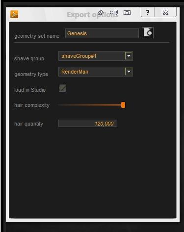

    Ramwolff, when you open the hair settings again are they at 250 or something else? How many groups does the hair have? Are you exporting as curves or obj? Just wondering. We'll figure this out :) The hair density, is it set at full? the slider all the way to the right?
    Settings below.
    Groups? You mean Shave Groups? I only have one for the whole thing. Rather than splitting them up I just use the Ctrl and mouse to shorten and lengthen hairs. Exporting as curves. Tried the Obj and that looked really weird, like little snakes coming out the head.
    656 x 151 - 37K

    Ramwolff
    When you export the hair to daz studio there is a box to enter a number in the Hair Quantity the number you enter there is how dense your hair will be when you render in DS.
    Hope this helps mate!

    Ah, well the numerical setting is 120000 as Alex suggested.

    Hi Ramwolf,
    When you enter the Hair Quantity make sure that you press ENTER afterwards, whilst the cursor is still in the quantity box, otherwise LAMH will not register the hair quantity valye that you have entered.
    Then just export as normal..

    I just looked at your Screenshot you posted and you have 120,000 in the box try 120000 I am sure the , don't need to be there. so it could be placing just 120 maybe? because the comer is messing the number up. this is just me thinking haven't had much time lately to do anything.
    Steve

    Hmmm, I guess entering Enter after the 120000 number worked. Weird!
