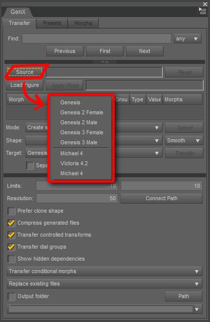

    Do not load Genesis Figures via the Load Figure Button. They should be listed in the Source Button.

    1. Choose Genesis2 Female via the Source Button ( this should load Genesis2 Female in GenX, does it? )
    2. Choose Genesis3 Female as your Target
    3. Mode needs to be Selected Morphs
    4. Expand the Region Actor Section
    5. Check all Morphs you would like to transfer on the left side of the morph list
    6. At the bottom of the GenX2-Tab , make sure the option Transfer Conditional Morphs is selected.
    7. Click the Transfer Button
    8. When the Transfer is done, reload Genesis 3 Female to your scene and take a look at the Shaping Tab
    In the Shaping Tab, there should be the G2F-Clone Shape in Genesis3 Female => Actor => Generation X => **People**
    and the character morphs in Genesis3 Female => Actor => Generation X => Genesis 2 Female
    As a sidenote HD Morphs can only be transfered between Genesis2 Figures. It will not work between different Genesis Generations.
    You may take a look at this one: http://www.daz3d.com/forums/discussion/comment/1043390/#Comment_1043390
    And this one too: http://www.daz3d.com/forums/discussion/comment/1060726/#Comment_1060726
    Let me know if this was helpful.
    Edit: Updated the Screenshots.

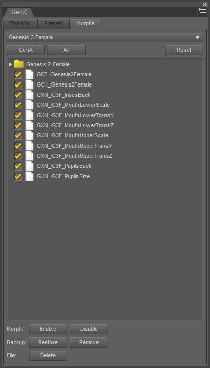

  • marblemarble Posts: 7,500
    By coincidence, I spent a day playing with this yesterday. At first I was also stuck on the Not Valid error until Havos helped out with an explanation. I then successfully managed several character transfers from G2F to G3F.
    However, late in the evening I realised that my regular G3F base figure (and thus all my G3F characters) was being oddly distorted when posed. Things like the rear thigh muscles became badly indented and a geograft I use for G3F became mis-shaped. I'm not sure what I did wrong in the transfer but I suspect it was something to do with conditional morphs as I had no idea which option to choose.
    Anyhow, I found the GenX folder under data and deleted it - removing all the work I had done yesterday. Thankfully, my G3F women and their thighs are now back to normal.

    Normally odd things start to happen when there are two morphs with the same name. Thus if GenX transferred a morph with the same name as one you already had under G3F this can sometimes end up being applied twice, thus distorting the model in undesirable ways. Strange though that you were seeing this simply by posing a bare G3F with no morphs, did this happen even when the additional geograph was not added?
  • MN-150374MN-150374 Posts: 923
    edited March 2017
    As you can see in my example of the Aiko6 Transfer, with Transfer Conditional Morphs, there is also the Aiko Body Shape transfered and everything Aiko6 related gets transfered too. Not sure if there are correction morphs included to prevent distortion.
    You can switch inside GenX from Transfer to Morphs. Choose your Base Figure and click on the GenX button to list all GenX generated Morphs. And there are the options to delete and to disable morphs.

    Confirmed, it is possible to have overlaping morph names and sliders. In the screenshot, one is the Victoria4 Clone Shape and the second one is Victoria4 for Genesis. You get weird results when you dial in the slider (2): Victoria4 in the first section of the screenshot.
    Yes - I also suspected the geograft so I removed it. Same problem. Then I shut down DAZ Studio and restarted then loaded the base G3F figure - no morphs, character or geografts. Still had the distortions. That's when I concluded that it must be GenX and deleted the GenX data folder.
