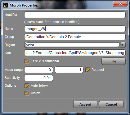

To transfer the character, select the values as shown in the image:
Genesis 2 Female was selected by clicking on Source.
Mode: Create Single Morph -> creates a single morph
Shape: Genesis 2 Female
Target: Genesis -> selects the target, in this case, G1
Use the button Select to chose the entry Get Values from Figure in Scene . It will select the values of each morph of G2F in the recent morphlist of G2F and transfer them to GenX2.
After the values are transferred, clict Select again and chose the option Transfer: On for All Non-Zero Values for all required morphs.
Click on the button Transfer to start conversion.
A window pops up where you have to enter the name of the morph. The field Identifier should remain empty.
GenX2 doesn't make a suggestion in the field Icon in this example. Through the button File you can add the path to the respective image.
Click on the button Accept to complete conversion.

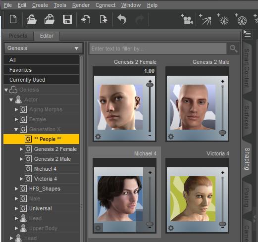

If you reload G1, you can see the new shape in Shaping , the Clone Shape Genesis 2 Female for Genesis1 at
Genesis -> Actor -> Generation X -> **People**
and Imogen_V6 at Genesis -> Actor -> Generation X -> Genesis 2 Female

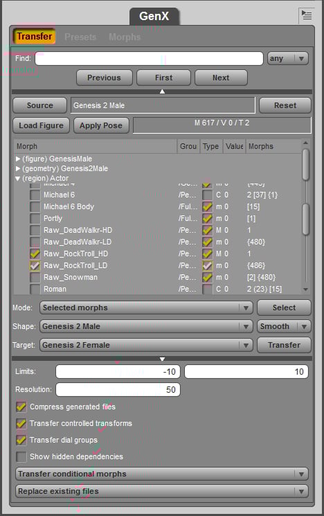

If you would like to transfer full character morphs like Victoria 6, Michael 6, Mei Lin 6 and so on. It is even easier than transfer a customized character like the described Imogen for V6 character.
Choose your Base Figure Genesis2 Female or Genesis2 Male via the Source button. The GenX-Tab will show all full character morphs if you expand the (region) Actor section.
Now on the left side check all the morphs you would like to transfer and make the following adjustments in the GenX-Tab:
Mode: Selected Morphs
Shape: Genesis 2 Male ( or Genesis2 Female - it is always the same as your Source)
Target: Genesis
Click on Transfer.
Reload the Genesis1 figure and the transfered morphs should be in the same section BeeMKay told you in the post above.
If you would like to transfer just a simple Head Morph, click on Reset, choose your base figure via the source button and expand the region (Head) section. There you will see all the head morphs you have. Same applys to all other body regions, expand the required body region (hand, feet, legs) and check everything you would like to transfer.
Ah, thanks! I didn't notice that Region/Actor tab before. So if I'm converting Mei Lin straight-up with no special poses or morphs or whatever, then the only things I need selected in the expanded Region/Actor screen are Mei Lin 6, Mei Lin 6 Body, and Mei Lin 6 Head. Correct?

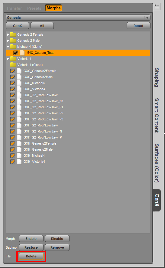

Yes, thats correct! As sidenote, if you are not pleased with a transfer result, just go to the GenX tab and switch over from Transfer to Morphs. There you will see all your transfered morphs and there is the possibility to delete.
Don´t be afraid about experimenting. There you have always a second chance. :-)
Obviously I'm missing a step here, because it's not working. I've tried converting Mei Lin twice. Each time afterwards, I've cleared the sceen, then loaded the G1 figure. My new "morph" appears under shaping with the appropriate name and icon. But when I select the morph and increase value to 1, all that happens is that my G1 shape gets shorter. (Mei Lin is petite in stature.)
You have to dial in the Genesis2 Female Clone Shape also. Take a look in your Shaping Tab at: Genesis -> Actor -> Generation X -> **People**

My G2F tab is there. Setting it to 1 makes my Genesis a female, but the Mei Lin slider only makes her smaller. It does not transfer Mei Lin's physical features.

By going through the screenshots, I see what the problem is. You are still mixing the two different methods of conversion.
Now try this, just start with an empty scene. Don´t load Genesis2 Female/Mei Lin6 in the scene. Go to the GenX2-Tab and follow these steps:
1. Choose Genesis2 Female via the Source Button
2. Check Mei Lin 6 and Mei Lin 6 Body in the Region Actor Section
3. Change Mode to Selected Morphs ( Create Single Morph is causing the problem in your workflow!).
4. Go to the bottom of the GenX2-Tab and change the option Ignore Conditional Morphs to Transfer Conditional Morphs
5. Click on the Transfer Button
And thats it, now load the Genesis figure and you should have both Morphs you selected, Mei Lin 6 and Mei Lin 6 Body.
In case of Mei Lin 6 you don´t need a figure in the scene nor do you need the values from figure in scene. And there will be no longer a dialouge to give the single transfered morph a name.
