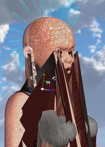

  • Swawa3DSwawa3D Posts: 231
    This plug in is excellent! I'm very excited to finally be able to mess around with making hair from scratch. I find it fairly easy to get decent results and I have seen a lot of amazing renders from the beta testers here.
    It would be great for launch to have nice documentation and several presets for hair styles, maps, lights, shader settings, etc. to make the plug in more accessible. I understand it might be far off but I would love to eventually see mesh export for use with things like Reality. I have not used Reality yet but I hear it's a lot faster & easier to get good results and I have seen some incredible renders done with it.
    I am having some issues with a strange graphic glitch & stability if I slide a morph dial on a genesis figure wearing the hair. It seems avoidable by entering numeric changes instead of sliding the dial. The glitch usually remains until I reopen the file and it sometimes slows my system down and crashes DS. I'm guessing my system just can't handle rapid morph changes with the hair. Attached is an image of the glitch and here is my system info in case it helps: Intel Core 2 Duo 3 GHz, 6 GB RAM, GeForce GTX 560 w/4GB, Windows 7 64 bit.
    Thanks.

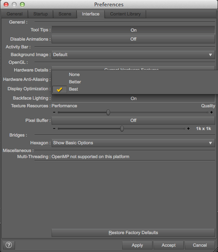

  • SedorSedor Posts: 1,764
    Thanks.
    Regarding the glitch which display optimization have you set? I've seen this glitches sometimes when the graphics card can't work with the current settings - it helps to go one level down. When you have finished this scene you can change it back.
    537 x 620 - 62K
    I had it set on "best". So far lowering it to "Better" seems to help, although moving my camera becomes a bit laggy but as you said I can always switch it based on what I'm doing at the time. Thanks!
    Yes, it becomes a little bit slower - but as you said, you can switch always between best/better just as it is needed.
    Fine :)
    So yes, more documentation etc is coming, currently the goal has mostly to get the software to a more robust state. Unfortunately with anything like this it can be a bit frustrating to try and work out what, how and why things are.
    Do you get the same issues if you remove the hair node from your scene? The graphic issues appear to be affecting only your character geometry?
    Looks like the clothes are being distorted too but they are following the figure so it could just be the figure. I've been using DAZ for about half a year and this never happened before. It only happens after adding a hair node to the scene and then setting it up. Sometimes it just happens for a second other times it stays. Sometimes it stays even after deleting the hair node. Re-opening the file fixes it until it happens again. Sometimes it leads to a crash. Also note that so far I never had the glitch while the display optimization was set to "better" and this setting also instantly fixes it. So I'm assuming my graphics card just can't handle the "best" optimization with the hair splines?
  • SpyroRueSpyroRue Posts: 5,020
    I haven't had a problem with morphing the character wearing GH or adding clothing to a character wearing GH... However, Daz crashes if I try to fit a GH on a different character from which it was made on.

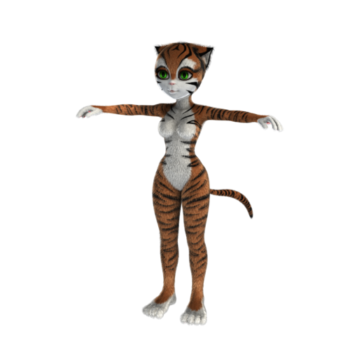

    I've been trying to work with the "Catgirl Genesis" character and it's killing my system. It has several Geografted parts. I had 6 nodes on 6 different parts but tried cutting it down to 4 and that did not help. I have maps for color (base/tip) and density on all of them. When I try to render or sometimes in the hair setup my computer gets so slow my mouse stutters at like 1 frame per second and my hard drive reads like crazy. Tried to check my ram but I could not even switch back to task manager. I know there are lots of settings and things I could try to optimize (I took notes on this entire thread) but I have difficulty accessing them with this file without crashing. I did start out with defaults and modified it a little to get the look I wanted. Just curious if this can be optimized or if I'm just trying to do too much with this plug-in on my system? Maybe Geografted parts the issue? Has anyone had success doing full furry figures with Geografted parts on a system close to mine?
    I also noticed that I was importing a ton of duplicate maps as separate images to have them match the names of the surfaces. Not sure if it would help but is there any way to have it use 1 map for several surfaces when I import density/color maps? It just seems horribly inefficient loading dozens of extra unnecessary images.
    Thanks in advance if anyone can help. Otherwise on my system I might just be limited to simple hair styles. Or maybe it will be optimized by final release.
    1200 x 1200 - 470K
  • futurebiscuitfuturebiscuit Posts: 0
    So basically it sounds like you're running out of memory when rendering. A few things you can try are (in a vague order):
    * Don't use ray traced shadows with your lights or reflections in your materials.
    * Set the rendering mode to 'Disk Cache' in the Garibaldi Node rendering options (will be the default for new hair nodes in beta 12+).
    * Reduce the Pixel Samples X/Y and Shadow Samples in the advanced Daz rendering options (this will reduce the render quality but also reduce render time and memory).
    * Reduce the bucket size in the advanced Daz rendering options (this may slow down rendering a little, but result will stay the same).
    * Don't use 'UberLights' or at least reduce the settings.
    * Use less hair strands (You can quickly lower this with the 'Render Percent' in the Garibaldi Node rendering options).
    * Use a larger segment length for the hair strands (set with the 'seg length' option in the interpolation options of the style workspace).
    Yes, it's not great, but the images are compressed in memory when not in use, and on the scale of things there relative memory usage should not be too great.
