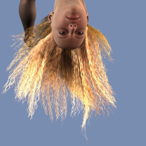

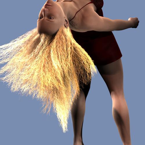

    Power's back on! Thank you Alisa! As promised, two more from different angles.....
    1024 x 1024 - 565K
    1024 x 1024 - 551K

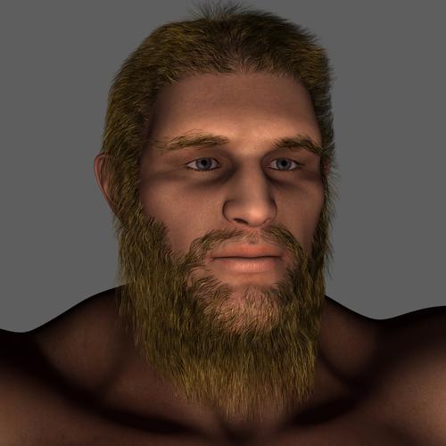

  • GoneGone Posts: 831

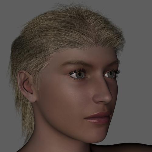

    Well, here's my beta 6 hair. :-)
    I tried the disk cache with mixed results.
    There are 2 hair nodes used here. One for the head and one for the eyebrows.
    When I turned the head to disk cache, I got a R5017 error. It didn't stop the render but there was no significant speed increase either. When I added disk cache to the eyebrow so that both nodes were using it, I immediately crashed to the desktop when I tried to render.
    On a seperate note, I tried to use this texture for a texture map in Garibaldi. It worked fine for providing a texture colour for the head hair. When I tried to use it to line up paint with the eyebrow it came back to DS above the textured eybrow. I had to repaint it lower in order to line up with the texture in DS but that meant that Garibaldi was now taking the texture from the skin instead of the brow so I couldn't use the texture map for the brow node.
    1200 x 1800 - 426K

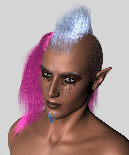

    This is a render from the beta 5 testing - sorry its artistic value is negative, I would come up with a better colour scheme if I had more free time these days. Every length group on the head is a new Garibaldi node, the brows and the beard are also two different nodes. For weird hairstyles like this (the ones I have loong wanted to have for my characters! =)), I find it very efficient re-importing the same density map for the head and erasing it in unwanted places. Though I have to say sometimes it's tricky to get the eraser to black the map out fully.
    I tried using multiple density maps within a single Garibaldi node, but it didn't seem to produce the results I wanted (only one map would render at a time)
    A note for Paint.NET users: while doing the brows, I noticed that PNG files saved from Paint.NET won't load (even if you just open a Garibaldi generated texture, paint over it and save back - image information says PNGs are the right type etc, but apparently Paint.NET uses a weird algorithm), I needed to reexport them from IrfanView using PNGOUT.
    As for beta 6, I have not rendered anything yet (I hope the disk cache mode works for me) because DS crashed twice on me when I was saving a scene in which I created hair for vintage A3. Is that OK? Should I just stick to Genesis for the time being?
    600 x 720 - 83K

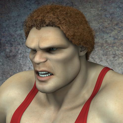

    Just a quick test in version .6...Hair and Eye Brows...
    1024 x 1024 - 409K

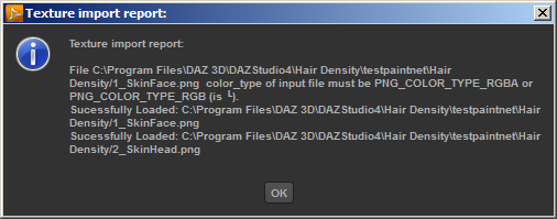

    Well garibaldi uses the standard libpng impelentation for loading png files... I haven't had any troubles with it so far. Being that Paint.Net is quite popular I'll add it to the list of things to look into.
    Did you get any errors in the dialog box that should show after importing the image directory?
    Here is the error message, "color_type" is mismatched. SkinFace was saved over in Paint.NET. Garibaldi then proceeds to say it's loaded successfully, and indeed the mesh turns from transparent to dark, but it is uniformly black, the white colour does not come through.

    Gone said:
    It isn't the UV set. The texture in the render is the same one used to produce the density and texture maps for Garibaldi. That's why I was surprised when they didn't line up.
    Seems very strange... It's not that the image files imported/exported from garibaldi are currently flipped compared to the textures used in the daz studio materials?
