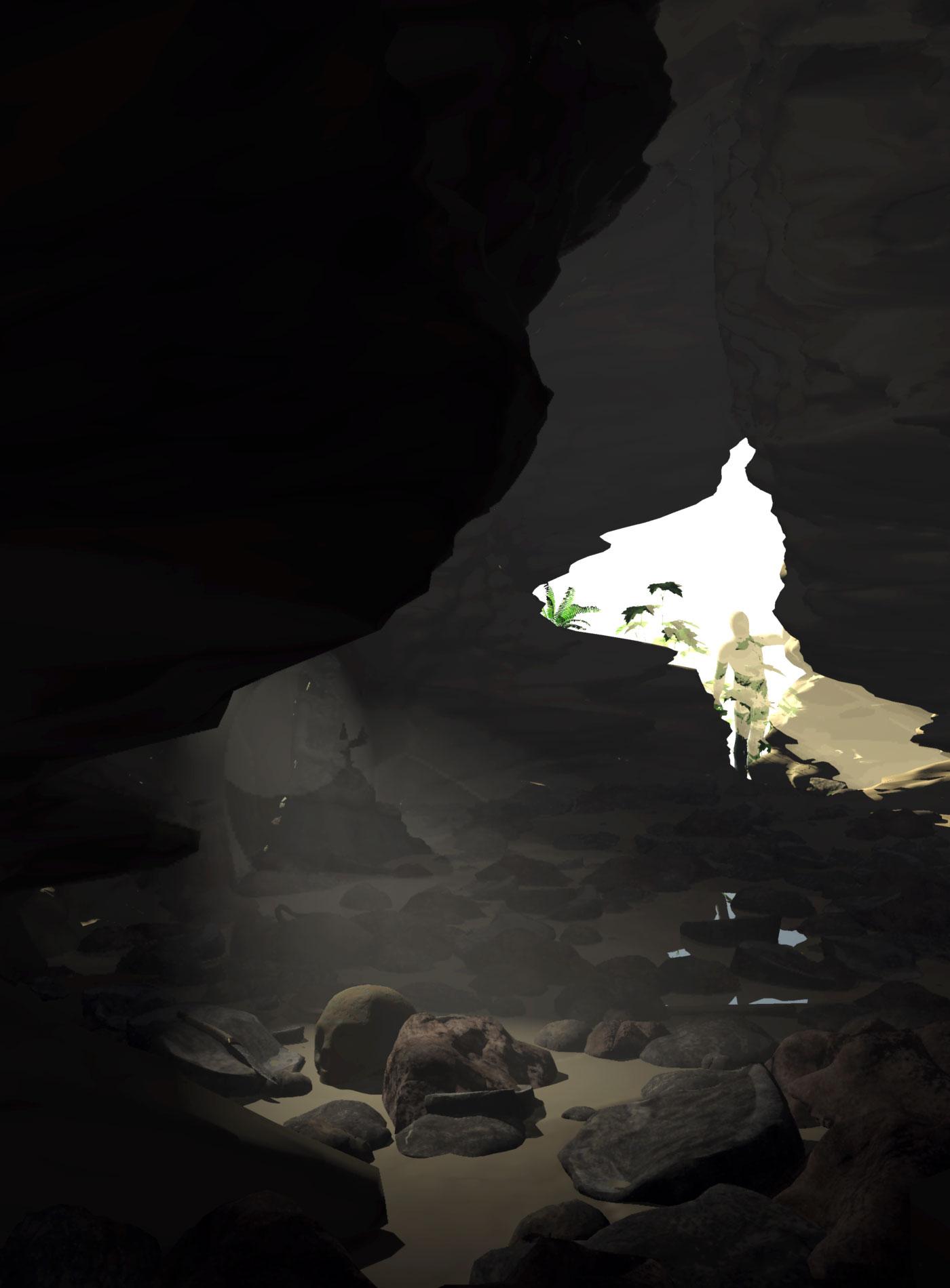

    Cool. I can picture it now. With Errosion/Rain turned on you could end up with some stalagtites also.
    What I'm thinking of for an ouside view to the cave entrance is changing the terrain to a vertex object and, going to the vertex room of course, start messing with polygons etc and then extrusion to form an opening. Am I on the right track?
    Yup. That's one of many ways to go about it ;)

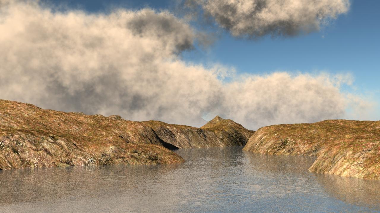

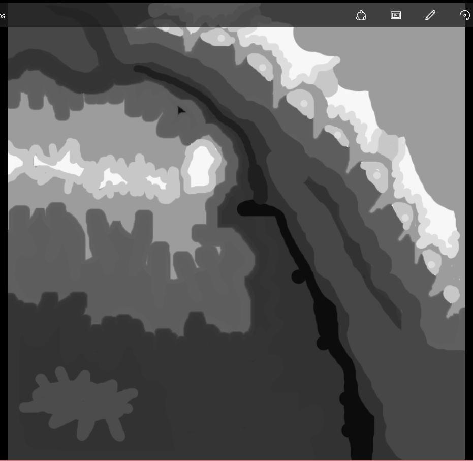

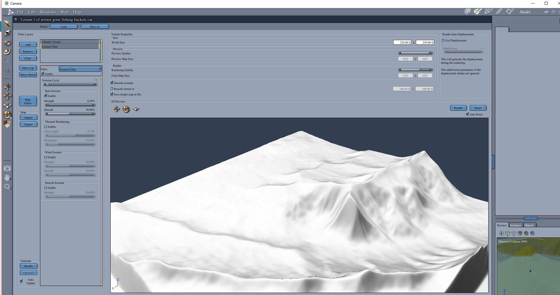

    I am a big fan of the erosion filter, but for medium scenes one has to remember to use very low settings.  I start with a rough greyscale map made in an image editor, then use the erosion filter to adjust to taste.  In this example, I also created a creek channel and opacity masks for a replicator along the banks of the creek.  Here is the start.
    The initial simple map starts with a very rough terrain that would ot be suitabel at all.
    But with importing a second terrain map (the black river with white land) set very low, and then applying a rain erosion filter set below 1%, the terrain improves.  I then duplicate the terrain, remove the river map, and flatten it in the z axis, apply a water shader, and raise it in the z axis, which provides the river in its channel.

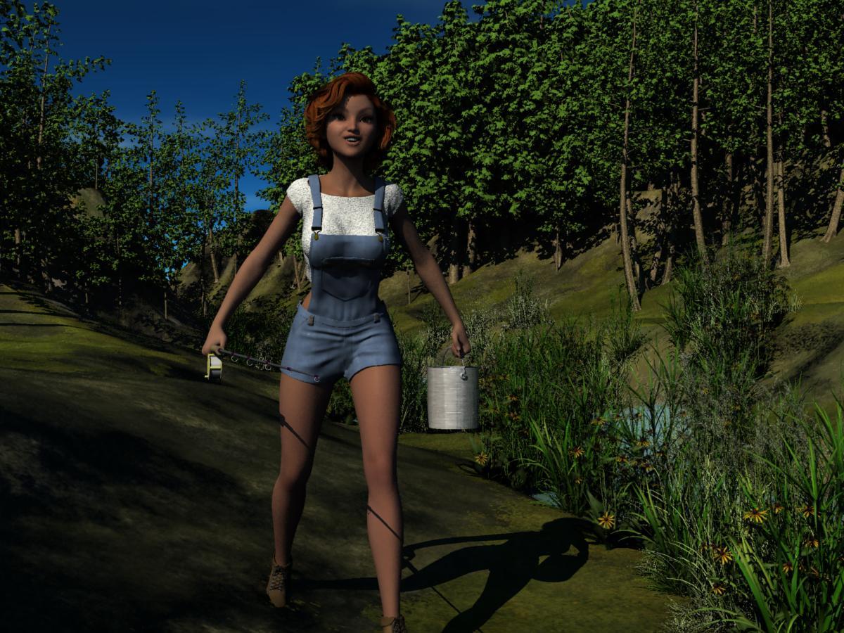

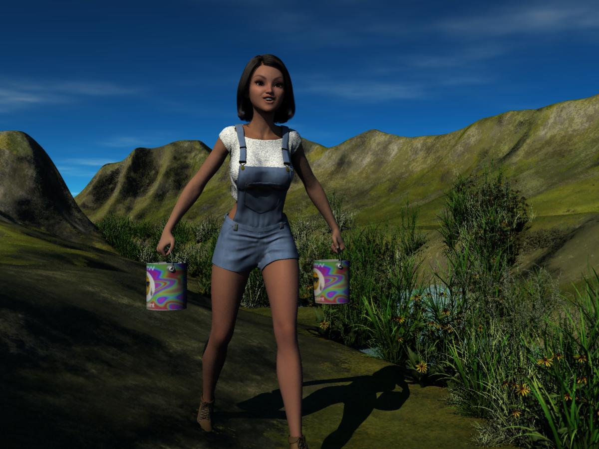

    And here is a draft with a figure.  Unfortunately, I don't have a fishing pole prop so these buckets are just placeholders.  And I will adjust the camera angle to get more of the creek.
    1200 x 900 - 126K
    Post edited by Diomede on

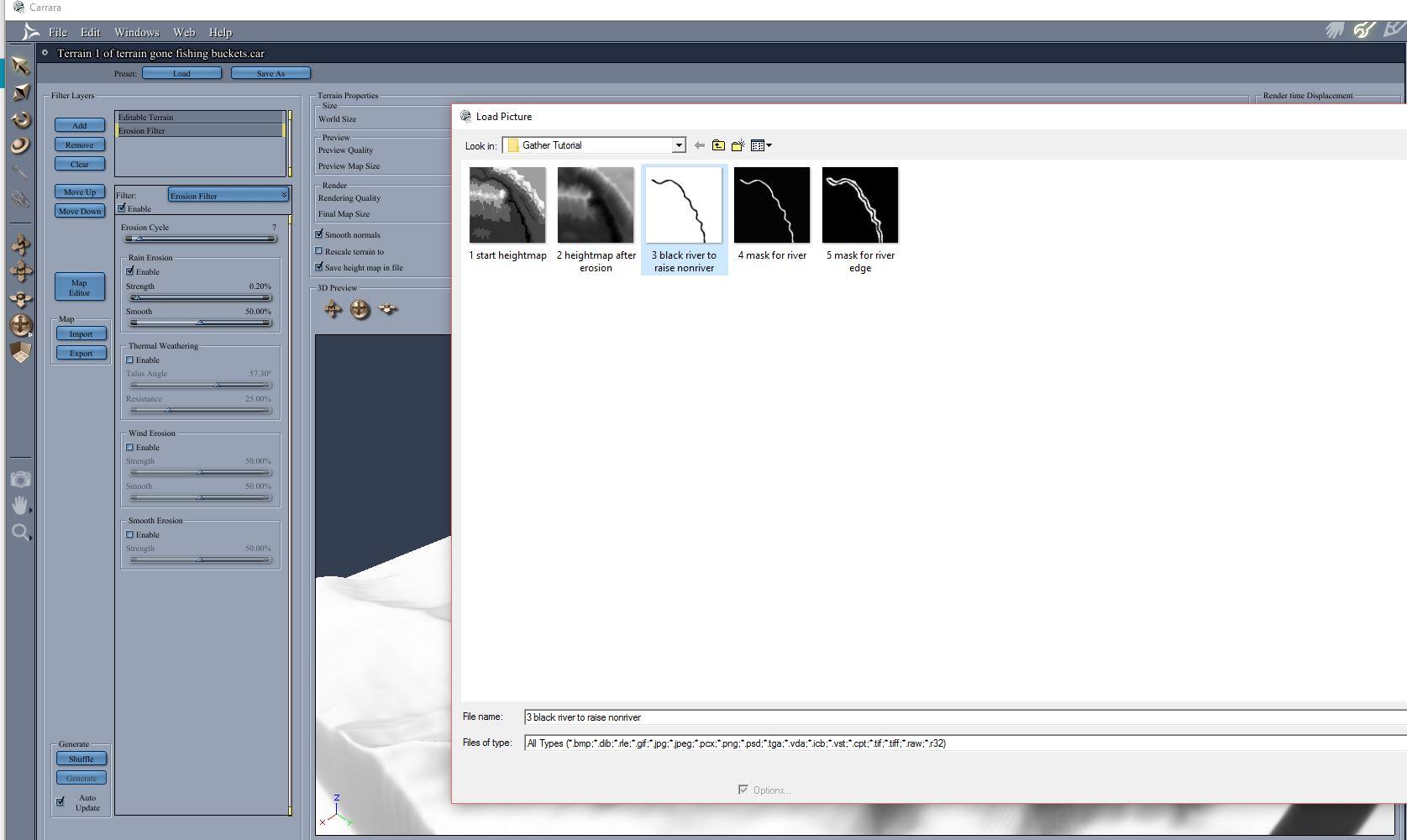

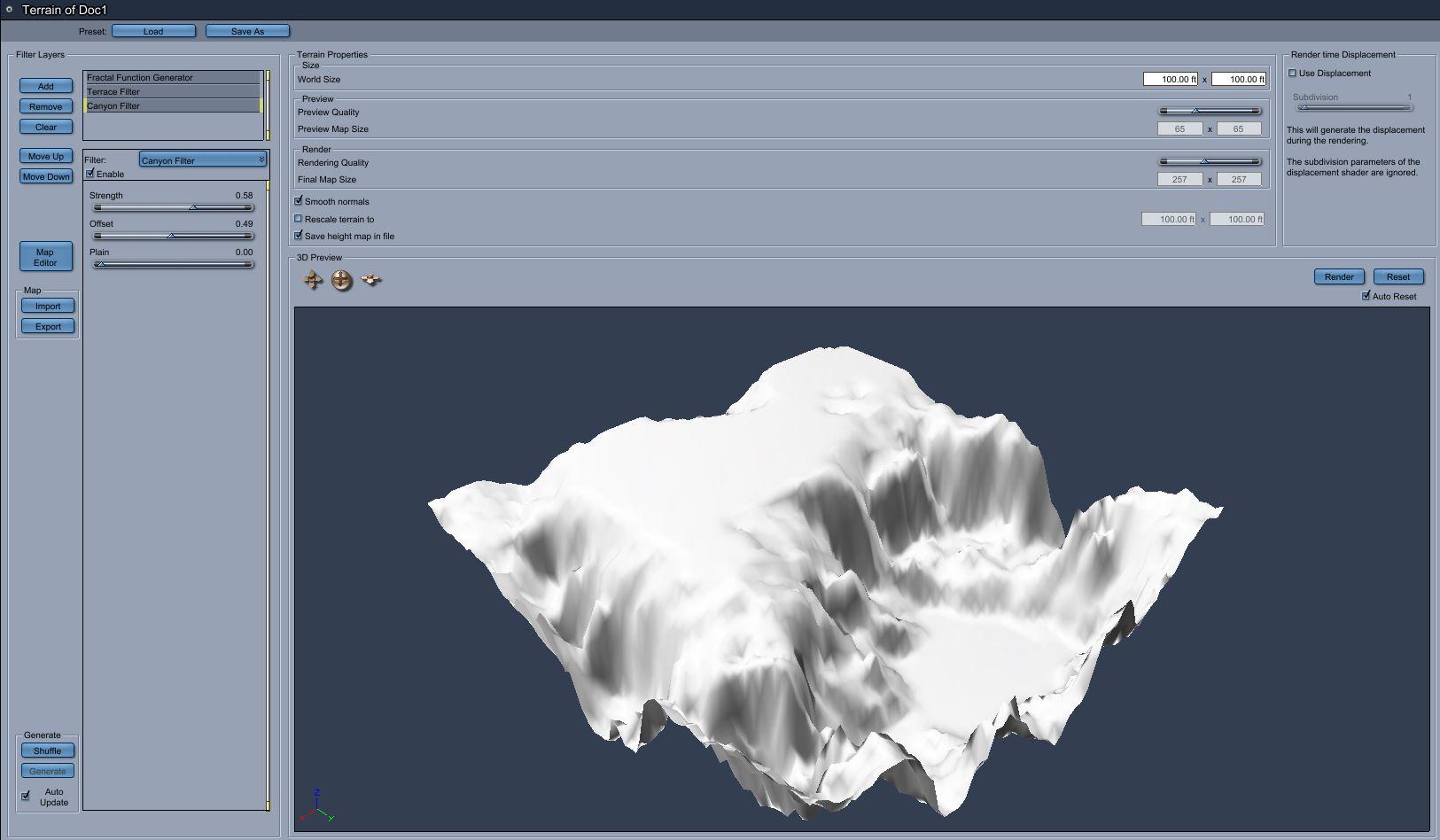

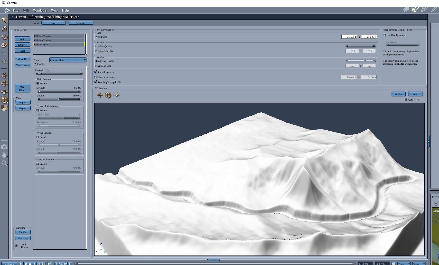

    Here is a closer look at the composition of the stream.  Here is the terrain modeling room with just the initial rough heightmap and a very small rain erosion.  Notice the existing valley.
    Using the ability to load a second heightmap, here is the terrain modeling room navigating to the river height map.  The map was created making sure that the black river channel went through the lowest part of the first heightmap.  River is black against a white background.
    Here is the terrain modeling room with both heightmaps and the rain erosion filter.  The second heightmap is set low such as 5 feet.  This results in the white area rising 5 feet but not effect on the black area.  That creates the river channel.
    There are several options to create the river itself.  In this example, because the river falls gently,the river is just a second terrain model.  It is a duplicate of the first, but without the second heightmap (no river channel).  Use the scale tool to flatten this duplicate in the z axis and apply a shader that you want.  I also applied a filter make the river surface undulate.  Move the second terrain up or down for how deep in the channel is desired.
    1904 x 1005 - 180K
    1675 x 1000 - 144K
    1709 x 1033 - 182K
    1200 x 900 - 90K

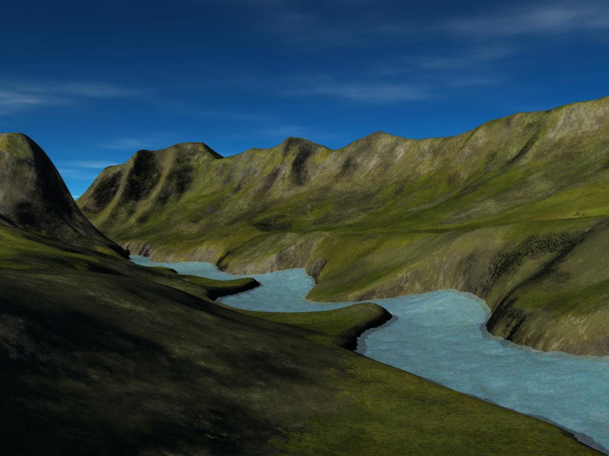

    If the duplicated terrain is not resulting in a satisfactory river, one can use the heightmap that was used to create the river channel as a mask for a layer list shader.  Just apply a water shader to the river channel, but then one has to watch for the shader being applied to the steep banks.
    And here is another update using a fishing pole by Alninja on sharecg and replicated trees from Dartanbeck's woodland realm set.  I used one of my heigtmaps to control te replicator because the river valley is near black.  For greater control of replicator placement, you can always duplicate the terrain and then make opacity maps with the 3D paint tool.
    1200 x 900 - 195K

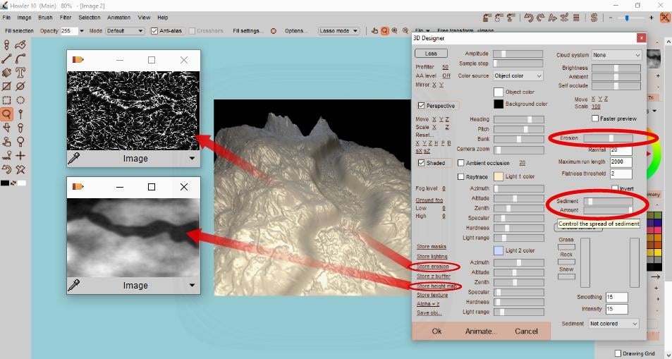

    Very much like diomede, I really like using erosion at times. Being a huge Howler fan that I am, I no longer fiddle with the erosion filter in Carrara's terrain editor, since I often accidentally crash my system getting too crazy with it.
    In Howler, I start with a simple (or not so simple) height map, and enter the 3D Designer, where we have many tools available for tweaking the height map in many ways - including adding erosion (with Rainfall slider) as well as sediment.
    We can then export an actual OBJ of the result or, my preferred method is to, export a new Height Map which depicts the changes made, as well as some of the extra settings on their own for further tweaking, if needed.
    Then I just bring the final map into Carrara and tweak away ;)
    953 x 509 - 392K
    1280 x 720 - 667K
    Post edited by Dartanbeck on

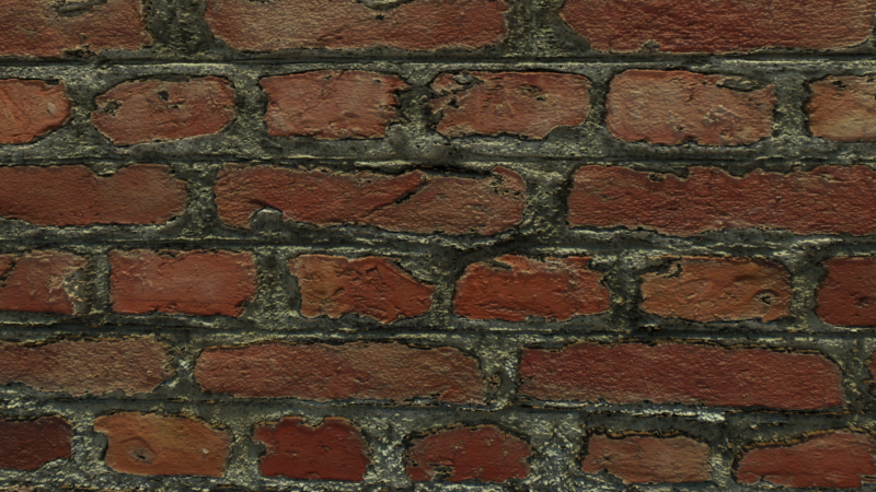

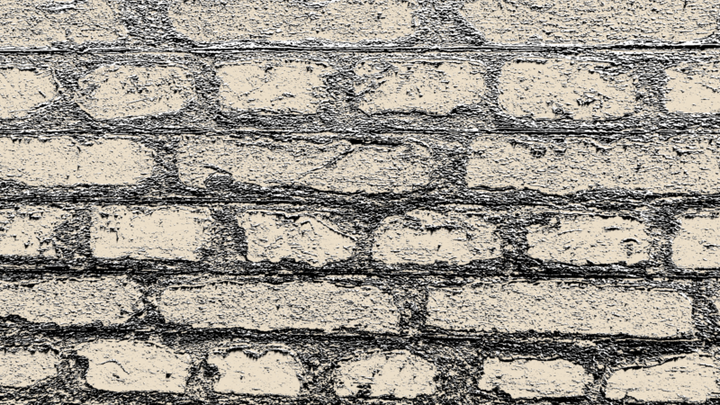

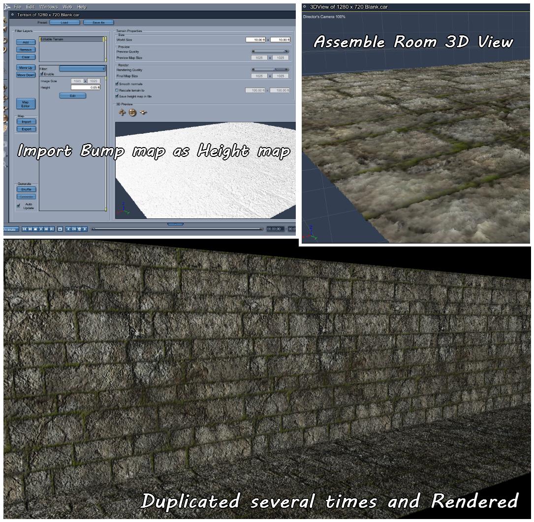

  • Speaking of Modeling, and being in the Building Carrara Terrains thread, I'd like to share something fun:
    Owning Carrara, we have this powerful and fun modeler at our disposal which is the Terrain modeler, into which we may import texture maps as height maps, which get converted into a 3d mesh.
    So here I just imported a bump map for a brick wall into the Terrain modeler (world size set at 10' x 10') and adjusted the height of the effect, as well as the resolution of the mesh, to my liking.
    In the Texture Room, I've changed the shader from a Terrain shader to a Multi Channel, and brought in the accompanying texture map for the color, and still loaded in the Bump map under the Bump channel, but later found that it isn't needed at all. As it turns out, this renders a LOT faster than if I'd have used Displacement onto a flat plane, as well as being immensely easier on the working view.
    Anyways, while this might not be the greatest way to try and make 'real' geometry, it does help when we need something - and we need it fast!
    Using the terrain editor to make walls or other background is something that is part of my usual workflow. I like it because it's an easy and efficient way of having solid geometry and, specifically, nice self shadowing. See this post for example.

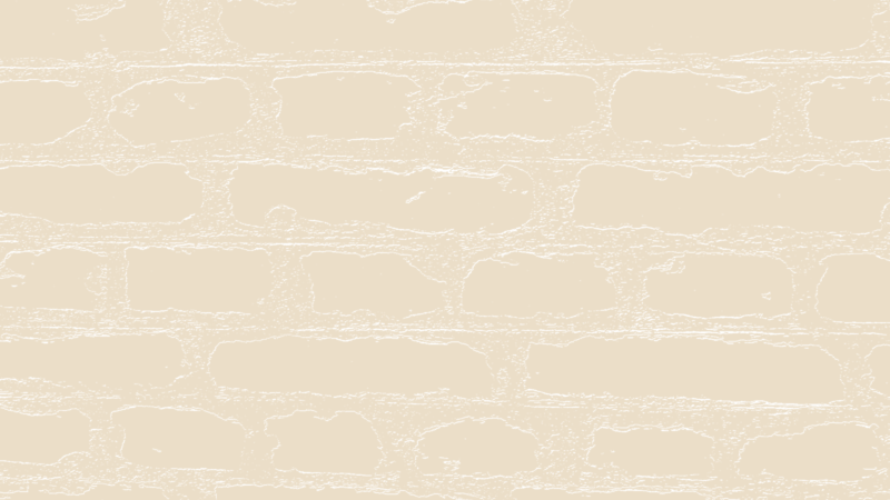

  • DartanbeckDartanbeck Posts: 22,132
    Awesome, Pilemo! I agree. As for the post and us not having much control over attachments, I think the images you refer to in the post are reversed, right? So example #1 is the bottom one, #4 being the top? Let's try this: (here's a copy of Philemo's post - but it's still worth going to that thread for more WIP information)
    For me, the advantage is in the self shadowing brought by having true geometry instead of faking it with bump map.
    You can see below:
    #1 using terrain
    #2 associated shadow map
    #3 no terrain (flat plane)
    #4 associated shadow map
    #3 is neater than #1 (there are resolution issue with my bump map), but, as it will be blurred by DOF, self shadowing is more important.
    Actually, having starting to work on it gave me a lot of ideas, specifically if you associate an alpha map (thus not limiting yourself with rectangular shapes). for instance, I remember a recent post about a turf roof. I think you can achieve good results using terrain.
    You can clearly see his point, where having that 'real' shaping in the geometry itself provides for 'real' shadowing. I think that where he's talking about it not being 'neat' is attributed to it being a very realistic representation of that sort of wall... which has a lot of texture from the masonry being done in a hurry, as well as the fact that, building geometry from a map like this in the terrain editor does have its price in quality-of-geometry, but since it IS made from a map, the software created a lot of geometry - so it's really quite accurate - making for a really nice wall!

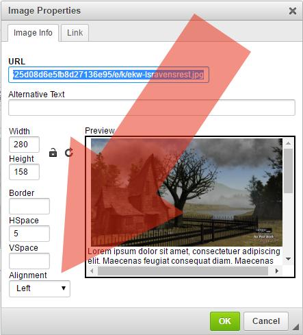

    In your posts... how do you get text next to a pic?  I'm thinking that you might be using the table function but probably wrong... tried in my earlier post here without using table with no luck.
    It's the text wrap positioning drop-down at the bottom of the Image Properties panel. Note that I also add some horizontal spacing (5 in this example) otherwise the text can get too darned close to the image, making it look weird and more difficult to read/enjoy the picture ;)
    Also, right after I paste the image addres in, I edit the size. Sometimes it won't automatically scale proportionally if we try to edit that later, like after sumbitting the post. So I try to get it down to a width of 200 - 300 px... sometimes smaller, sometimes bigger - depending....
    443 x 489 - 173K

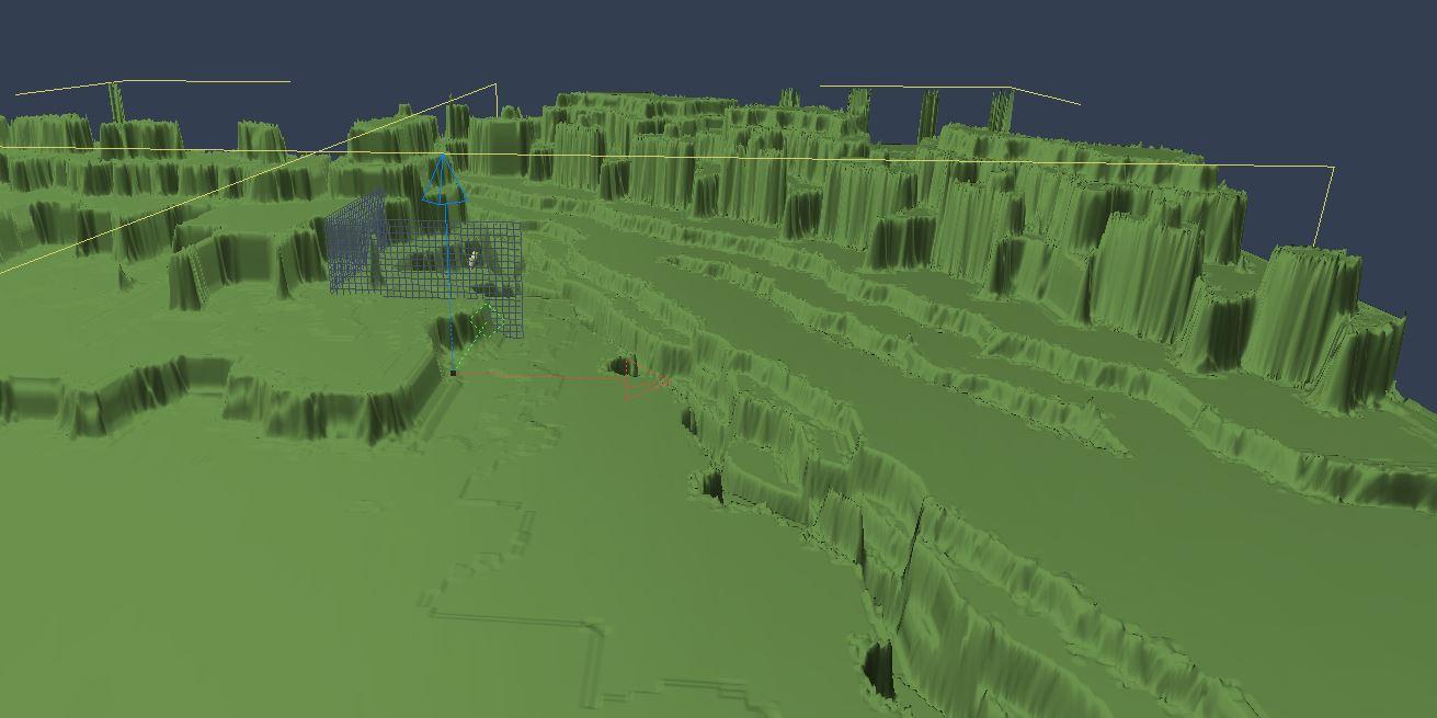

    Not sure if this was mentioned yet (I only quickly skimmed the thread) but along the lines of using terrains as walls and backgrounds, they make great caves!  Here's one of my near-infinite list of never-finished projects where I turned a terrain on it's side, duplicated and reversed it and voila! instant cave! :)
    Actually, now that I look at this, it was a little further along than I remember - maybe I will actually move it back from my "abandoned" folder to my "WIP" folder. :)
    1625 x 948 - 139K
    1625 x 956 - 189K
    1400 x 1900 - 128K
    Post edited by MarkIsSleepy on

    Experimenting with making some spherical landscapes.  Having trouble making the grass replicators dense enough.  Not bad, but I want it better
    .-  inserted a terrain and loaded a greyscale heightmap that I had made in photoshop elements
    - also created a jpg mask in photoshop to block out the path
    - used replicators to place trees, shrubs, and grass ( taken from sets by Dartanbeck, Mmoir, and Howie Farkes).  Replicators placement controlled by inverse of path.
    - inserted spherical camera and set Z axis where I would want a character.  Note - in general, the camera is in a valley and surrounded by hills.
    - used realistic sky and inserted a sunlight.
    - rendered at twice the width than the height (4000 x 2000).
    - started new scene and loaded spherical landscape render in the background.
    - did a test render of an empty scene with nothing but the spherical background.
    - In future, can use the spherical background and shadow catchers to minimze scene resources.
    1783 x 971 - 198K
