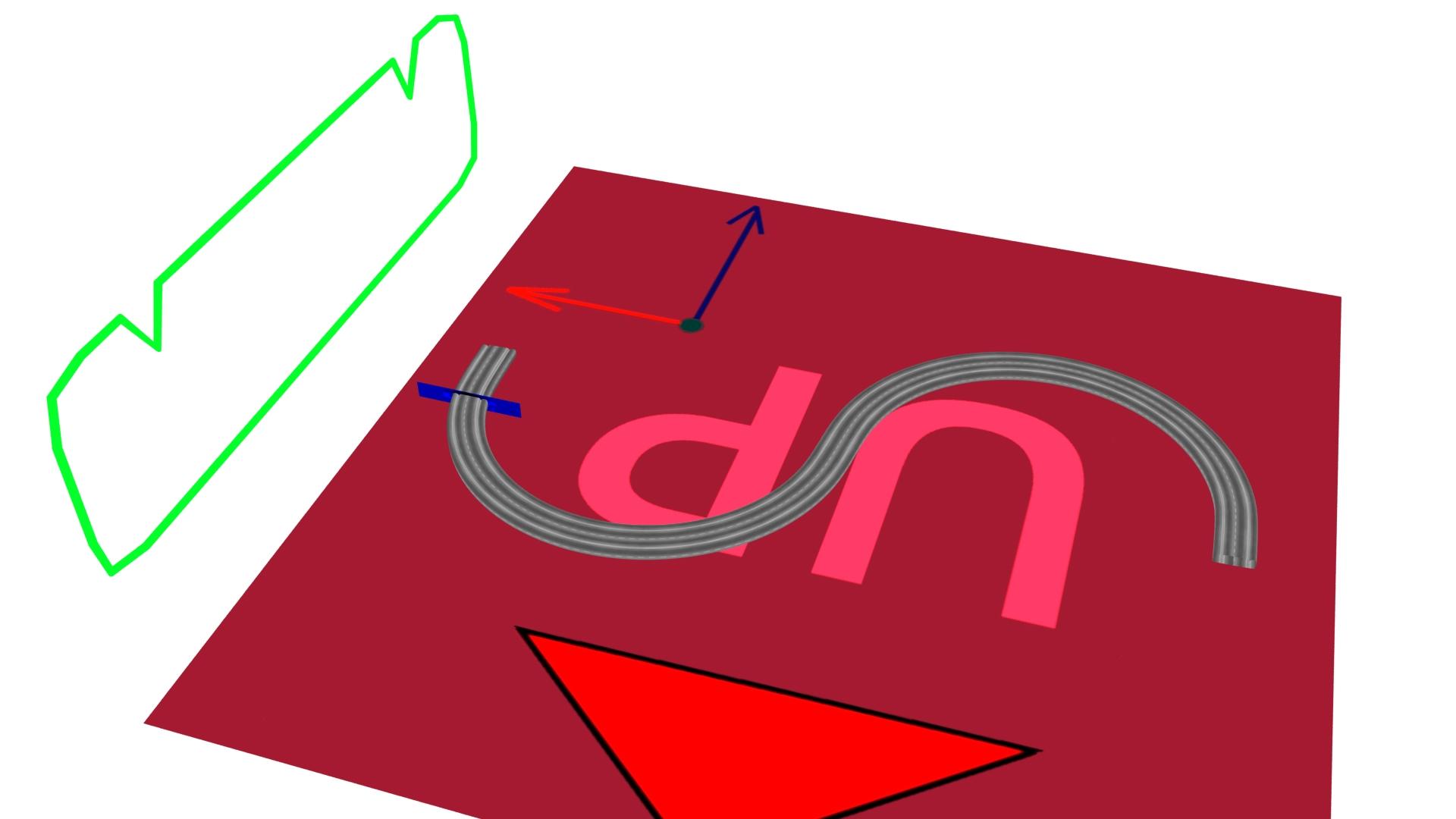

note that mcjTransport was recently used to make shoe straps shown here
in green you can see a shaped tube created using an animated null and mcjTransport
it was saved as a shape file
which was then used to create the S-shaped road - the blue rectangle is the animated object that gives us the S-Path
and mcjTransport builds the road around that
