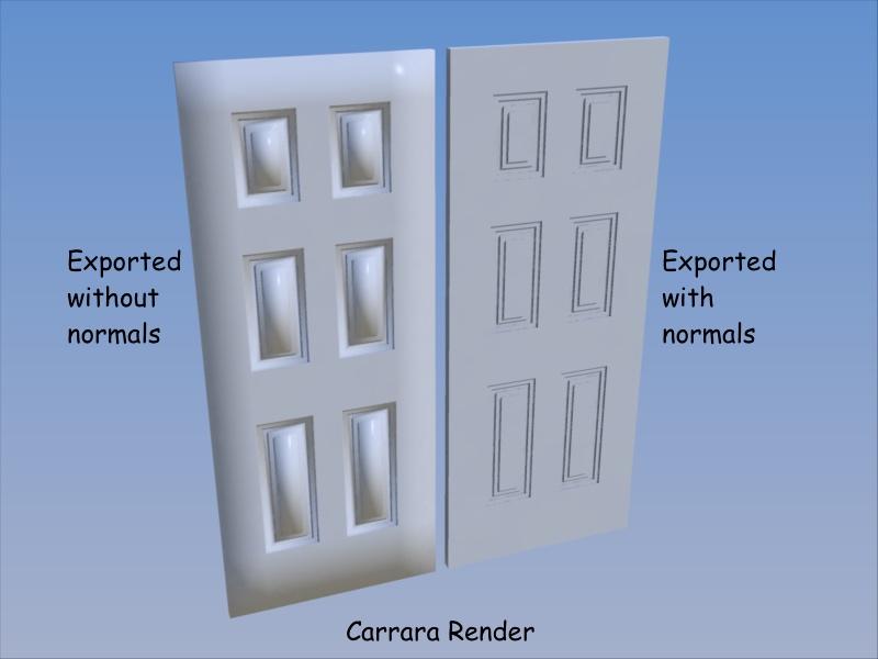

I'm modeling a six-panel door with a three-tier casing. The casing looks fine, but there are weird shadows on the door. The UV map in the right panel doesn't show any odd geometry. (I rotated the door's horizontal panels to vertical, so a wood grain texture and/or bump will run along their length.) The odd shadows don't show up when I render it in DAZ with a wood grain finish, but they do if I use a painted finish. You can see the oddness in the right-most top-to-bottom panel, in the off-white painted pic.
I've read about Hexagon sometimes generating odd normals. Is that the problem here? If so, can I fix that or do I need to start over?
Thanks for your help. smiley

    The weird shadows were there before I did the UV map. I followed these steps to create the door:
    1) Created a Cube primitive with the door's dimensions.
    2) Tessellated by Slice to create the left and right vertical 'beams'.
    3) Deleted the three top and three bottom faces, and used Close to create single top and bottom faces. (This is when the wierd shadows appeared.)
    4) Turned on Z-symmetry, so further changes would apply front-and-back.
    5) Surface Tessellated to create the horizontal 'beams' (top, eye-level, knob-level, bottom).
    6) Surface Tessellated to create the center vertical 'beams'. At this point the 'beams' defined six rectangular panels.
    7) Selected the upper-left panel, used Fast Extrude to create a new face, and adjusted it so it was inset 1cm on each side and depressed 1cm into the door.
    8) Selected that new face, used Fast Extrude again, and adjusted that new face so it was inset 3cm on each side and at the same depth as before (1cm into door).
    9) Selected that new face, used Fast Extrude again, and adjusted that new face so it was inset 3cm on each side and halfway back to the primary door surface (0.5cm into door).
    10) Selected that new face, used Fast Extrude again, and pulled the new face out even with the primary door surface.
    11) Repeated steps 7-11 for the upper-right, mid-left, mid-right, lower-left, and lower-right panels.
    12) Turned Symmetry off.
    The weird shadows had grown weirder at each step since #3. I thought I might find some irregularity when I went to UV mapping:
    13) Shift-selected the top, bottom, left, and right lines around the front and back surfaces of the door, and the lines where the left, front, right, and bottom edges meet.
    14) Went to UV Mapping, selected Manual Unfold, added my selected lines as seams, then clicked Unfold and Validate.
    15) That gave me six sets of faces: the front, back, left, right, top, and bottom.
    16) Rotated each set so its long edges were vertical on the UV map, and repositioned each so the UV layout made visual sense, from left to right on the UV map: left edge, front face, top and bottom edges, back face, right edge.
    17) Rescaled them up to (almost) fill the UV map space, so I could see the details.
    18) Selected each horizontal front and back face, used Dissociate UV, and rotated the face to vertical (on the UV map) so a texture and/or bump would run lengthwise.
    The UV map hadn't revealed any odd points, lines, or faces, so I saved it as a jpeg and defined my Shading Domains and Materials:
    19) Selected the front faces, created a new Shading Domain, renamed it DoorAway, renamed its material DoorAway, and set the color to dark brown.
    20) Selected the back faces, created a new Shading Domain, renamed it DoorTo, renamed its material DoorTo, and set the color to medium brown.
    21) Selected the Unassigned Faces (the edges), created a new Shading Domain, renamed it DoorEdges, renamed its material DoorEdges, and set it to light brown.
    As I said, the weird shadows began at step 3, when I deleted the three top and three bottom faces (made when I used Tessellate Slice to create the left and right 'beams') and use Close to create single top and bottom faces.
    Does the Close tool skew normals? Should I have just left the three top and three bottom faces as they were?

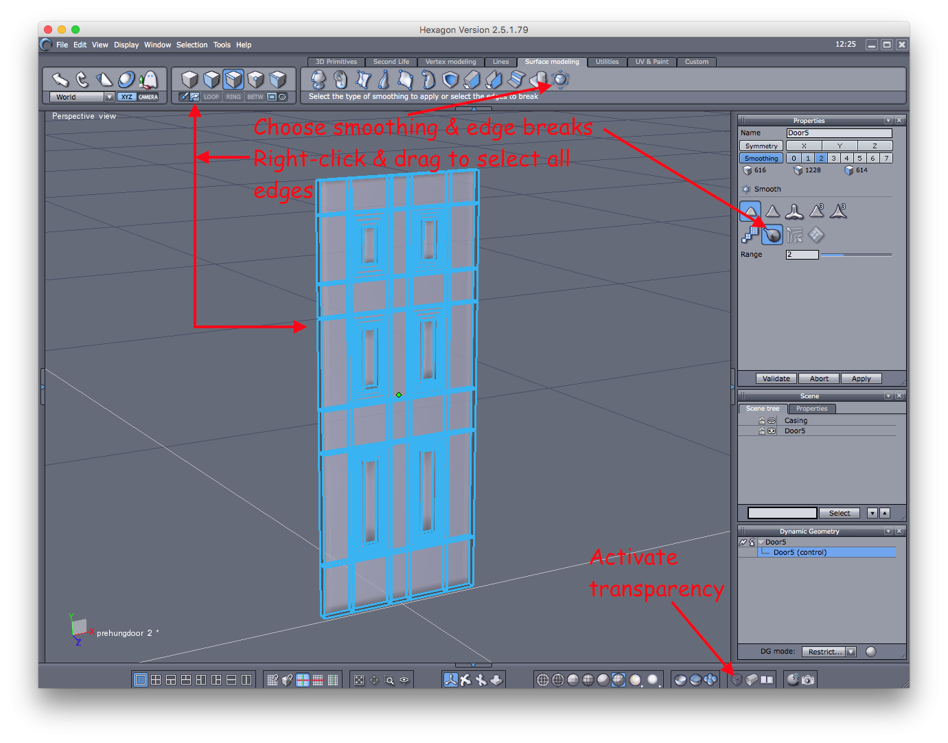

  • When you are using symmetry, you have not taken the face too far back have you? So the front and back penetrate. I think that would cause problems
  • CrissieBCrissieB Posts: 183
    Nope, I was careful to avoid the front-to-back penetration. I tried the Extrude tool and had the same outcome. Again, Hexagon doesn't find any N-gons, but the surfaces around the panels are clearly flawed. I. Am. Stuck.

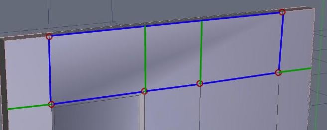

    Look at the number of vertices on this part...the red circles.  And the edges joining them...blue lines. That top panel is actually a hexagon...not a tri/quad.
    This is automatically going to create n-gons.
    Minimally, you will need to do this...green lines.
    The days of modelling to just the minimum number of faces as opposed to the smallest number of faces to get the job done are long past.  Don't worry too much about keeping the face count to some very low number.  A panel door, without the inserts should be a couple of hundred faces...at least 100 on each side.
