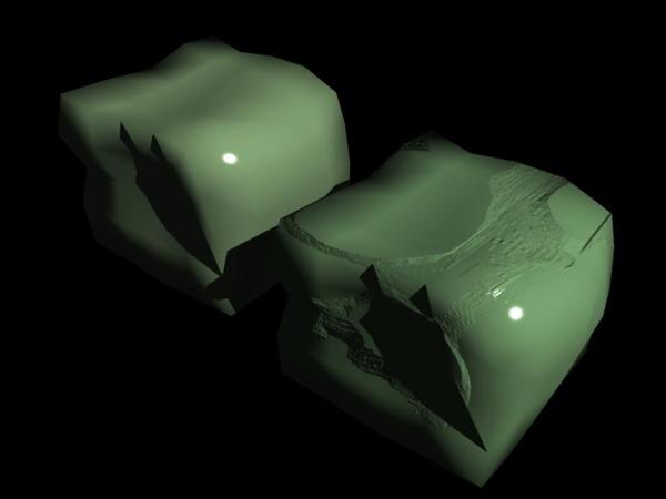

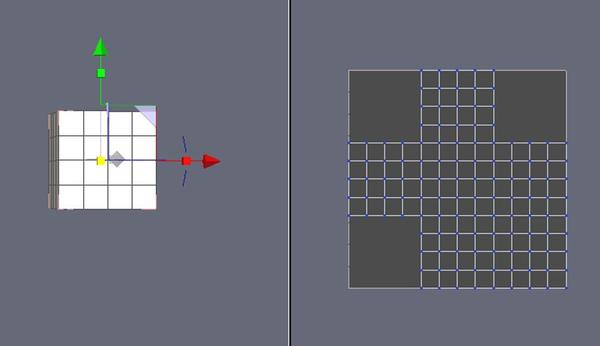

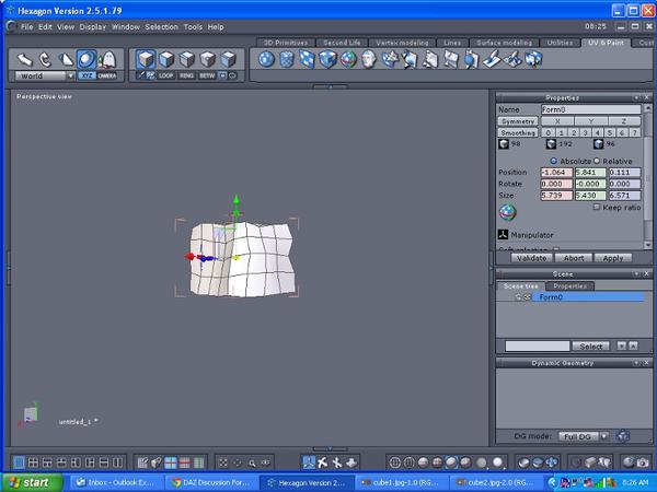

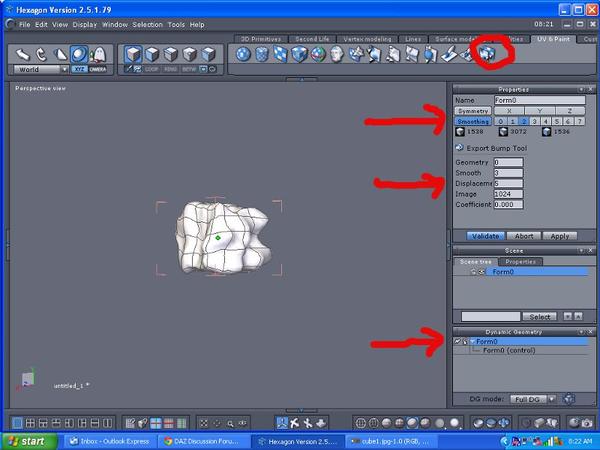

    Here's a quick and nasty example to illustrate the steps - hopefully the pics are in the right order:)
    1. Put in a cube and tessellate three times to give it some polys to work on. UV map it - very important - so that none of the faces are overlapping.
    2. Took it up to level 2 smoothing, with DG active and gave it a good going-over with the displacement tool to get it really roughed up.
    3. Exported the bump map
    4. Dropped the smoothing to 0 and collapsed DG. Exported as .obj.
    5. The bumpmap it generates, with contrast and brightness enhanced in Gimp to over-exaggerate it for demo purposes.
    6. The render in Carrara - the same cube, one with bump applied - both have 96 polys.
    The bump map can be used in the displacement channel or converted to a normal map.

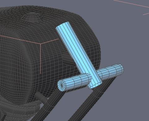

  • RoygeeRoygee Posts: 2,247
    edited September 2012
    Exactly what we were saying above
    Converting to normal map, you can get some extra artificial detail. I'm thinking here of a brick wall. With a bump map, you get good detail on the face, but the corners show a sharp edge. With it converted to normal, you can get the effect of the bricks at the corner appear to be separated by mortar - not much of a difference, but maybe enough to be more believable.
    800 x 600 - 85K

    Hi Roygee, how do you export the bump map? I can't see an option under file export...sorry just found it on the uv and paint tab.
    Post edited by Pendraia on
    Hi Pendraia
    This I've only mentioned as a curiosity - it really isn't much good and I've never found a useful application for it. Blender does this function far better and if you can understand the highly technical UI and poorly translated Spanish instructions, X-Normal is really good.:)

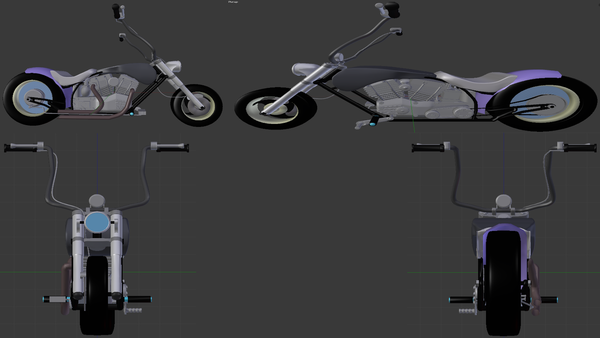

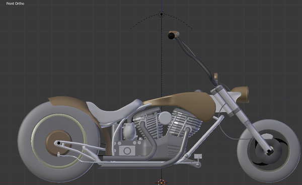

    I am currently working on the custom chopper and the modelling is complete, image attached.
    I find myself somewhat back at the start this model would be the high poly version, verts 159856, faces 157064.
    I have tested the model as is without textures in daz with no issues loading the model.
    If I wish to sell this model what level of detail should the finished model be?
    Are there any guidlines on levels of detail for submission as a new vendor?
    1600 x 900 - 413K

    If you have Z-Brush, that is all you need - wish I could afford it:)
    Blender - well...yeah. Whenever I'm feeling brave I dust it off and have a go. Slowly getting to grips with it - I can at least now do a reasonable retopo.
    What is this B2M of which you speak? Googled it and got nothing that had any connection to CG.
    Hopefully one of the PA's will help you out as to requirements for selling through Daz. May be better to ask Daz directly for guidance.

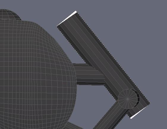

    A update on the custom chopper can be found here http://www.daz3d.com/forums/discussion/10208/
    I wish to state sorry for my post here in the hexagon section, but there does not seem a better place to get the advice and help that I need.
    My biggest issue at present is currently when I export my model no matter were I place the point of origin, The point of origin always comes in at the daz scene origin.
    My issue is this, I want to rotate the front handle bars with the wheel to represent turning, but I need the wheel to rotate around to show it spinning.
    Advice and help needed to do this, correctly.
    most likely I will have the same issue with the rear wheel but without the need of the turn function.
    your time and help is most welcome.
    Firstly, any application will place the pivot point - or hot point - in the centre of the bounding box, regardless of where you may have changed it to in the modelling app - that is the nature of the beast.
    Daz Studio handles objects very simplistically - it reads it as a single entity. To get the handle bars, with wheels etc. turned, you'd have to do some pretty sophisticated rigging. I doubt very much that Studio has a spin function - although there may be a plugin I don't know about - there are so many:)
    Carrara, for instance, gives you the option when importing, to import as a single entity or as groups. You would then group the front wheel assembly, set the pivot point to where the forks meet the frame and pivot the handle bars- this is not possible in Studio. Carrara also has a spin modifier to get the wheels turning.
    If this is for a still shot, you should pose the handle gars turned in your modelling app - pretty simple to do in Hex. If it is for animation, you would need to rig it. About the only way to simulate wheels spinning in Studio would be to make a circular plane with a spin blur texture on it.
    Just curious - Blender has everything you need to do what you want - why not use it?

    JEEEZZZ!!!! SEVENTEEN FREAGING MEGS??????????
    Your "level of detail" is INSANE!!!! It crashed my Poser Pro!!!
    BTW and FWIW, it may be of use to know that OBJ files are text files. What that means is that you can ZIP/RAR them and make files MUCH smaller than the actual OBJ files are. You'll see what I mean when I return them to you as RAR files.
    Okay, now that I've got that off my chest, we can move forward. :)
    There's a few problems I've encountered with your model with respect to certain elements not being zero'd with the Z-axis.
    For instance, your bike frame is zeroed, but the head tube was not, and neither was the bar the head tube is attached to. These 2 items are shown in my first image. I zeroed them both for you.
    Also, from the standpoint of physics, there was another "problem" on the head tube. As shown in my second pic, the ends of the tube were not square-cut to the head tube. In the "real world", this would cause problems with shaft rotation, so I realigned the ends for you as well.
    These 2 problems were the only 2 on the frame, but there are many more I found on the fork and that will take me awhile to adjust and document for you. But the good news is that I've already made some cursory checks, and I can tell you that the problem is 100% soluble.
    When I'm finished, will I be able to upload my RAR file to you on that website?
