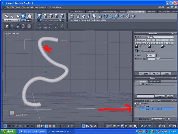

    DG stands for Dynamic Geometry - basically a history of the construction of an object. By default, Hex runs in restricted DG mode - you can see where this is in my pic - after creating the shape, I can still change it by moving points on the yellow curve.
    In this mode, once I hit "validate" or the enter key to confirm the shape, DG collapses and I can then only change the shape through normal modelling tools.
    In full DG mode, I can go back to any point in the creation of the shape to change something. Full DG mode is not recommended or needed in normal modelling, but can come in handy at times. When you export an object, you need to be sure that DG is collapsed, otherwise it causes problems.
    Back to your problem - I need to see the shape of the object to be able to help you choose the best method of altering it. Sounds like it would be easier to redo it. A simple way of doing this is to extract a curve - select an edge running the length of your shape, hit "loop", go to the menu bar lines->extract curve. Hide the original shape, alter the shape of the new curve to suit and give that thickness. If this works out, delete the original.
    Don't forget to validate and be sure DG is collapsed before exporting:)

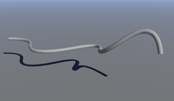

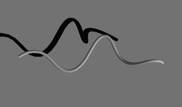

    I can't stay on long at this time, my DSL service is being moved, but here are two images of my shape. One side and one top view.

  • RoygeeRoygee Posts: 2,242
    Yes, I'd say that the method in my second post would work in this situation.
    If you need to test whether this will fit what you are doing in Bryce, what you could do is enable full DG, do the new shape as explained without collapsing DG. Make a copy of of that, collapse the DG on the copy (hit the lightning bolt in the DG tray). Hide the original and export the copy. You can save the Hex file with DG active, so can come back and re-shape if needed.

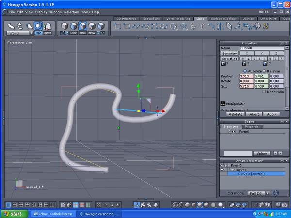

    OK, in full DG mode, make your curve, give it thickness and validate. Select control curve in the DG panel, select a point or line sector on the yellow control curve and move it around - the shape follows. You can add extra control points if needed by selecting a curve sector and going lines-> tessellate.

    I followed your instruction and nothing happened. I selected the axis points where the control curve lines met but nothing moved when I held down the LB and drug my mouse. However...
    I played around with things a bit and finally did get the thickened line repositioned, but there were a few more steps involved. I also rearranged the Scene/Material/DG/Properties windows and saw that Validate/Abort/Apply was indeed on the Properties window. How the other windows were positioned made it seem they were on the DG window. I'll have to read up on customizing the screen in the user's manual to get a better idea on how to arrange these windows better. I need a real good book on Hexagon, or Bryce, or Blender, etc. Always do need a book with these type programs.
    Anyway, back to however.
    What I discovered, thanks to you, is that before I can reposition a line segment by using points on the line, Select Points (F4) has to be selected. Once that's done then the corrector manipulator has to be chosen, at least that's what it seems has to happen. (BTW, in your example the XYZ movement tool(?) is displayed, but I can't seem to find how to display it while working to reposition the line.) Then I can reposition whichever segment I've chosen.
    Next, to Line Tessellate, the Select Edges (F3) has to be chosen. Then I found I can go to Tools > Lines > Line Tessellate or, open the Lines tab at the top and chose the icon for Line Tessellate. Pretty sharp. When I click on Line Tessellate the control curve line will snap to the line, which then adds another point, which I can then move. Again, pretty sharp. I then have to switch back to Select Points (F4), have the correct manipulator tool selected, and then that segment can be moved.
