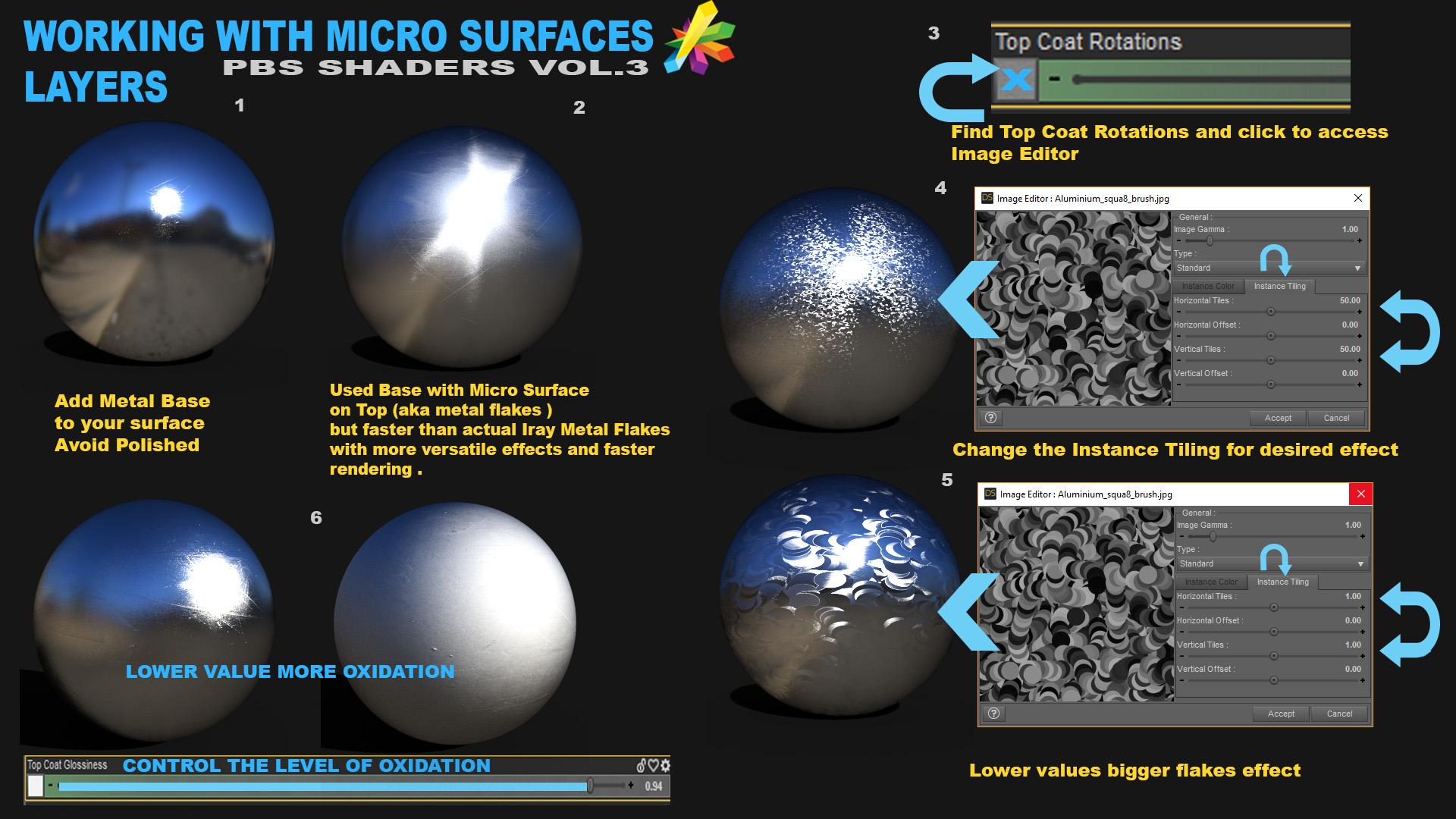

    when you start playing with them and want to go with the micro surfaces choice the Used metal, Dirty, Scratched or Stained , avoid polished mix with micro surfaces  for that reason they are polished  and wil not works mixed with another layer , if you want to use bump map or normal map from the old sword, just change the Tile to 1 x 1 and load the bump or normal maps , if the micro surface have to small or too big detail then you can scale it up or down with Image editor under Rotation in Top Coat that will not affect the original bump or normal map from the original obj
    I'm not sure to understand this and I think is important. Would you mind explaining it a lil more?

    Jerife said:

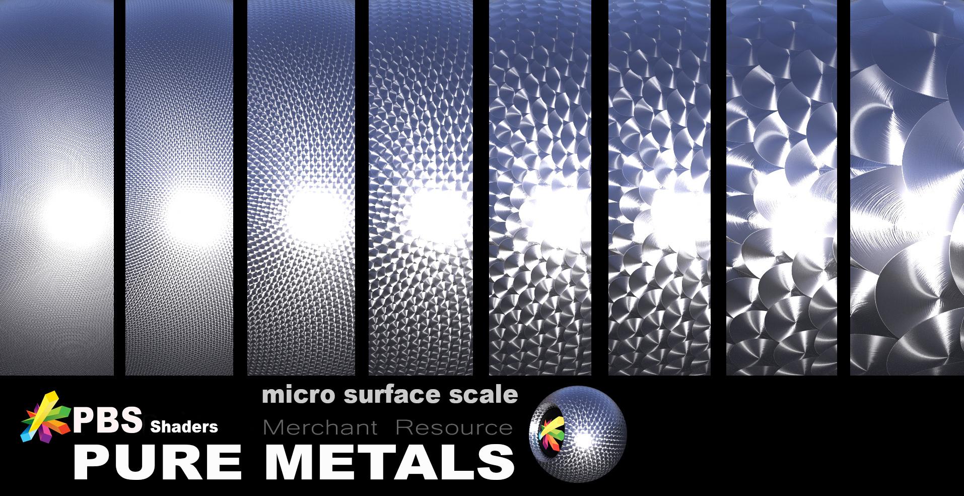

    Here is a simple workflow to edit the scale of micro surfaces layer in vol.3 shaders only
    the scale will be independent of the main tiling scale so affecting only the micro surface , this way you can use your own normal or bump map for your model and keep the original UVs scale to 1x1
    some of the micro surfaces like brushed one use also Normal map under Top Coat so pay attention when scaling the details to keep the same values for both Rotation and Normal or Bump, everything outside TOP Coat layer don't need to be adjusted as we just adjust top layer leaving the rest separate and independent.
    Micro reflection surface layers as the same as metal flakes in iray but render much faster with a lot more versatility in adjusting and form  than just metal flakes  that can pretty well slow down your rendering time
    click on image for simple instruction
    1920 x 1080 - 540K

  • JerifeJerife Posts: 272
    WOW!  Excellent lesson, thanks. Will study it tomorrow. bed time here.

    Jerife I hope it will be much easier now to follow the directions
    edited May 2016
    Yes Cath, thanks and understood. I hadn't seen Image Editor before...

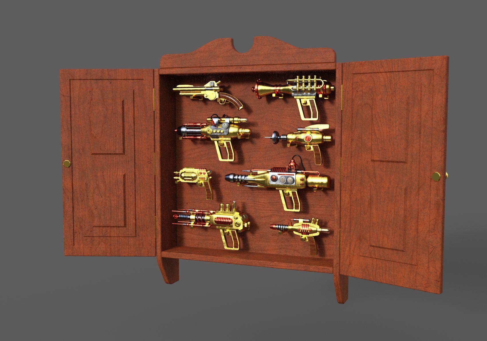

    edited May 2016
    Finally got round to installing shader sets 2 and 3 tonight. I've been converting a lot of Poser stuff to proper D|S-format files lately, and my latest conversion was an ideal test. Default lighting, all textures replaced apart from the wood handles and cabinet, and the gauge dials. I think I like it.
    1700 x 1190 - 181K
    Post edited by SpottedKitty on
  • MEC4DMEC4D Posts: 5,249
    Thanks ! that is funny like old style cabinet with futuristic weapons , there is a definitelly a super agent spy behind that concept cheeky
    and the best of that,  you can always change the look you want , I alway save my new material presets for objects so I can reuse after without starting from the begining each time
    I hope you have much fun working with
