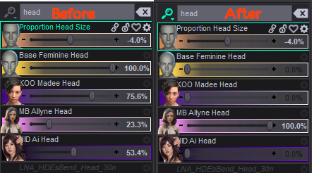

    When I right-click on Upper Body/Full Body and choose Reset, it also resets the face back to the default Genesis base figure by zeroing out all face/head shape morphs. Tested on G8 male and female with the same results. Haven't tried G9. Running V4.23.

     Expressions are what I'd expect to be reset, but character face shapes should remain the same, shouldn't they? It doesn't reset the body character shapes, only the head.
    I want the head to reset its pose, but I'd rather it keep the actual character's face. I start with a character - Holt8, for example- but when I reset the upper body, his face is gone; just the default G8M face remains. Holt8 Head slider is zeroed out.

    Shaping should not be touched at all. You discovered a bug, I was just able to replicate this. Merely loading a character does not do it, needs to have other dials changed on top and only those will get reset. Will fix ASAP.

    Ok, that makes sense. I didn't load a preset character- I used G8 Base and just modified it with a few dials when I was testing. Body shape dials weren't affected, just the head, as far as I could tell.
