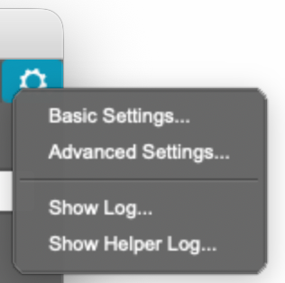

  • TotteTotte Posts: 15,214
    edited August 23
    etaktrash_d29ae59121 said:
    Totte said:
    I've been running DS 6 since first betas on my three machines; M1Max. M4Max and M5 and everything works, and has been running all different 4 and 6 build channels in parallel.
    So, First, check your DIM settings that you have the new Studio enabled in it.
    If DIM Says a packagesize is -1, remove the package from the downkload folder and download again, internet issues can cause things like that.
    The website works here so either that was a temporary issue or some strange issues related to your ISP or internet connection.
    The postgres issue is usually related to either configurations, where does DS 6 think the CMS is installed, but there are some other things that can trigger the problem, like there is no Connect Library found.
    I tried all that before posting here. I've uninstalled and reinstalled and deleted and re-downloaded until I'm cross-eyed. Every time I launch DIM it tries to install Studio 6 and CMS, and every time it fails. I've posted on these forums about it before, but no one ever seems to have any idea why.
    The website works on my other devices. Just not my desktop, which has identical settings to my laptop, where it works. I've given up trying to figure out why. Just like I've given up on Studio 6. CMS started working again, probably for the same mysterious reason it stopped in the first place. So I'll stick with 4.24--until the next inexplicable issue breaks it, anyway.
    What macOS version, and what does the DIM log says?
    You see the logs here:
    316 x 314 - 73K
