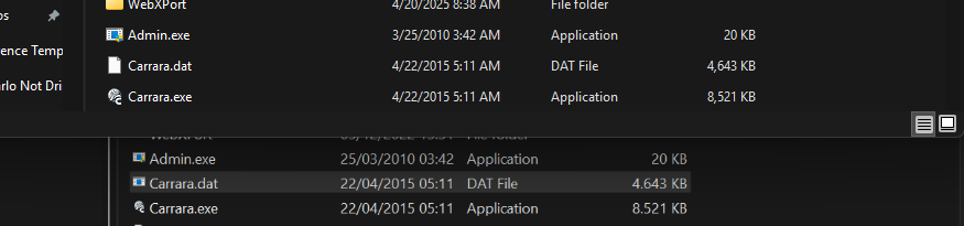

  • RuudLRuudL Posts: 227
    edited April 2025
    Please check whether a Carrara.dat file is present in the Carrara8.5 folder ( parent folder of the Extensions folder )  It contains metadata for mcx files. Check its size and properties.

  • DiomedeDiomede Posts: 15,468
    edited April 2025
    Thanks, RuudL.
    I am running 64bit Windows 11 Pro, version 24H2, OS build 26100.3775 installed on 2/14/2025
    My dat file matches yours.  I attach a screenshot.  My files are in the top half and your screenshot is the lower half.
