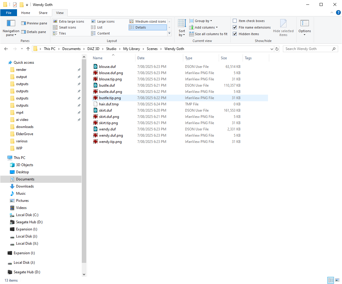

  • WendyLuvsCatzWendyLuvsCatz Posts: 41,799
    oh I found a chonker in the new Outlet additions
    https://www.daz3d.com/mrl-dforce-long-morphing-hair-for-genesis-8-females
    I don't think it was particulary slow to simulate or render
    but
    saving the scene took over 2 hours
    trying again just the hair as a scene subset and still waiting...

    How large is the scene files?

    whole scene 17.1GB I kid you not
    still trying to save the hair by itself
    the rest as you can see not big
    I will point out it is a 360 frame animation, those files are big but not THAT big, my biggest to date was 5.63GB, most are under 1GB (only 3 out of 1318 scenes so far on this PC over 1GB and that includes big sets etc)
    update, hair sim animation alone finally saved 16.8GB

  • 285,793 vertices - each of which has a psotion stored at each key frame after simulation. That is a lot of data.
    strangely it's rendering quite fast, am trying to render a few different camera angles as unsure if I can load it again considering the size of the file
    I did apply the new omnihair shader
    It isn't  strand-based, is it? Looks like polygon/dForce cloth hair.
    it's strandbased but I think applying the omnishader preset I saved destroyed the simulation
    (yes checked, simulation is ticked by default saving a shader crying)
    still a huge save though

  • HavosHavos Posts: 5,707
    When the hair loads it has a tesselation sides setting of 3, so will not be using iray curves. If you set this to 0, will it help?
