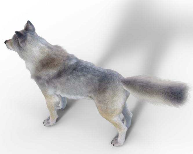

    I must say this Omni shader is great. It makes my renders of Fur more natural than Dual Lobe, though some properties on the Shader seem pretty tricky while tweaking them...
    1824 x 1216 - 3M

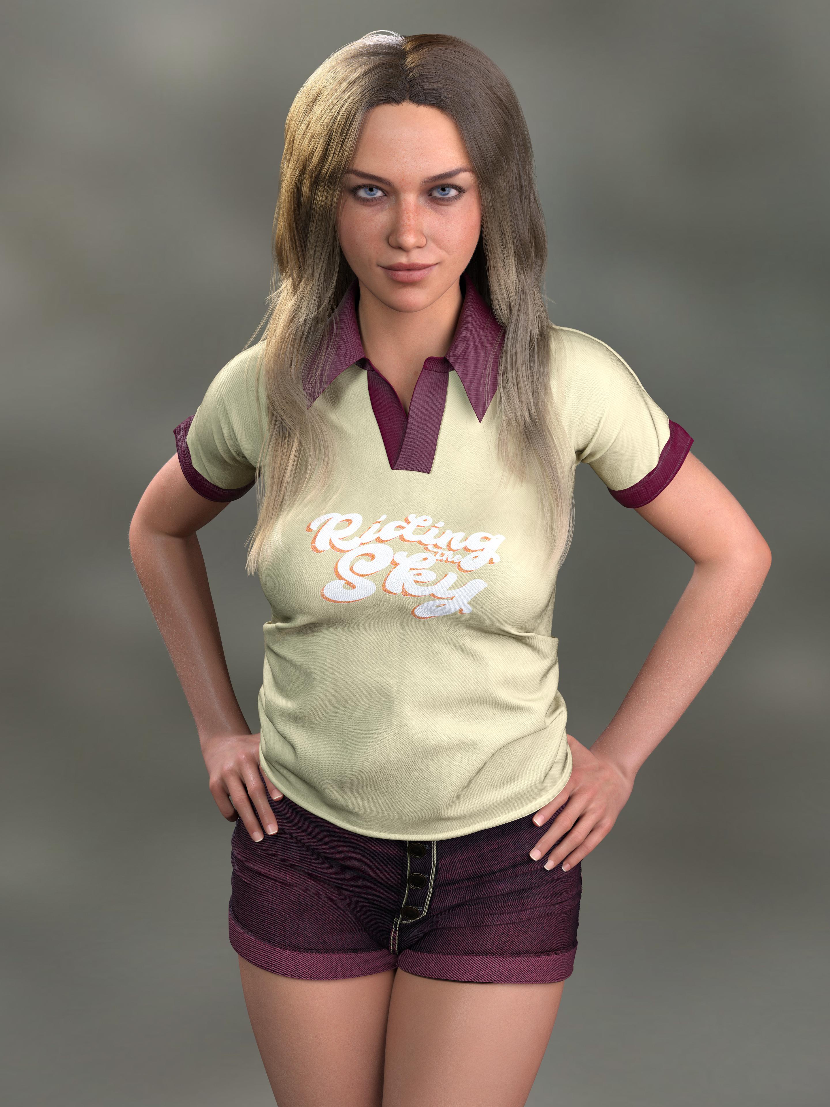

    This also works well on clothing that has fur, like coats or liners on a dress. I used OmniHair shaders on the Christmas Dress to give it more color options! The left image is the original material OOB and the next two are the Revolution - Omni Shader Presets applied to the Christmas Dress Fur.
    fur shaders on dress
    6144 x 1754 - 2M
    Post edited by Shimrian on

    Yeah, that looks pretty nice ! yes

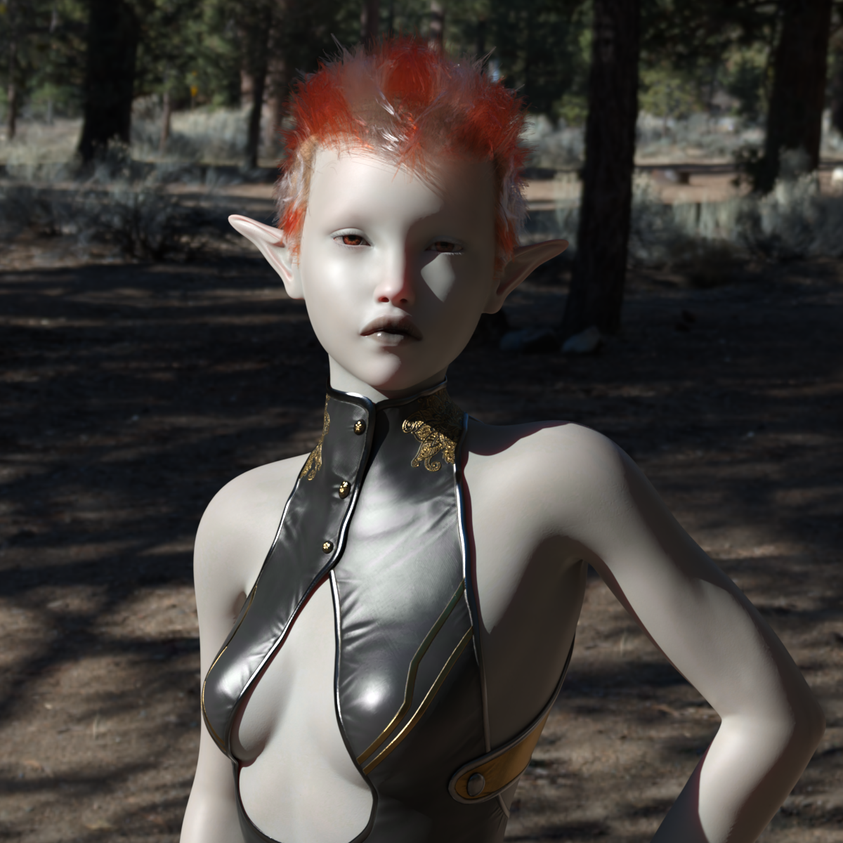

    Yes, the Snow White hair preset now works without an error message.
    Note the yeti's natural camouflage with his snowy mountain.
    2000 x 2600 - 2M

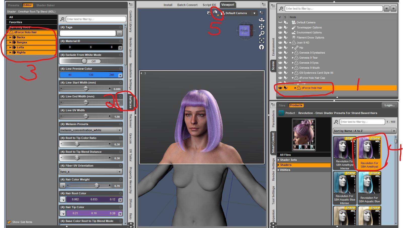

    @bicc39 Here is a step by step illustration that might help.
    1. Load the strand-based hair like Halo Hair into the scene and select the dForce hair object (not cap) in the scene. (I believe you have already done that successfully.)
    2. Open the Surfaces pane. (My pane layout is customized, so your layout will probably differ from the illustration.)
    3. Select all of the surfaces of the dForce hair
    4. Apply one of the Revolution hair shader presets. Daz has lumped everything (base colors and tip colors) into the same category, so Smart Content is a bit of a jumble. It is easy to accidently select a tip color when intending to select a base color, The file names are clear, if you take time to read them, though.winkIt is sometimes easier to select in the Content Library than in the Smart Content.
    5. To see the results, turn on Iray Preview, or do a spot render, or do a full render of the scene.
    Oops - breast area is shown, but it is in grayscale, so hopefully TOS acceptable.
    1602 x 906 - 292K
    Post edited by barbult on

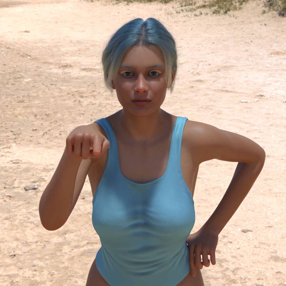

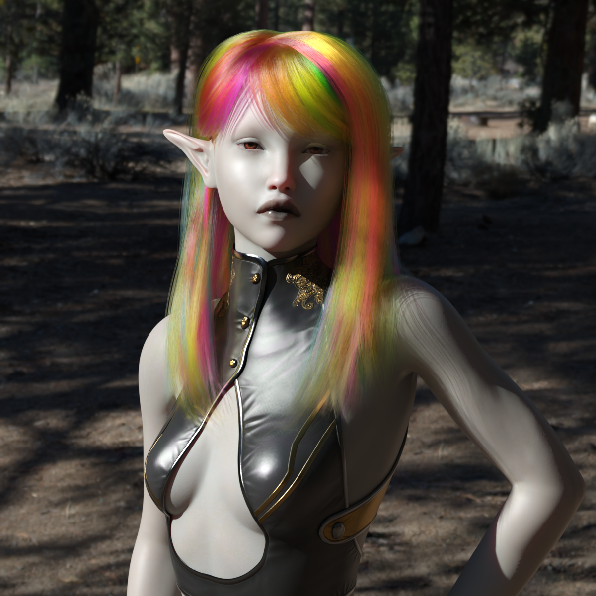

  • Hi,
    I've just bought the Revolution Omni shader, and ( I guess I do something wrong) I cannot have any colors when I use the presets. The hair remains grey, nothing changes with the ton of dials in the surface pan...
    My Daz version is 4.22.0.15
    I follow the procedure  (select dForce hair, not the cap, etc.)
    Here a rendering with Lexi Hair.
    Thanks for help,
    Phil
    1000 x 1000 - 412K
  • chevybabe25chevybabe25 Posts: 1,361
    edited March 2024
    Hello Phil.
    You need to install the latest version of daz studio and the newest version of the default resources.
    Post edited by chevybabe25 on
  • Thanks, it works now .
