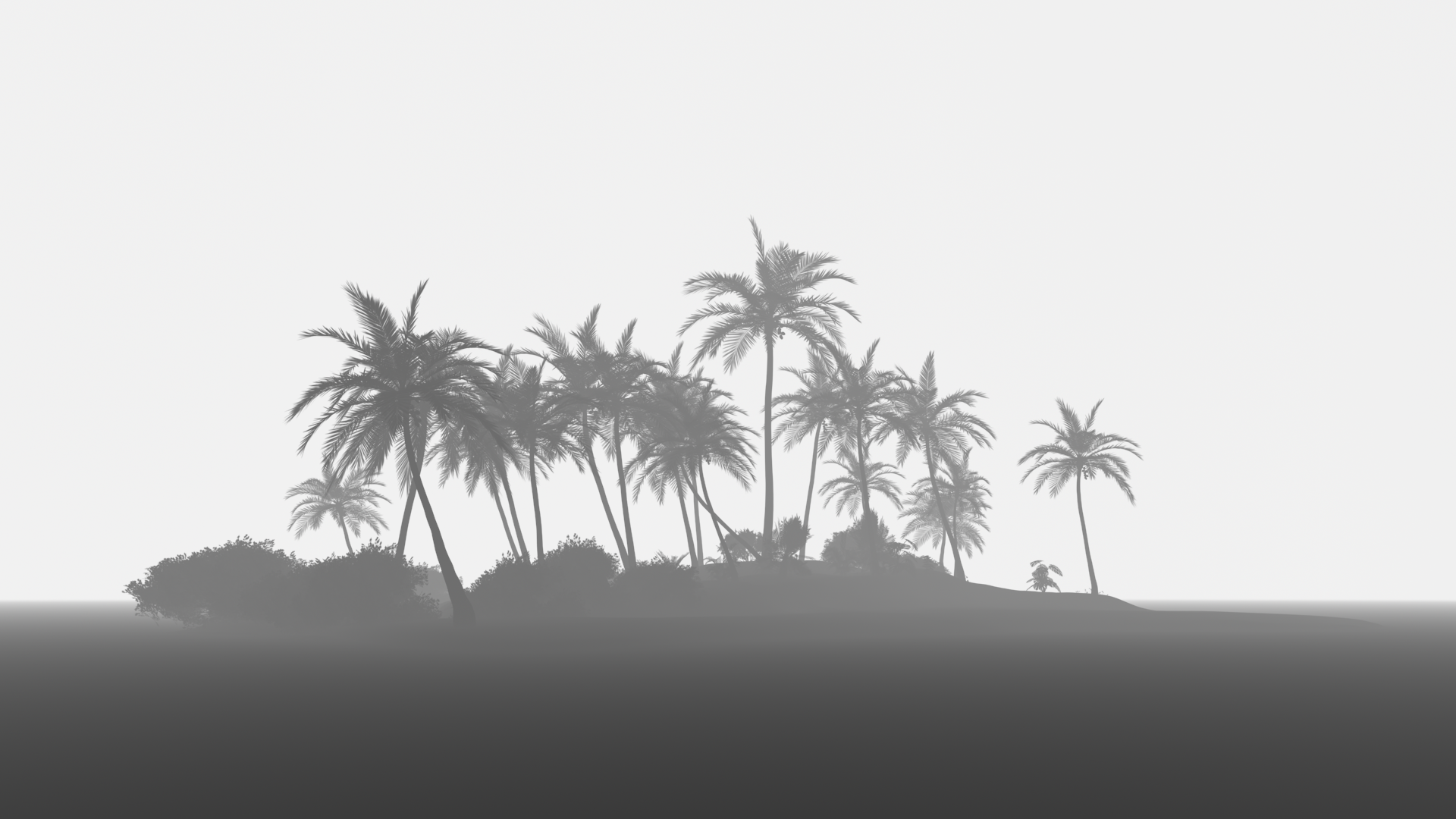

    So here's a scene with only transmapped vegetation, along with a couple of simple fog depthmaps of various visibility. The base render took a long time (couple of hours) as I knew it would, but the depth passes render in 1min 36sec. I also rendered out at UHD resolution, which took 5min45sec to complete.
    And no, I don't "have something" for 3DL, I just follow a strict linear workflow and things usually pan out oklaugh. But obviously 3DL is struggling with cutout opacity, compared to IRay, in terms of rendertimes.
    15000m visibility (used above)
    5000m
    1500m
    15000m Ultra
    The maps posted here are just 8b jpeg:s, I use 16b png: for final editing...

    So here's a scene with only transmapped vegetation, along with a couple of simple fog depthmaps of various visibility...And no, I don't "have something" for 3DL, I just follow a strict linear workflow and things usually pan out oklaugh. But obviously 3DL is struggling with cutout opacity, compared to IRay, in terms of rendertimes.
    I'd have to do some testing to confirm AoA Volume Camera's performance, but I can't complain about the quality of your results. I see no obvious 'leaf planes' so what you are doing might work for my backdrop billboard rendering. I think I've seen the camera on a third-party site that's listed as a 'Simple Fog Camera' so I'll test it out sometime. Thanks!
