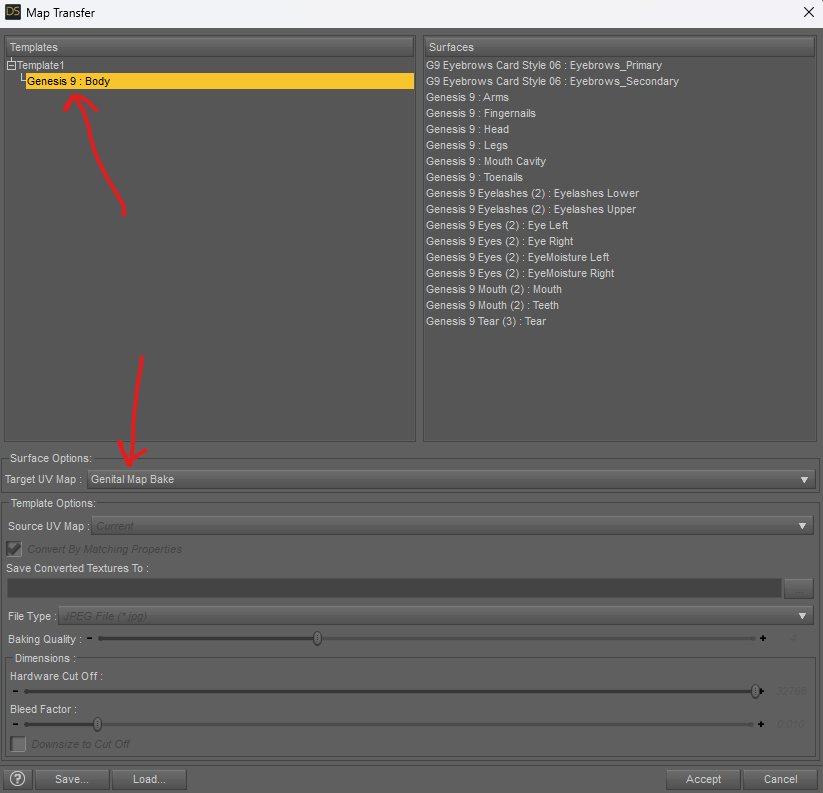

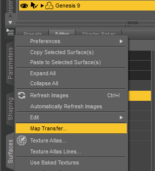

    You can use the custom UV map mentionned above, or, for female gens (does not create male anatomy) you can do this to create the maps - no extras required :
    1) Go in the Map Transfer utility from the surfaces tab
    2) Create a Template (right-click the templates section) and drag the Body from the right pane onto the new template and
    3) Pick Genital Map Bake
    4) Might vary, but for me the textures are output on %appdata%\DAZ 3D\Studio4\temp\textureConvert
    308 x 341 - 18K
    823 x 793 - 57K
