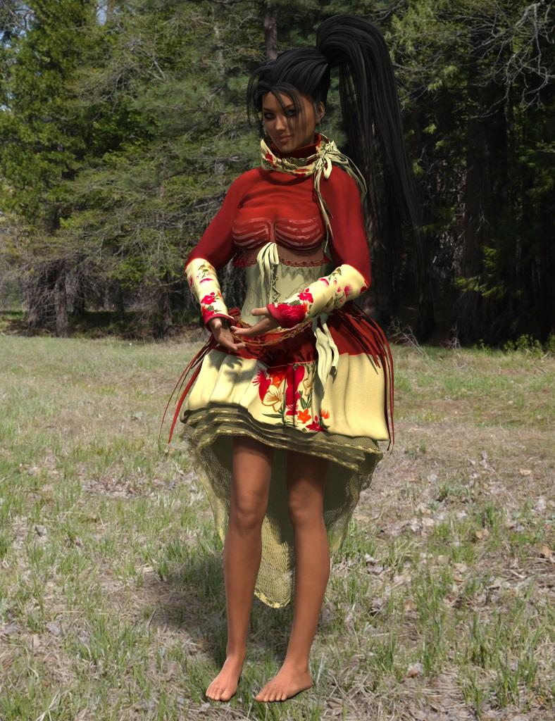

    Below is a 3Delight render of Victoria 7 wearing Zhaetheria Legend clothes for V4.
    788 x 1024 - 310K
    Post edited by Artini on

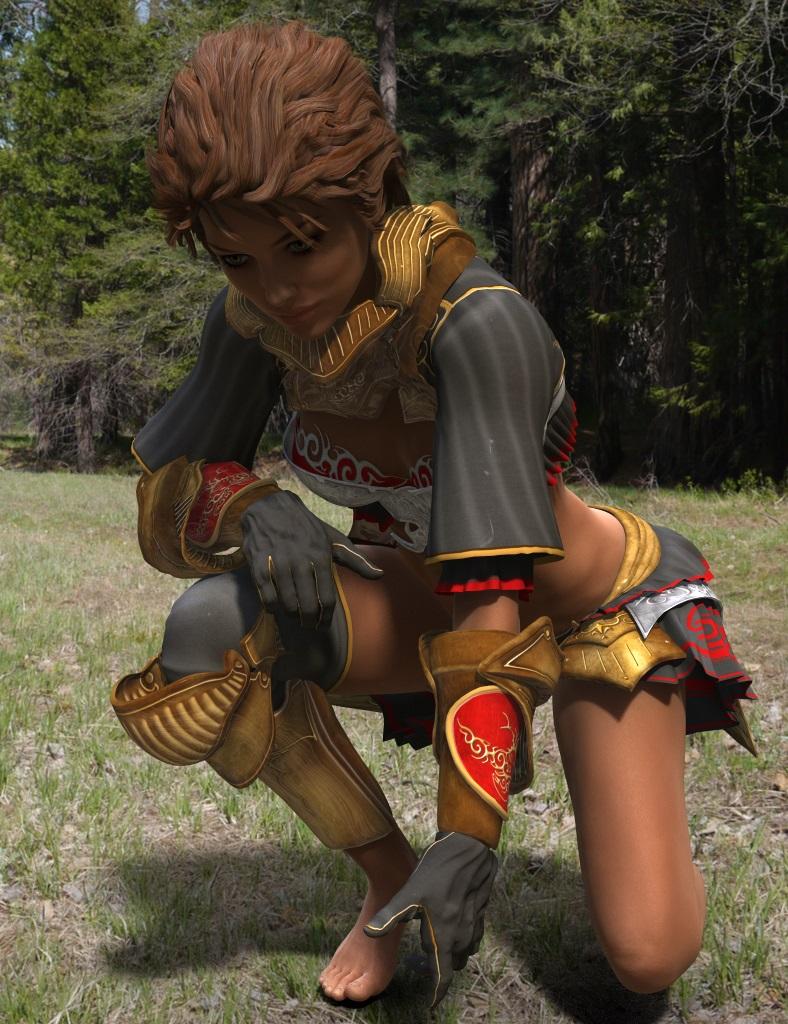

    Victoria 7 wearing another powerage's cloth set - Goth Fashion for V4.
    788 x 1024 - 353K
