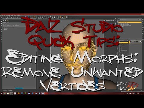

    Yes, and there's also another method which is shown in a video on YouTube
    https://youtu.be/XuQwnTd4Fok
    I have tried this some months ago, but it turned to a nightmare.
    The shape of G9 is very different from G8F, the figure is shorter and smaller and so when I clean the morph
    from the head, I get a really long giraffe neck, it's hillarius! cheeky

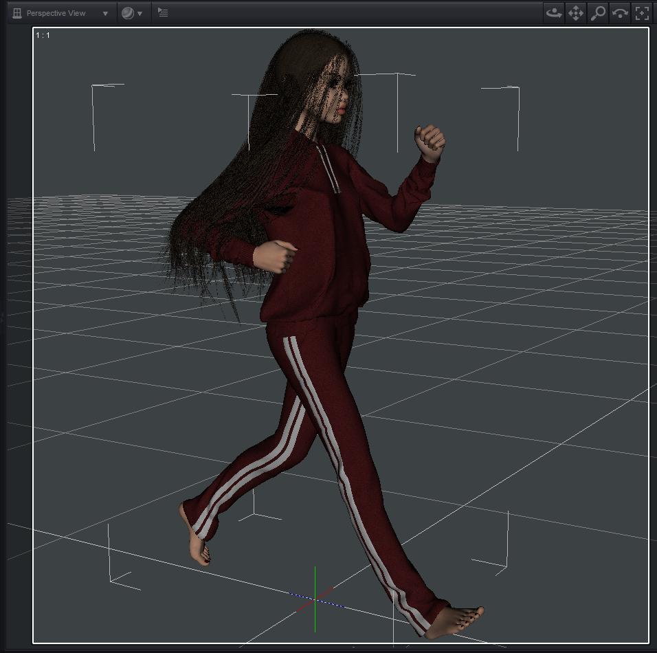

  • I finally decided to try your tutorial. I'm another of those "If I can do it anyone can" people, too. I don't have much G9 but have picked up most of the freebies, so I figured "Why not?" The base clothing autofits easily. The Dancing Queen that was free a few months ago and the Angie dForce top (from the set that is a "permanent resident" of the weekly freebies) also worked. I haven't tried simulating it yet. Unfortunately, the Angie jeans don't get anywhere near G8F's legs. I thought only the top was dForce but I might be wrong.
     If you are referring to: https://forum.daz3d.com/dforce-angie-cuffed-jeans-outfit-for-genesis-9
    Yes those jeans are intended for dForce. I haven't worked with them yet let alone tried to revert them to G8 so I don't know why [yet] they aren't anywhere near G8F's legs. I'll load them up and see what happens over here.
    edited December 2023

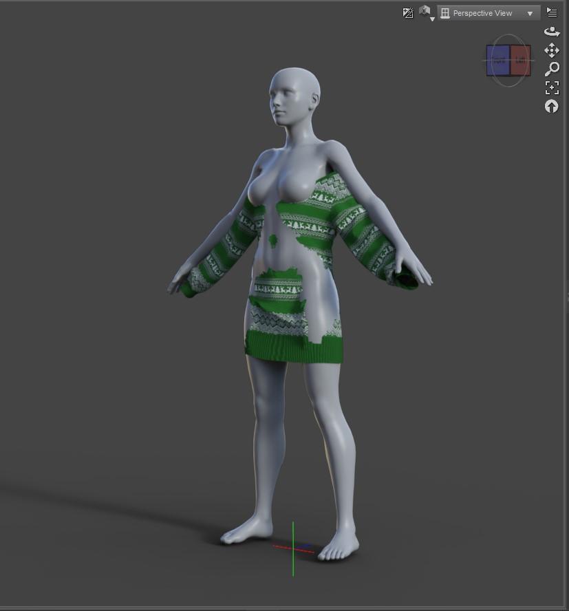

    Okay, [note to self, installing products aids greatly in being able to find and use them] ... I loaded the jeans. Then I loaded G9. The jeans were made to land perfectly on G9, good so far. Deleted G9 [loading G9 is not required to use the clones, I was just checking that the jean mesh was loading where it needs to be].
    So in scene had jeans, then loaded G8Female. Right-clicked on the jeans, asked for fit to G8F, from the dialog options, selected the clone 9 I had made, I did not select which type of garment it was. [Doing so shouldn't adversely affect anything but it does bring into play work by other people and I was wanting to check the clone.]  As the jeans appear to fit perfectly, the clone appears to be working fine.
    1585 x 1241 - 461K
    1554 x 1094 - 398K
