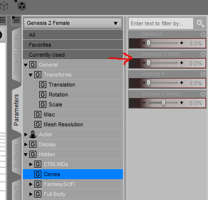

    Byrdie said:
    Okay, here's what happened when I tried making a V4 clone for G2M.
    1: Loaded up G2 female and dialed in the V4 body shape. Exported as base object.
    2: Loaded up G2 male then used Morph Transfer to load the object. Success, G2 male morphed to the V4 shape.
    3: Finally found the Property Hierarchy tab, clicked on the G2 Male & saw my V4 morph listed.
    4: Went to File/Save As/Support Asset/Morph Assets and saved the morph. Then back to Support Asset and attempted to save as a clone. Got an error popup box that said I needed to select two figures to make a clone.
    5: Loaded up a second G2M and tried again. Selected both the morphed and zeroed figures. This time it let me save a clone. Hooray! I named it CloneV4 and saved it to my library. Deleted the figures and loaded a fresh G2 male. Looked under Hidden in the parameters tab, all clones present and accounted for. Except the one I'd just made.
    6: Make sure new clone is in correct folder. Oops, it's in My Library and not My Daz 3D Library. Copy it, with Studio closed so I don't mess anything up there, into the right folder in the right library. I know it's the right one because that's where the other G2male clones live and Daz can find them every time.
    7: Open Studio, load G2Male in a new scene & check for a V4 clone. Nothing. The other clones all sit there, laughing at me.
    8: Lather, rinse, repeat. V4 clone still nowhere in sight. Other clones still laughing. Sadistic little wankers.
    9: Apply threats of serious digital harm accompanied by TOS-violating speech in several languages to stupid laughing clones and try again. Several times.
    10: Realize the insanity of expecting different results from doing the same thing over and over until exhausted and nearly dead of frustration then give up and go to bed. With a good book and chocolate. LOTS of chocolate, in an attempt to forget those @!!&&#&&!!! laughing clones. Tomorrow is another day.
    If only I could figure out exactly what went wrong I might be tempted to try again. Assuming I have plenty of caffeine, chocolate and tranquilizers. Not to mention industrial grade hearing protectors for all the neighbors so they don't complain about the noise. Not much I can do about the blistered paint on the barn, though. Sorry, Mom! :oops:

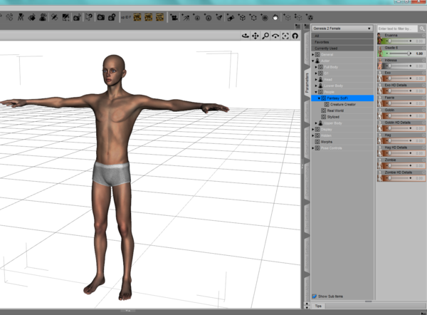

    In step 3 did you just look at the settings with the property hierarchy editor, or did you not amend the V4 morph to change it into a V4 clone? This is the steps I took to create a V4 clone for G2M.
    1) Loaded G2F, applied a V4 shape, changed to base resolution, exported as mesh. I exported as DAZ Studio scale. (Exactly the same as you). I called the exported obj G2FV4.
    2) Loaded G2M, selected it, and then selected Edit->Figure->Morph Loader Pro. Clicked on "Choose Morph Files", and then selected the G2FV4.obj I saved in 1) and ensured the import scale was also DAZ Studio.
    3) Now if you look in Parameters tab you should see a G2FV4 morph, and dialling it to V4 will morph G2M as V4, so far everything is as you did.
    4) Next step is the tricky bit. Select G2M, and then Window->Panes->Property Hierarchy. Genesis 2 Male should be seen in the editor, expand this, and then Parameters. I located my morph called G2FV4. I then clicked on this, hit the right mouse button, and a pop up box should appear, now select Parameters in the box.
    5) This pops up another small box. Next to "Type" you will see Modifier/Shape. Click on this and change to Modifier/Clone. Then press Accept and dismiss the Property Hierarchy Box. This is the step I think you missed.
    6) That is it really. I then dragged a V4 dress onto G2M and in the autofit pop up box I selected G2FV4 as the clone shape, and the dress fitted (I had to apply a smoothing modifier to fix some poke through). Below is the render I took. The dress is V4 Cheyenne.
    There is one last step, which I will detail in the next post.
    EDIT: Fixed some typos
    1425 x 879 - 316K
    Post edited by Havos on

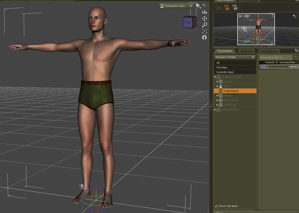

  • ByrdieByrdie Posts: 1,783
    Thank you, that works. I still do not see a new clone under the Hidden/Clones menu but when I run autofit... IT WORKS! A little bit of smoothing to fix some shoulder poke through now, doesn't he look just darling in Vicky's Goth Maid dress? :giggles:
    I have GenX2 and all the legacy shapes, time to go closet raiding. :coolsmile:
    531 x 631 - 52K

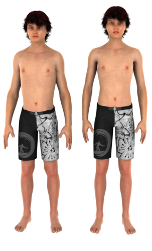

    For anyone who wants my Kenji 6:
    Genesis 2 Female(s) Morphs Bundle
    Genesis Generation X2
    GenX2 AddOn for Genesis 2
    Generation 5 Legacy Shapes for Genesis 2 Male(s)
    Shape Shift for Genesis 2 Female and V6
    DieTrying's 182 Morphs for Genesis 2 Female
    H3 & A3 Shapes for Genesis
    Hiro 5
    Keiko 6
    Keiko 6 Body = 0.50
    Andrygynous = 0.50
    Head Shape Cone = 50.0%
    Genesis 2 Male = 0.75
    Hiro 5 = 0.25
    (Hiro 5 Head = 0.25)
    (Hiro 5 Body = 0.25)
    Hiro 5 Lower Cheeky = -0.20
    Nose Tip Round = -0.25
    Nose Width = -0.25
    Face Young = 0.50
    Hiro 3 Head = 0.25
    Keiko 6 Head = 0.25
    Hip Bone Size = 0.25
    Thigh Thickness2 -0.50
    Shin Thickness = -0.30
    Nipples = 1.00
    Navel = 1.00
    600 x 800 - 200K
    Post edited by RCDeschene on

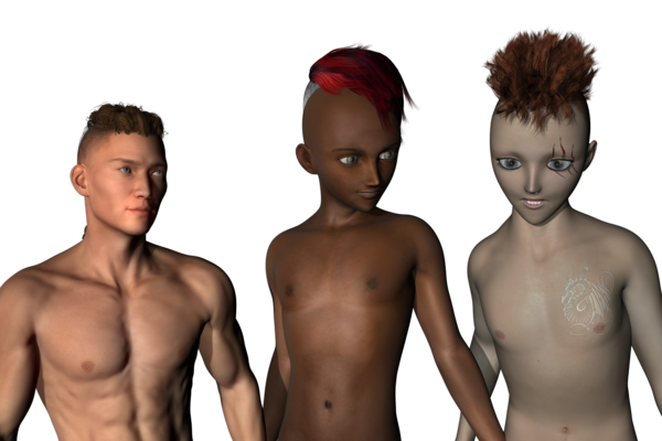

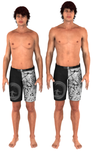

  • RCDescheneRCDeschene Posts: 2,817
    edited February 2015
    Can do!
    500 x 750 - 56K
  • HavosHavos Posts: 5,704
    Can do!
    Thanks for that. Kenji certainly seems to bend at the shoulders better than the males I created for G2F using a straight formular of G2M 1.0 and V6 1.0. Maybe it is because Kenji has some of the morph Andrygynous in him.
    I think this is the first time I've ever been a trendsetter, you've have even adopted the name.
    Seriously though it's great to see people expanding on my original concept. Mine was a very quick mock-up and since then there have been some great improvements. RCDeschene's pretty much nailed it I think. It looks very reminiscent of Hiro, but with the stylistic properties of Keiko.

    The only thing is the pectorals. Either the morphs or the skin textures show the feminine side... What about copying the male UVs and using a male skin? If it is the skin, it should fix the A-cup effect.
    Actually, the skin you see on my Kenji here is male, DestinyGarden's Toon Style Shaders for G2M to be exact. And yes, I did try to remedy the pectoral warp. Unfortunately, I wasn't able to find anything sufficient enough to dial it out... :down:
