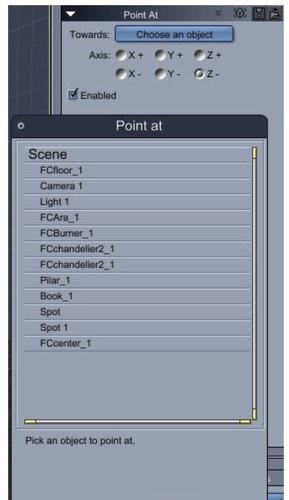

this camera thingee sounds exciting, the camera modifier 'point at' gives axis options?
what would be a scene circumstance to use this?
and point at doesn't mean the camera is going to move along with the object
only thing i can think of is to parent the pointed camera and pointee obj to like a null prop.
theoretically, then a camera could follow a fighter into it's deathstar attack run and be a smooth ride for the audience

    yeah parent it to the figure or prop and it will follow it
    look at is probably not needed as it will keep the view of the prop you set it at if you do not move the camera along timeline only prop

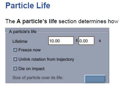

    particle life :lol: die on imact
    yes a particle's life is fleeting :vampire:
    :lol:
    It can speed up the calculations quite a bit.
    The X, Y, Z Axis in the Point At modifier, will effect the orientation of how the camera "points" at an object. You could use one of those and have the camera face away from the object it is pointing at, and still have it "follow" the movement it is pointing at. Not much use for a camera, but the Point At modifier is available as a modifier to all objects, not just cameras.

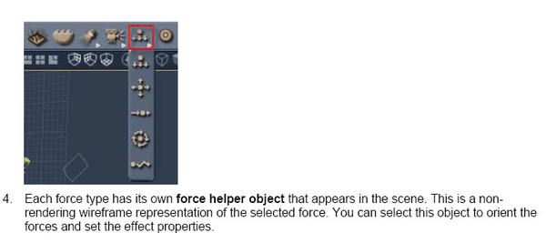

    further along in the manual looking for the wind. was expecting like the wind icon in poser,
    looks like this is the wind dynamics carrara style :) (pg 714)
    709 x 316 - 29K

    The plant editor has a wind function as well.
    You can use the "track" modifier. The camera then moves with the object it tracks. It is recommended to use a target helper parented to the object. All you have to do next is make sure that the camera's hot point is the same as the object's hot point. And there you are, tracking everything your heart wishes for.

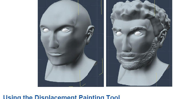

    Displacement Painting Tool?
    sounds kewl :)
    585 x 336 - 33K
    sounds kewl :)
    Comes in handy for many things.
    I used it to add detail to the rock outcrops in this picture.

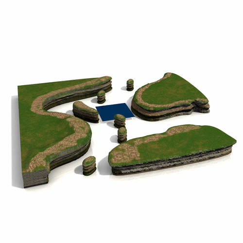

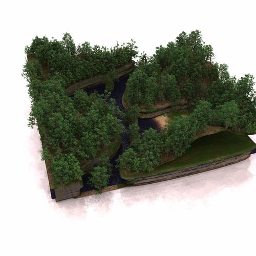

    The rock outcrops are vertex objects that I used displacement painting on, in the VM. I then embedded them in a terrain.
    2000 x 2000 - 425K
    2000 x 2000 - 1M

    The displacement was done in the VM using the displacement painting tool. Hint: use subdivision for best results. The amount depends on the level of detail inherent in the model. Mine are low poly, so I used a couple levels.
    The pattern (leaf litter) you noticed at the top is indeed a result of 3D painting. I actually painted a black and white map and used that as a distribution map in a terrain shader layer. I then made that layer a Multi-channel shader and used a tileable image map of leaves in the Color, Bump and Highlight.
    The green grass is not part of the leaf litter layer, but the main layer, and the placement of its tiling image map is driven by slope and altitude.
    I'll post a filtered view of the shader tree.
