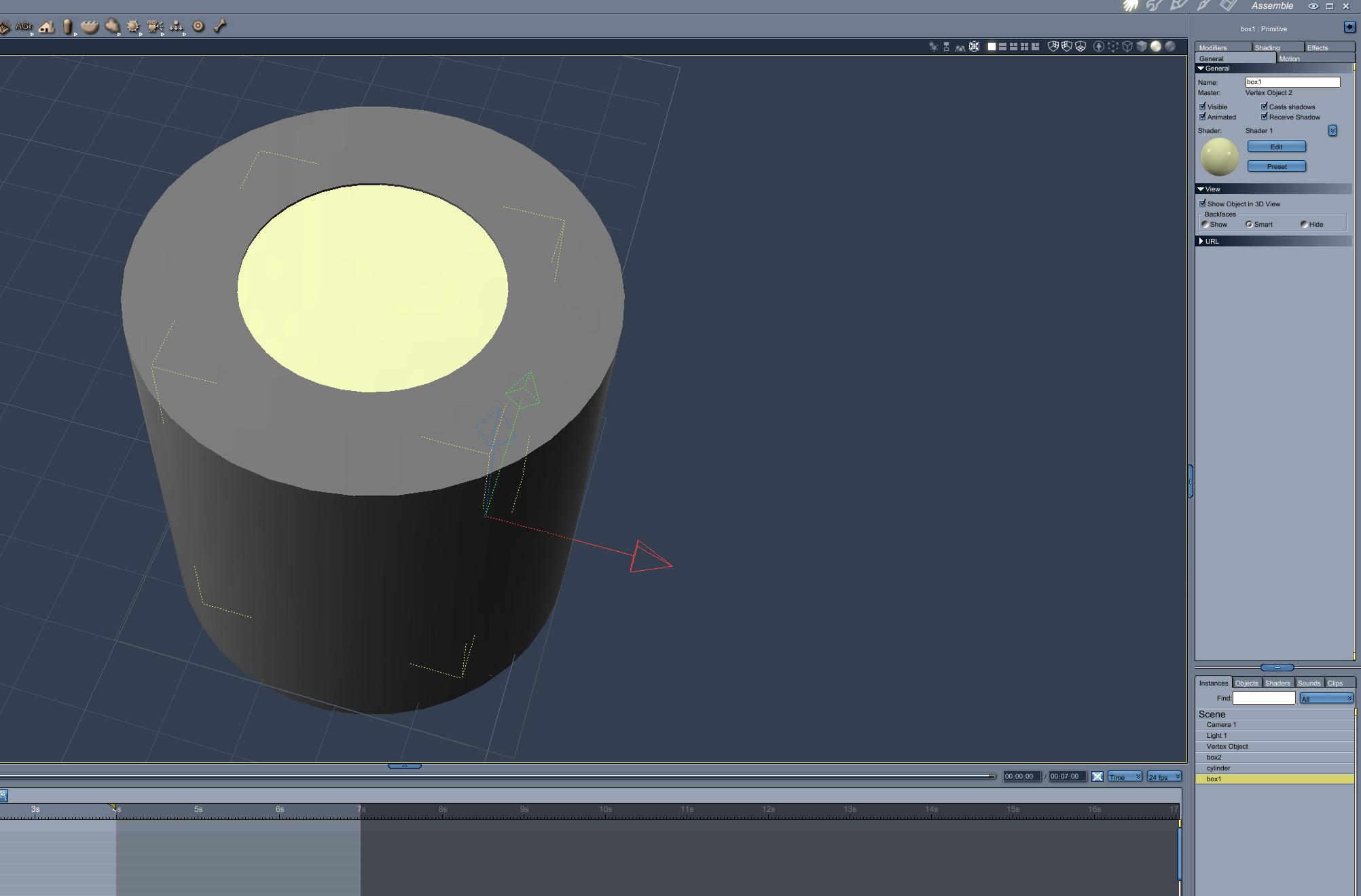

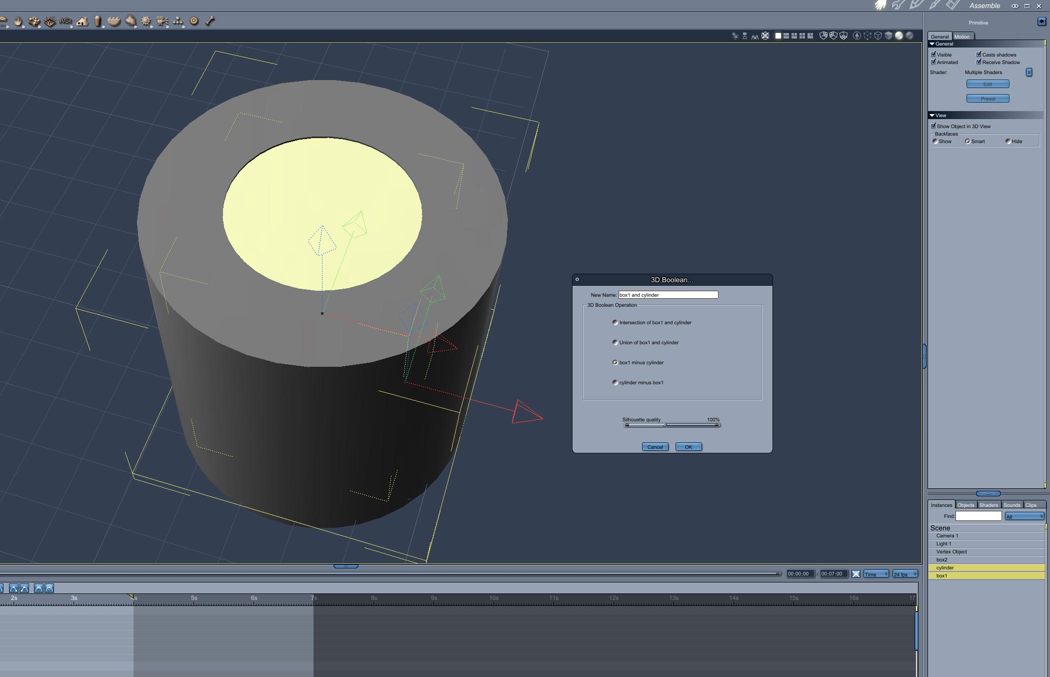

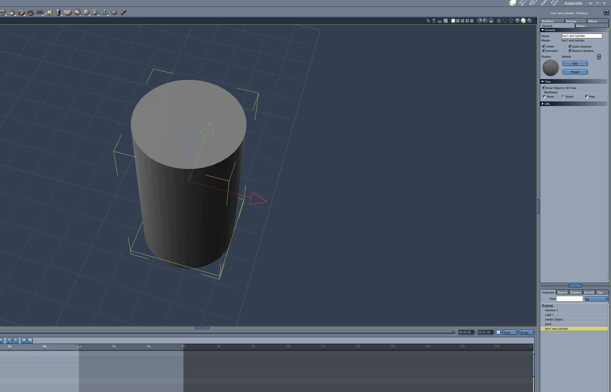

    had a brief play with a donut like cylinder and a cube
    the only way to get what you I could find  want was to to make the sure the walls of the cube were aligned exactly with or slightly below the box walls
    before alignment
    box in cube
    box minus cylinder
    result - interestingly you loose the box colour
