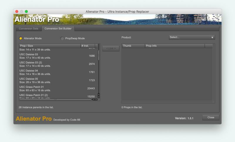

  • sandmanmaxsandmanmax Posts: 992
    I'm not seeing a New Set button in the Set Builder tool.  It looks like I have to create a set, save the set, close the tool, and start over in order to create another set.
    Am I missing something?
  • TotteTotte Posts: 15,262
    No, you aint missing anything, that's the workflow. Basically the reason is that the scripting system in Daz Studio is not really suitable for making "applicationlike scripts" , so to avoid issues between sets that is the most reliable solution to do things.

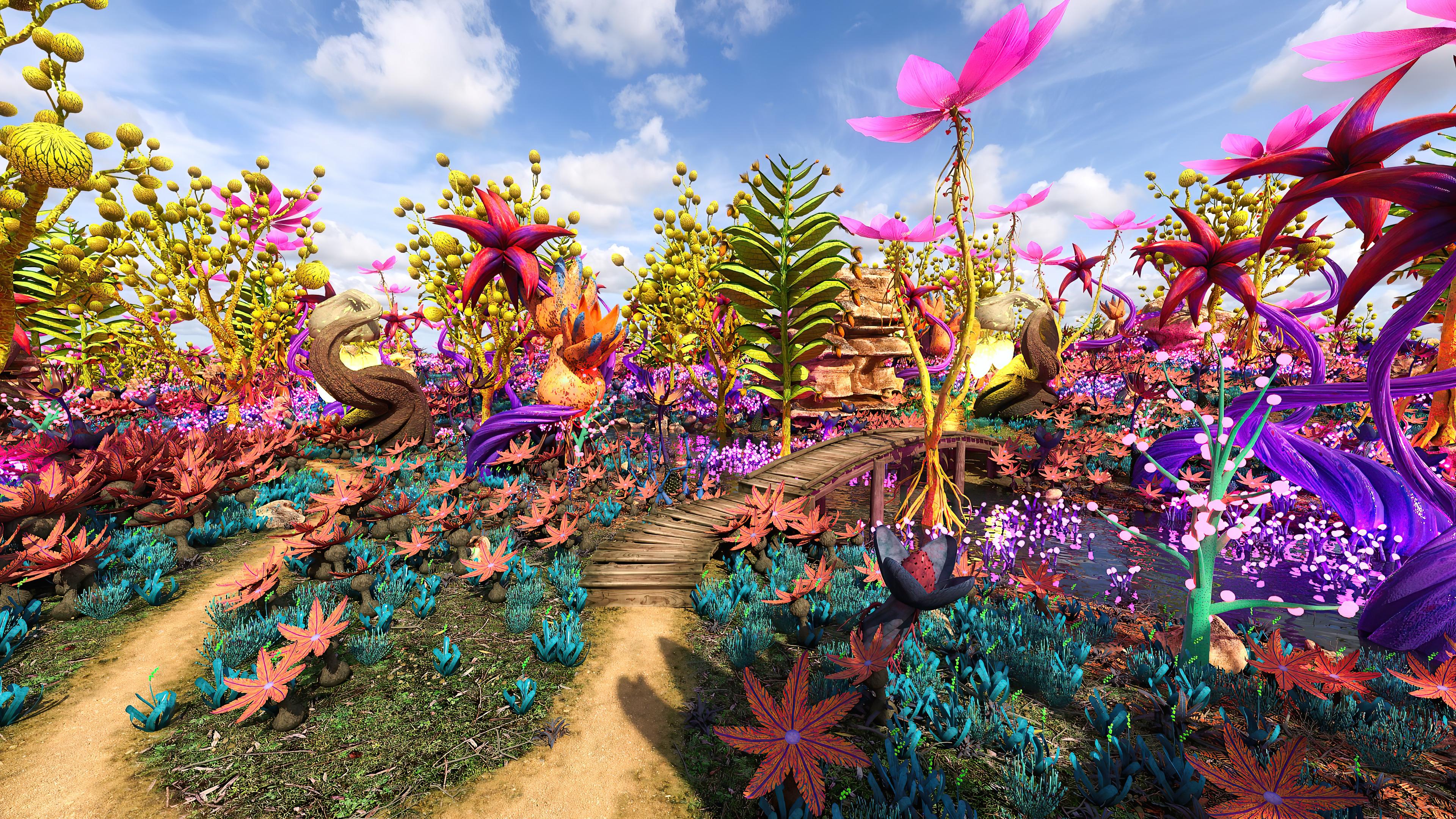

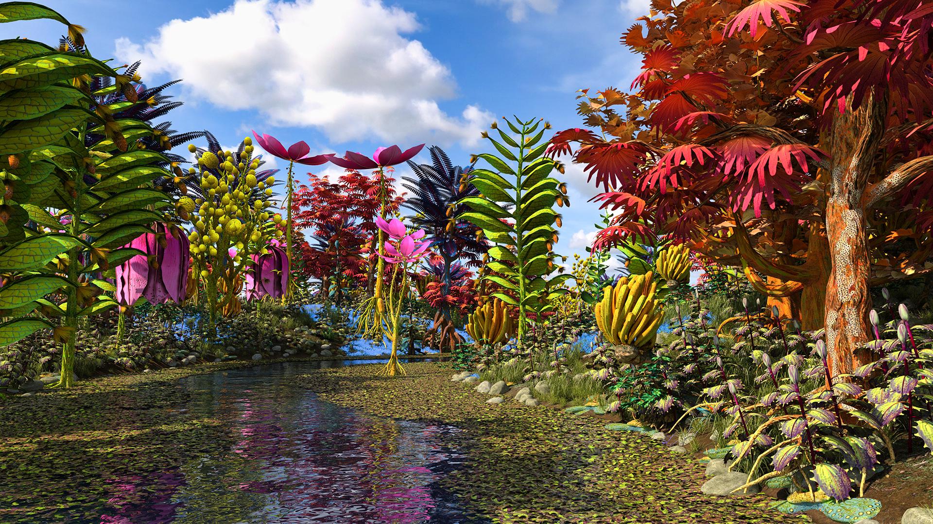

    This was the Crystal Cave before Alienator Pro got a hold of it. laugh
    2000 x 1000 - 2M
    2000 x 1000 - 2M
    Post edited by barbult on
  • MelanieLMelanieL Posts: 7,889
    Lovely vivid (if weird) scene, @barbult - the first one looks just like Santa's grotto! (Well, maybe the "eyes-on-stalks" would be a bit scary for the kids)
    Thanks for looking, MelanieL! I am fascinated by those weird alien things.
