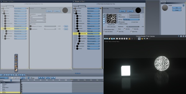

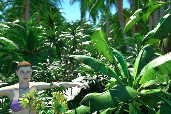

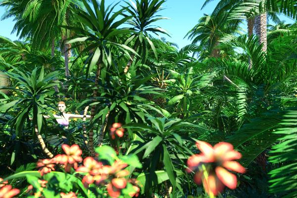

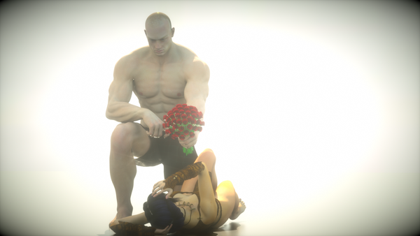

    Thanks. I am sort of getting there. Here is a screen shot of my current issue.
    In this case it is a scene created fully in Carrara 8.5. The screen shot shows the Carrara render on the left and the Octane render on the right. There are a few issues of concern for me.
    1. The Carrara render has haze, the Octane render does not.
    2. The Carrara render has softened shadows, the Octane Render does not.
    3. Also, the Infinite Plane isn't infinite in Octane.
    This is especially vexing because it looks like it works for Phil W's test of Harpwood. What am I doing wrong?
    Again, any feedback you can offer is greatly appreciated. Thanks for your time.

    Edit: Sorry, forgot to upload the actual image. Here it goes. Thanks again.
    Hi Rashad,
    Just some quit answers - hope they help.
    1. For haze you can use a volumetric shader in Octane. Use something like a box primative to enclose your shader, just make sure you have the camera setbup outside your enclosure (do a google search for Octane volumetrics and you should be able to find out how to set it up - sorry I'm on a small tablet right now).
    2. To soften shadows, if your using the octane sunlight, increase the sun size, with mesh lights, increase the mesh size.
    3. Sorry, not at the computer to give it a try.
    Hope this helps a little.
    Dustrider,
    Thanks a huge bunch! Okay, I increased the sun size up from 1 to 10 and indeed the shadows are now soft as expected. That's one hurdle fully overcome.
    For my tastes, the OR4C Plug-in is AMAZING!!!!!! It still has some distance to go however, and I think it still too soon to say with any confidence that this plug in is fully integrated.
    What this plug in needs to do is to leave the user needing to make as few adjustments from within Octane as possible. I shouldn't need any understanding of Octane to use this plug-in, I should find my Carrara knowledge is what I'll need most.
    If this thread is being observed by any of the developers or people who are in contact with the developers here are a couple of things I'd like to see.

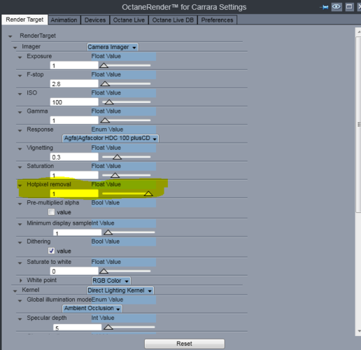

  • Rashad CarterRashad Carter Posts: 1,830
    I really love this plug-in. Did I say love; I meant to say LOVE!!!!
    I have a few questions for Sighman.
    1. How does one go about adding in effects such as a glow around the sun and lens flares via the plug-in?
    2. In the standalone version there is a Hotpixel removal slider. I do not see access to it via the plug-in, as well as several other options available in the stand alone. Is there a way to bring up all of the Octane Render Standalone controls while within the plug-in?

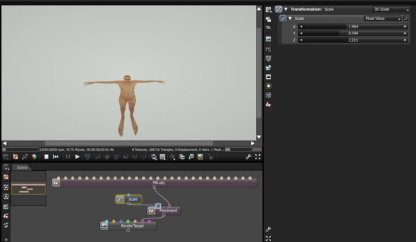

    3. Scaling is giving me a fit. Am I just dense, or is there no way to adjust the scaling of an object once it has been imported into the Standalone?
    Thanks again for any advice you can offer me.

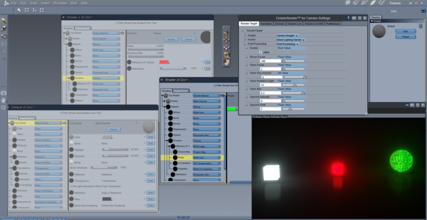

    Hi Rashad, Here are a couple of hints for you while you await Sighmans reply ;)
    Hotpix removal can be found in Render Target settings under IMAGER and you can activate post effects such as bloom and glare in Render Target settings under Post Processing..
    337 x 403 - 17K
    686 x 661 - 29K
    671 x 650 - 34K
    Post edited by Orion_Uk on
  • SighmanSighman Posts: 56
    To scale a mesh in the standalone, plug it into a position node and add a 3D or scale transform. You can then scale your mesh from there.
    If you are exporting from the Carrara Plugin then the position nodes are already there.

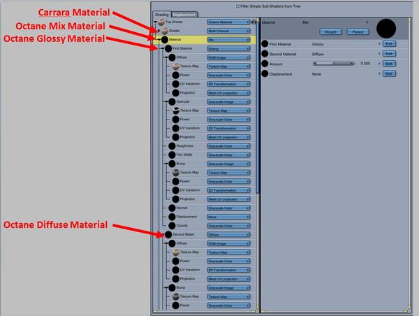

  • Orion_UkOrion_Uk Posts: 231
    As Sighman explains, here is a visual of Standalone node setup for mesh resizing..
    1173 x 684 - 430K
    1172 x 674 - 539K
    1176 x 691 - 422K
    Orion UK,
    Thanks a ton. Major ball drop on my part The moment I saw the first screen shot I knew I had asked a silly question. Indeed all of the options are there, if only I would look.
    For someone like me I have to learn the concepts of the standalone, and then learn how those concepts are presented in the OR4C plug-in, but I'm probably going about learning it all in the wrong order.
    Without question this plug-in is one of the best purchases I've made in the better part of the last decade!!!

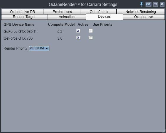

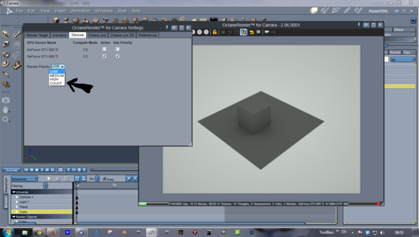

  • Akulla3DAkulla3D Posts: 131
    If I may ask another question from you all. What does count mean under render priority?
    Thanks again.

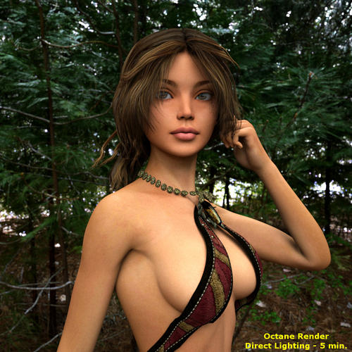

    Most of these frames rendered at an average of 25 seconds per frame (1280 x 720). For a chosen frame in this movie (indoor shot), I noticed the following render times when switching between lighting kernels at 1000 max samples:
    Direct lighting - 26 seconds
    PMC - 1 minute 42 seconds
    Path Tracing - 1 minute 40 seconds
    But what you get depends on several things like the scene objects, materials, lighting, etc. The outdoor scene in this movie rendered at 28 seconds per frame when using Path Tracing. For the indoor shots (and since this was mostly a test) I used the Direct Lighting kernel/model because I didn't see a big enough difference to justify the longer render times (and because I challenged myself to complete the movie in 10 days).
    Now comparing this to my home-based/small render farm, this might be difficult to compare to PMC/Path Tracing because it has been a while since I used Carrara's full GI / indirect lighting. But with direct lighting with my render farm (using high quality settings) I can easily get under a minute per frame and sometimes around 20 seconds per frame (or less). Obviously with busier and more complex scenes the times are higher. Also, I was use to rendering out passes and putting them together in post. Working with Octane forced me to consider how to get Octane to produce my final look (or close to it) before rendering. In some ways this has saved time on this project (as the usual level of post work was not required), especially with all of the depth of field shots in this movie. Since it would take almost forever to get Carrara to produce a frame containing depth of field, I would render out depth passes as rpf files to have in post close to the control I had with Octane.
    Also, what you don't get with the built in renderer is the realtime final render views you get from Octane's realtime viewport, which I really like and also saves time.

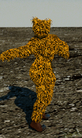

    Question for you guys though, today I was just about to purchase (weeks behind schedule but got the money to cover it and even a little time to play) but the warning says to make sure you have a NVIDIA driver version of 335.23 or higher. It took me quite a while even to figure out how to check this, but as far as I can tell pulling up my Nvidia control panel I'm running 327.02. I figure I should be able to just update, but I'm really bad with this stuff, and when I click on help and updates, I get an error: 'Failed to start Nvidia update. Try again later.'
    Any idea what I'm doing wrong here, for those of you guys that really understand how this stuff works?
    Thanks again.
    I'm sorry, but I can't figure out what you are referring to. Where did you find something called 'render priority'?
    edited September 2014
    Sighman said:
    Thanks again.
    Sighman, I think akulla3D was refering to COUNT Rendering Priority dropdown menu under CARD PRIORITY via Device settings through Render target settings..
    ..if your still with me! :P
    1360 x 768 - 479K
