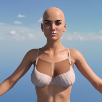

  • LauritaLaurita Posts: 294
    edited November 2020
    iwave said:
    Laurita said:
    The dforce simulation actually works nicely, but it screws up all materials. So no bikini renders.
    Hi,
    Could you please describe the materials problem you have encountered in more detail? I will try to fix it.
    When you use - for example - a character with Kayleeyss mats or with V3Digitimes Wet and tanned Skins  - or any other non.standard materiak I tried, the breast area will get overwritten with a base materieal , which will obviously not fit the remaining Torso mats.
    Post edited by Laurita on

  • iwaveiwave Posts: 46
    Laurita said:
    iwave said:
    Hi,
    Thank you very much for the information.
    I have tested V3Digitimes Wet and tanned Skins.
    The manual solution is as follows:
    1. After applying V3D Skins, select Arms and Surfaces in the Surfaces panel, and save them as Shader Presets. Here, I named them "Arms shader" and "Torso shader", and created a sub-folder called "test materials issue" under the "dForce Soft Breast" forlder to keep them.
    2. Apply dForce Soft Breast.
    3. Select dForce Soft Breast in the Scene panel, then select Arms in the Surfaces panel, and apply the Arms shader to it. And then select Breast and apply the Torso shader to it.
    4. Do a rendering and you can see that the problem is resolved.
    I will modify the script to automate these steps.

  • The above described method for fixing materials is not working for me. I am trying to use materials from Aurore for G8F by Kayleyss and as far as I know there's nothing special about those character materials, but applying the torso surface to the breast surface doesn't fix the issue. I tried to do it as a saved shader preset as instructed and it made no difference, the material on the breast is much darker for some reason, even though all of the parameters on both surfaces match.
    I also tried applying the materials to G8F and running the script, and it automatically applied the surface material from the character's torso to the breast. But it still doesn't match.
    Hi,
    I have found the cause of the problem. In Aurore's skin material settings, there is a property called 'SSS Reflectance Tint'.
    Usually ,the 'Use Limits' for this property should be checked by default, but Kayleyss unchecked it and set 'SSS Reflectance Tint' to 2.05, 3.00, 3.00.
    In the material settings of the dForce Soft Breast, the maximum value of 'SSS Reflectance Tint' is 1.0, 1.0, 1.0 due to the limitation of 'Use Limits'.
    So in the rendering results, there is a color difference between the dForce Soft Breast and the surrounding skin.
    To solve this problem:
    1. Select 'dForce Soft Breast' in the Scene pane and then go to the Surfaces pane.
    2. Select 'dForce Soft Breast > Breast' and find 'SSS Reflectance Tint'. Uncheck its 'Use Limits' in the Parameter Settings window, then change its value to 2.05, 3.00, 3.00.
    3. Select 'dForce Soft Breast > Arms' and find 'SSS Reflectance Tint'. Uncheck its 'Use Limits' in the Parameter Settings window, then change its value to 2.05, 3.00, 3.00.
    Render again and you will get the correct results.
  • That worked, thanks. Good catch on which setting was different, I thought I had compared every parameter but I missed that one somehow. I didn't even know color values could be set higher than 1.0.
