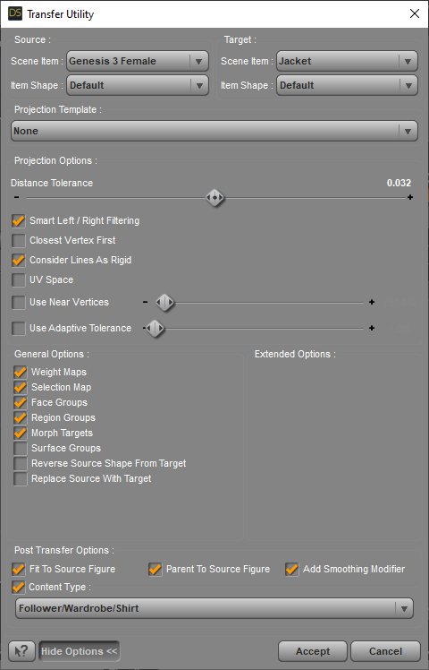

    Using the Transfer Utility to turn the .obj files into clothing files, I've attached 2 images. One has the default G3F and shows the settings I used. The other image is G3F with a character shape dialed and shows the settings to use in those situations.
    I ran the simulation only on the skirt, stopping it when it looked okay for this pose.
    Just did a quick material surface job there - after clothing items are made, there can be more work to be done such as for morphs to enable for eg., the skirt to fit under the jacket or the jacket to fit over the skirt. [and after running the simulation this model was only usable from the front view 'cause I hadn't done any weight map painting which yes, is a great feature to make use of ;-)

    Check the first image in my post a bit above this one. I ignore the projection part, many do.
