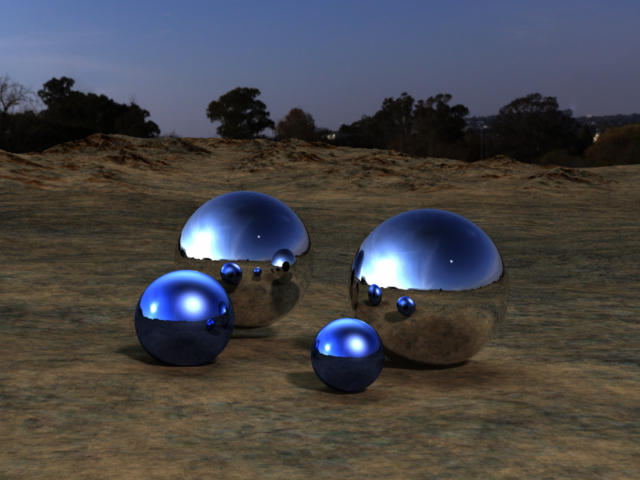

    mmm
    I used a hdri for the background and used grid mesh textured to try and match the hdri image
    640 x 480 - 375K
    Post edited by Stezza on
  • SileneUKSileneUK Posts: 1,980
    Stezza, nice HDRI, where did you get that one?  I have a lot, but they never look quite right for what I need.  heart Silene
  • UnifiedBrainUnifiedBrain Posts: 3,588
    Stezza said:
    mmm
    A good solution, Stezza!  In other words, don't use a shadow catcher if you want reflected shadows.  Just lay down a mesh in the forground that matches the HDR.  Of course, you have to know enough about Carrara to be able to accurately texture that mesh. :)
