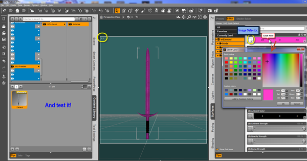

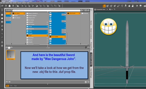

One of the things I love to do with Hexagon is to make my own props for use in Daz Studio, helped along by Danny Ripley (CG-Dreams) and Gary Miller (Geekatplay..Com) and others who have passed on their Hexagon know-how.
I'm far from their skill level but I would like to do a tutorial on making a sword, so here goes (I hope I do not mess up too much) -
This is a LuxRender pic, rendered in Daz Studio via Reality (my perfect render button).

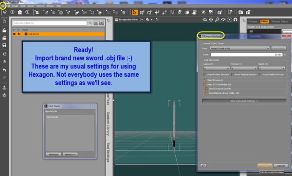

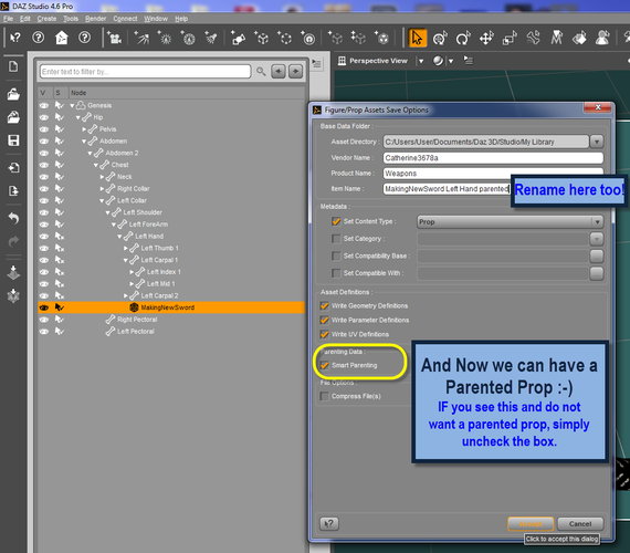

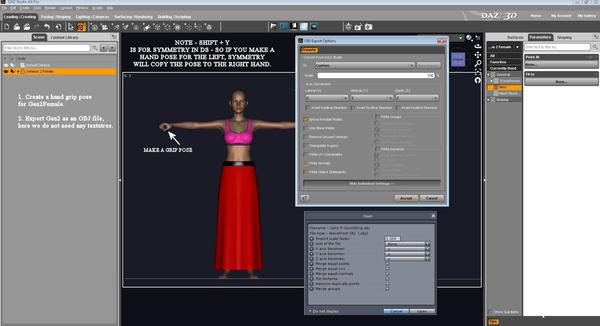

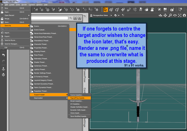

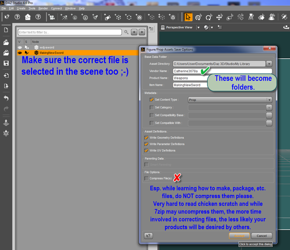

Daz Studio - Export
Please click on images to view full screen.

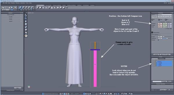

Scale.

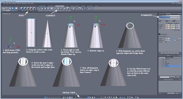

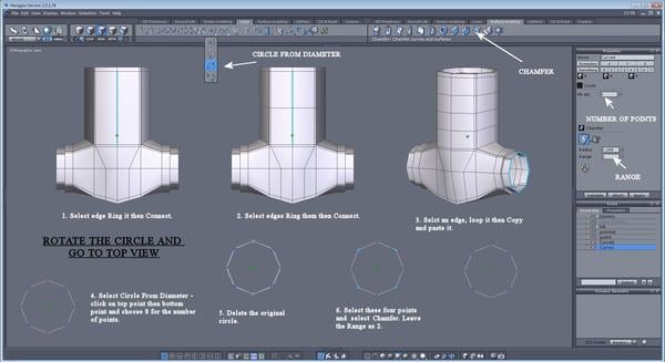

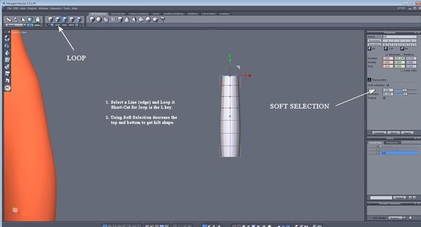

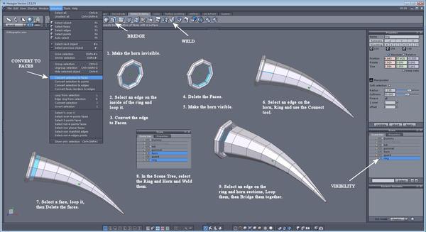

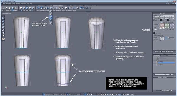

Making the hilt (handle)
4-hilt
5-hilt
6-hilt
7-hilt
8-hilt

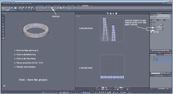

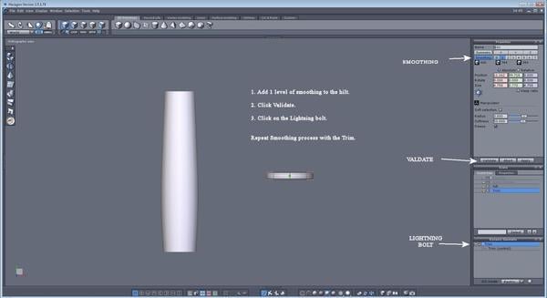

I like to save what I am working at certain times -

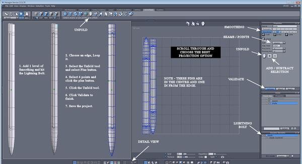

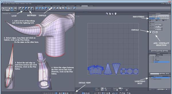

Before adding any smoothing

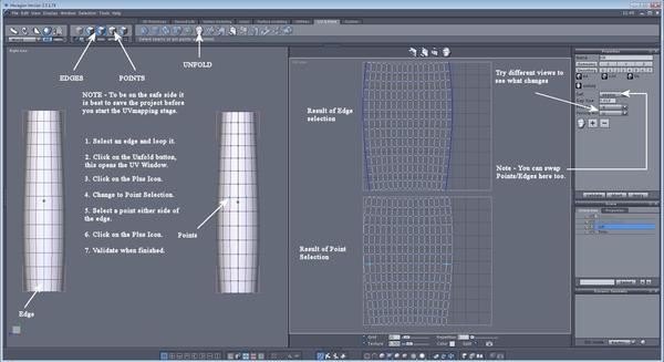

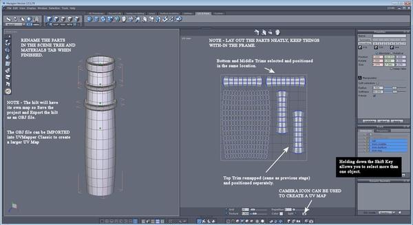

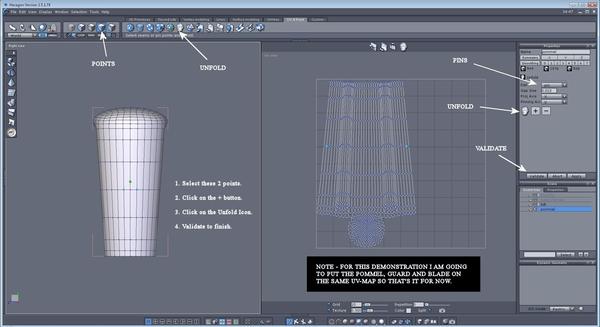

Before UVmapping
9 hilt
10 hilt
11 hilt

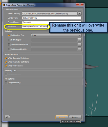

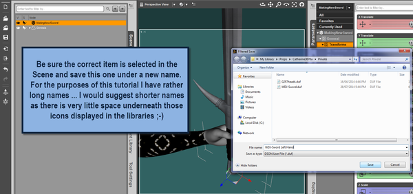

Hilt finished - Save the project :)

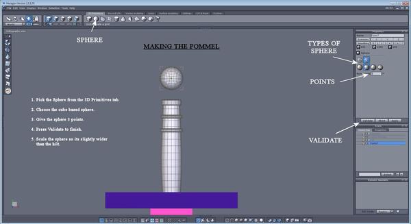

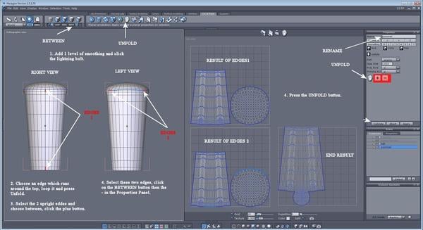

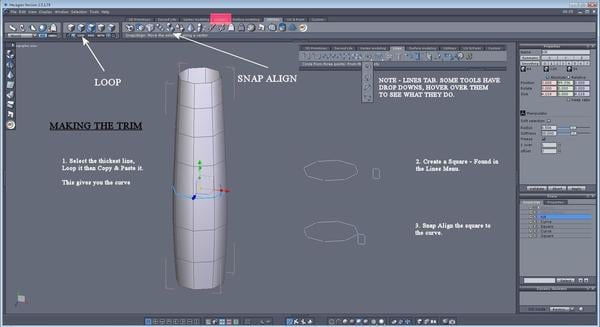

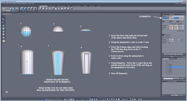

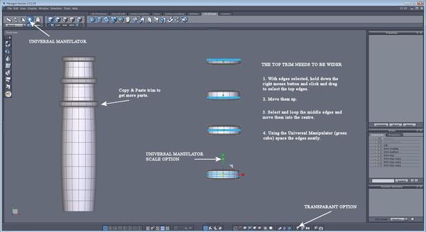

Making a pommel
Step 14-Pommel
Step 15-Pommel
Step 16-Pommel
Pommel Finished - Time to Save the project :)

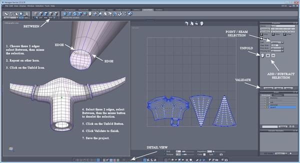

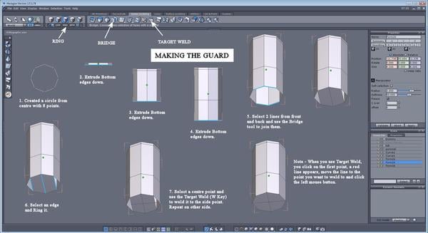

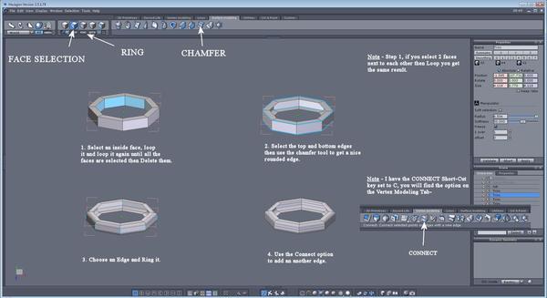

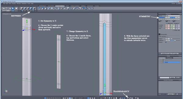

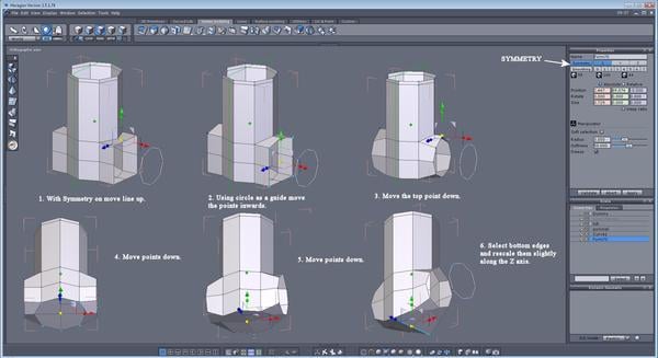

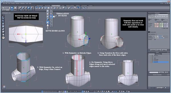

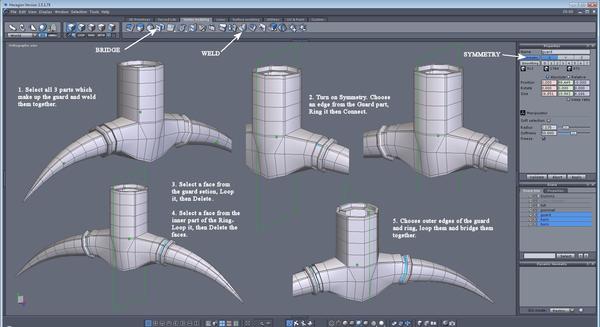

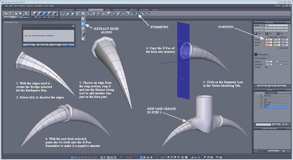

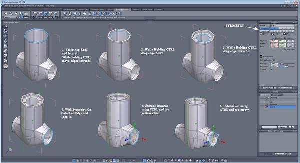

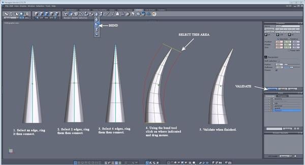

Making the guard.
Step 19 - Guard
Step 20 - Guard
Step 21 - Guard
Step 22 - Guard
Step 23 - Guard
Step 24 - Guard
Step 25 - Guard
Step 26 - Guard
Step 27 - Guard
Step 28 - Guard
Step 29 - Guard
Step 30 - Guard
