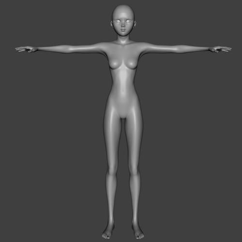

    Ah, you're not the only one. I use Poser mainly too and only use DS for Genesis/G2F.
    How about A3 XinXin's head on G2F's Fiends Forever body... on the original Genesis. :P
    700 x 700 - 40K
    Post edited by Lissa_xyz on

    Thats's amazing! I'm having a hard time just finding the character I saved so I can try and add the v4++ morphs! Where do I find them!?

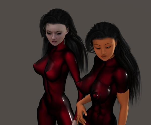

    Opening DAZ I repeated step by step what you provided above. It worked like a charm! I was able to gain back control of Genesis Breasts using the V4++ Morphs. My ultimate goal is have a V4 body but with an A3 character face and Dimension3D GenX worked like a charm. The only things I was having trouble reproducing was a particular characters breasts and her skin texture and lip thickness. It was my first try and I didn't even know about smoothing or think to dress her here in DAZ and export the cr2 with clothing. Heck to be honest I couldn't find the dials cuz I'm not used to the layout.
    So I'm thinking I load my genesis and follow your directions however use the A3 Morphs, dial in her breast size, height, dress and then export.
    Here are the two side by side.
    992 x 824 - 36K
