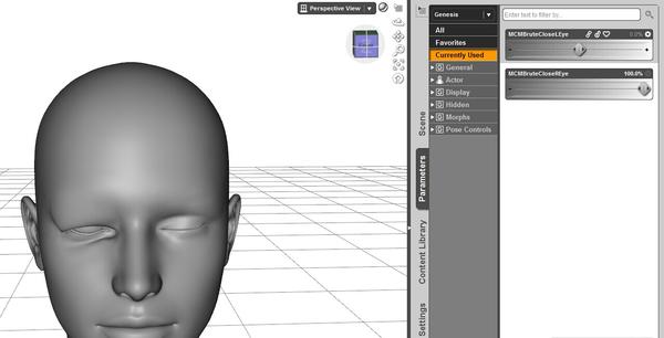

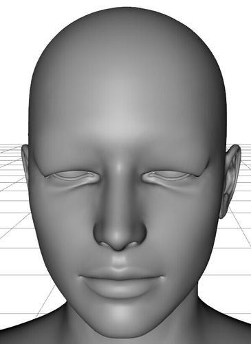

My genesis can not close eyes as in the picture.I used the eyes closed morph in the eyes morph group. It did not close the eye even I dialed the parameter to 1 and seems weird.
I reinstalled the genesis starter essentials but this problem is not be fixed.

    When you have the 'Eyes Closed' morph dialled to '1', can you look under 'Currently Used' in the Parameters pane please, and tell me what you see in there?
  • guangh69guangh69 Posts: 167
    ty for your answer.Jimmy. I recaptured a image,and there is not other morphs used
    1653 x 683 - 152K
    This used to happen at the beginning when Genesis first came out.
    A copy which used some freebie morphs, became saved over the original Genesis, and led to all sorts of problems. I am baffled here. Mine works fine (of course) but that doesn't help you.
    When you load a fresh Genesis from your Content Library pane, are there any morphs used before you do anything to it at all? (Currently Used) Is it just this eyes closed morph that causes problems, or are there other abnormalities with other eye morphs?

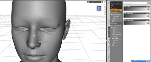

    Perhaps a hidden corrective morph may be causing it (e.g. due to being wrongly set-up). See if you can load a base Genesis, close the eyes, and then enable "Show Hidden Properties" (via the small three lines icon menu top right at the tab). Go for "Currently Used" with the eyes closed and see if additional items show up.
    Post edited by Renpatsu on
    edited June 2014
    Oh My God!
    There are two morphs on the whole body which are cauing this problem. When I dial Eye Closed parameter to 1.These two morphs automatically changed to 100%. I need to dial them down to 0%, I do not know why
    Thank you very much! JimmyC_2009 and Renpatsu!
    1279 x 653 - 100K
    Post edited by guangh69 on
    Glad you found the problem.
    Thanks Rempatsu, I forgot about Hidden dials, mine are usually unhidden all the time.
    guangh69, if you set the morphs to zero again, and save the Genesis.DUF to your People folder, it should overwrite the one with the morphs set, then it will always load correctly. You probably knew that anyway, but I just mentioned it to be sure.
