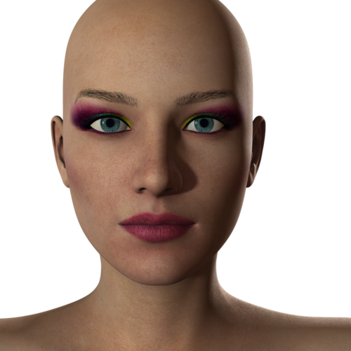

Have you ever wanted to take the Makeup off of one character and put it on another? Maybe it's just me. In any case, I have found a surprisingly easy method to do just that. It transfers makeup perfectly, and requires no painting skill whatsoever. All it requires is GIMP (I imagine Photoshop would also work) and the Layered Image editor in DazStudio to combine them (again, you could also combine them in your photo-editing software, but I find the LIE more versatile)
1. Find the makeup you want to steal. In Gimp, open the base (makeup-less) texture of the character whose makeup you're stealing and the texture with the makeup you want.
2. Copy your makeup texture and paste it, as a layer, on top of your base texture.
3. Set the layer mode for your makeup layer to Subtract. The image should now be primarily black with some ugly colored makeup shaped splotches. This is exactly what you want in the file menu select export to save the file as a .jpg (Gimp has an odd setup, I know) save it somewhere you'll remember and layer it fairly clearly depending on the style of makeup it may have another image it goes with, so be sure to make it easy to identify as part of a pair.
4. In layer mode scroll back and forth between Difference and Subtract. If they are exactly the same, Hooray! Your makeup only darkens the skin and you only need one image to replicate it perfectly, you are now done in GIMP and can skip steps 5 and 6. If there are any differences the makeup lightens the skin as well as darkening and we need a second image to replicate this.
5. Set your makeup layer's layer mode to lighten and duplicate your base layer. You should now have 3 layers: the base layer, its duplicate and the makeup layer.
6. Merge the makeup layer and duplicate layer together, and set this new layer to difference. Once again you should have something primarily black with some makeup-y splotches export this image the same way you did the other one and give it a similar name so you can find both later. You are now done in GIMP.
7. Apply whatever texture you want to whatever character you want. The only limitation is that it does have to be the same UV map as the texture you took the makeup from (or convert the textures you made to the UV you want using the map transfer tool)
8. In the surfaces editor select the lip, nostrils, and face. Open the LIE for the diffuse texture.
9. In LIE Create 2 layers and open the textures you created (obviously if the makeup only needed one image you only need one layer). Set the first image you created's blend mode to subtractive, and the second to additive. Hit accept, your makeup should be fully transferred.
The image below is Zev0's Skin Builder with makeup kiboshed from Girl6.
If you have any questions, please ask ; I'm sure there's something here I've explained terribly,
