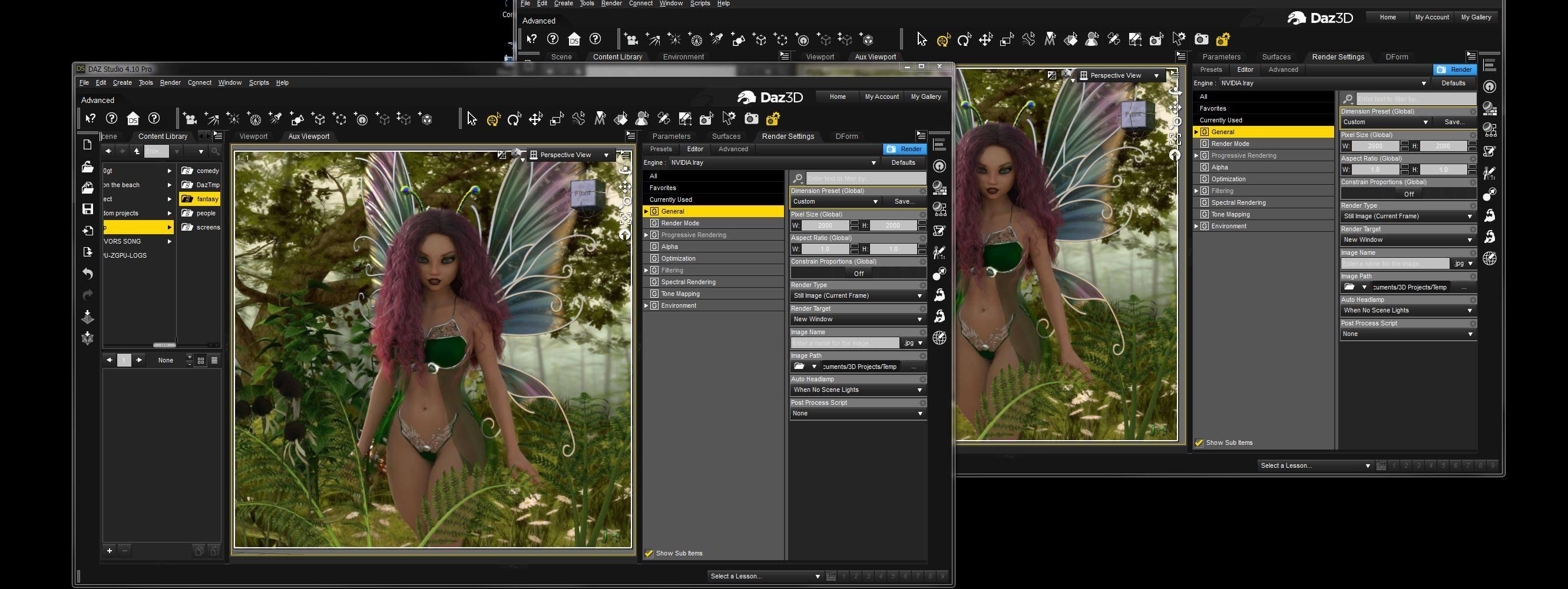

    yeah I can see that being rather redundant and get old fast. I did fired both daz 4.9 and 4.10 tonight using the same scene I was working on in 4.12.0.86 and had no issues with it rendering both of them at the same time.
    I captured this off my dual monitors boths daz's rendering the same scene at the same time in the view port and didn't have any issues maybe my system handles it better for some reason this scene with both versions of daz running was only using 9.7 gigs out of 11.5  on my 2 -1080ti's using Legacy GPU driver 436.30 for all my daz versions. I am using which is what I am currently using . But if you download the new Daz 4.12.1.17 and newer you will need the uptodate driver to make Those versions of daz work which is why I have not installed them yet until I upgrade my 2 1080ti's to a 2080tis or maybe something newer. but this has been working pretty well for me for now .its just daz 4.9 or daz.4.10 do not have all the new features like daz 4.12.0.86 has like the timeline
    2662 x 1001 - 332K
