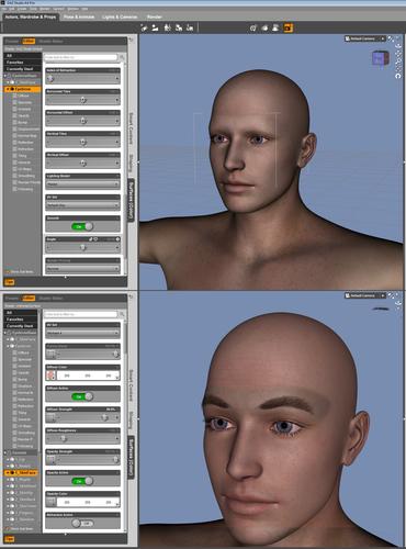

    1. In the working pane there isn't any eyebrow displayed. But in the render it appears. So far ...
    2. Using the Genesis1 Base there isn't any material preset to apply to the eyebrows base. So I created a material preset out of the standard Genesis Male.
    3. But what ever I do, the resulting eyebrows base appears way too dark in the final render.
    I Think, the reason is, that the eyebrows are not using the Skin construct (UV Set) which is used by the Genesis1 Male base character. It is not compatoble to any of the Genesis characters bases delivered with DAZ 4.6.
    EyeBrows offers only the standard UV, whereas the characters use Michael4, Victoria4, The Kids4, ... UV Sets.
    But that too dark background is also the problem if using other skin texture / color. I tried it with Genesis Basic Child (Kids4), JT Justin and own new skin color presets, too. Ever the same problem as shown in the attached pichture.
    Andy

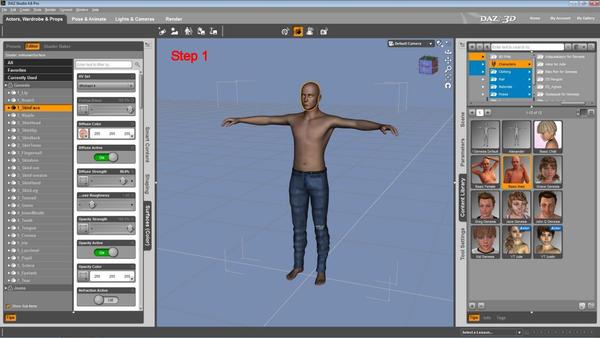

    Pictures attached at the end
    (I hope they will appear in the correct sequence)
    Step 1:
    I inserted the standard Genesis1 Basic Male. Then select the character's head.

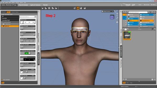

    Step 2:
    Apply the basic eyebrow prop to the head of the character. Now I'm requested to apply some skin material to that zone.
    Initially there isn't any Genesis base material stuff for Genesis skin texture. OK, you can do it manually for each attribute of the numerous entries in the texture setting, but ... So I simply saved my Genesis complete skin as a material preset for later easier use.
    Step 3:

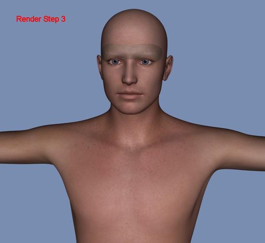

    Select the "SkinFace" material tab with the surface selection tool. Here I applyed the complete face skin setting of the original Genesis. Afterwards all paramaters look the same compared with the normal Genesis skin setting - except the UV set. But there is no way to change it to the necessary correct value.
    In the working plane it looks quite good.
    But in the render you see the remarkable difference !!
    Continued in the next post

    Step 4:
    Make a mouse right click on the EyebrowsBase. Then I select the entry "Select 'EyebrowBase'".
    Now I can apply an Eyebrow material and get the visible eyebrow only in the render result.
    End.
    But as you see, there is still the too dark / wrong color of the eyebrow's zone. Only visible in the render result.
    If you see that I had the wrong sequence or missed a necessary step, so please advise.
