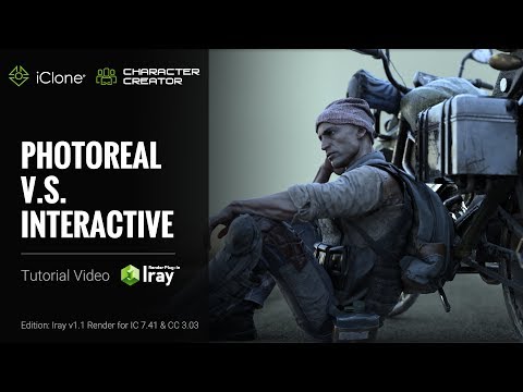

    wolf359 said:
    Here's the use of Iray interactive in iclone. Doesn't look bad. Probably depends on your settings, etc.
    It is not just about speed.... people IRay was a massive FAILURE in the iclone community because it does not support the smoke,fire and other realtime particle effects that Iclone users had come to depend on for their animations...Unreal can do these types of things and is far more versatile for film-making useage beyond making BORING brute force arch -vis ,portraight /pinup& consumer product renders.

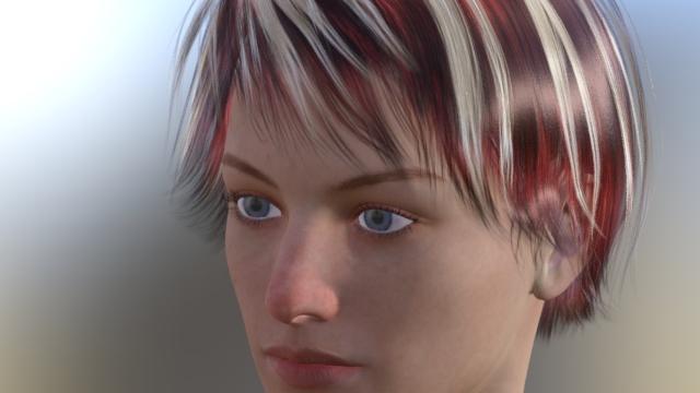

  • PadonePadone Posts: 4,315
    edited December 2019
    RayDAnt said:
    Here is how to activate Iray's built-in alternate graphics rendering mode purpose built for achieving high quality game engine level graphics in relative realtime:
    1. Go to the Draw Settings pane and set
      1. Drawing > Draw Mode = "Interactive"
      2. DrawingOptimization > Refinement Mode = "Interactive"
    2. Go to the Render Settings pane with NVIDIA Iray selected as renderer and set
      1. Editor tab Render Mode > Render Mode = "Interactive"
      2. Editor tab > Optimization > Refinement Mode = "Interactive"
    The reason why I gave up at interactive mode is it had a terrible support for alpha-mapped transparency. But that was 4.9. Thank to your post I gave it another try and it seems much better now, though of course it's not photoreal quality. Thank you.
