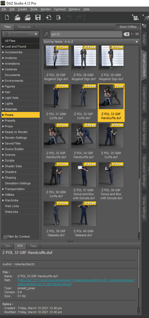

    For my examples below, I am using Props and Poses Converter from Genesis 8 Female to Genesis 3 Female but all the RiverSoftArt Props & Poses converters should work in a similar fashion.
    Please note that the manual says that items without metadata will not show up in Smart Content. If the items you would like to convert do show in smart content, then follow along here...

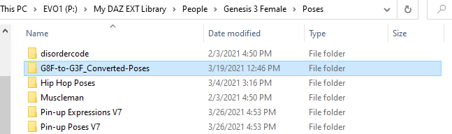

    @JamieM First, make sure your "Output Directory" location is correct. For example, I also use an external drive and my poses ouput directory is:
    My DAZ EXT Library --> People --> Genesis 3 Female -->  Poses --> G8F-to-G3F_Converted-Poses
     - and -
    My props output directory is:
    My DAZ EXT Library --> People --> Props --> G8F-to-G3F_Converted-Props
    In other words, you should add a converted folder inside the Poses folder or inside the Props folder if you are converting props, as smart content will pull from these folders, since your external library is mapped in Daz Studio preferences.
    NOTE: After I converted some props, I thought they did not show up in Smart Content, but upon closer inspeciton, I noticed that they did show up, but the character version name (ex. G8F)  did not change (apparently the conversion script saves the new file with the exact same name).
    For example, in my Smart-Content-01 attachment, the highlighted image, Z POL 33 G8F Handcuffs.duf is actually the converted G3F version, but the name did not update. You will notice this converted pose says, "Pose" in the top-right corner, while the next pose in my smart content folder has the exact same product name, but says, "H.Pose" in the top-right corner (that is the original G8F pose).

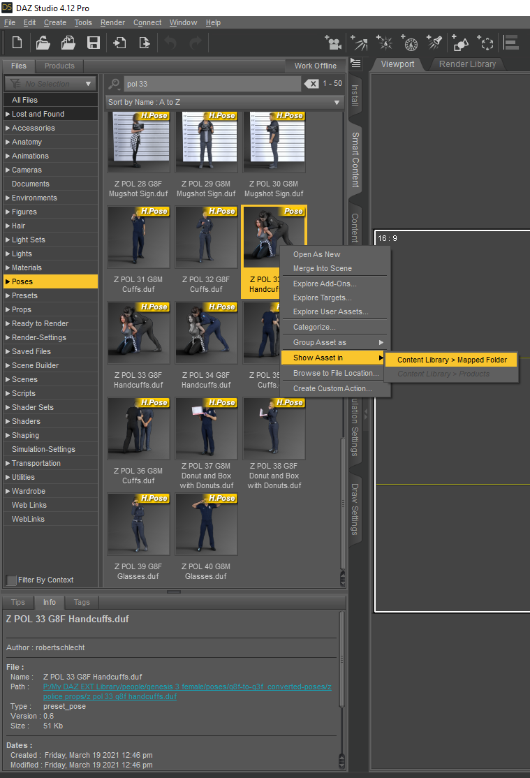

    To fix the name in Smart Content...

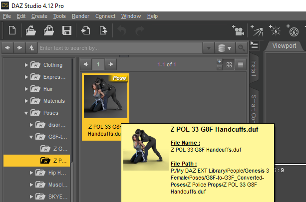

    Right-Click on the converted Pose with the wrong name and select Show Asset in --> Content Library --> Mapped Folder
    Now in the content library with the product selected, if you hover over it, the pop-up will show File Path, which should point to your output directory (G8F-to-G3F_Converted-Poses in my case)

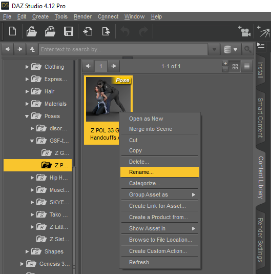

    Now, right-click on the thumbnail and choose: Rename

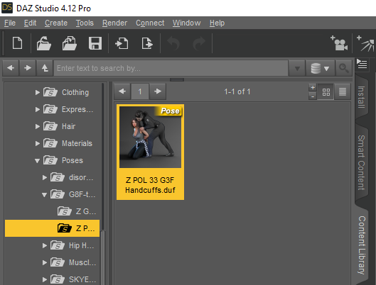

    Simply change G8F to G3F (or vice-versa if you were converting G3F to G8F).
    Go back to your Smart Content tab and the converted thumbnail name still hasn't changed.
    Right-Click on the Poses category and choose: Refresh
    You will see the thumbnail Pose in smart content now has the new name, G3F in my case.
    I hope that helps you and others.
    Thank you @Robertswww for sharing that detailed tutorial smiley
