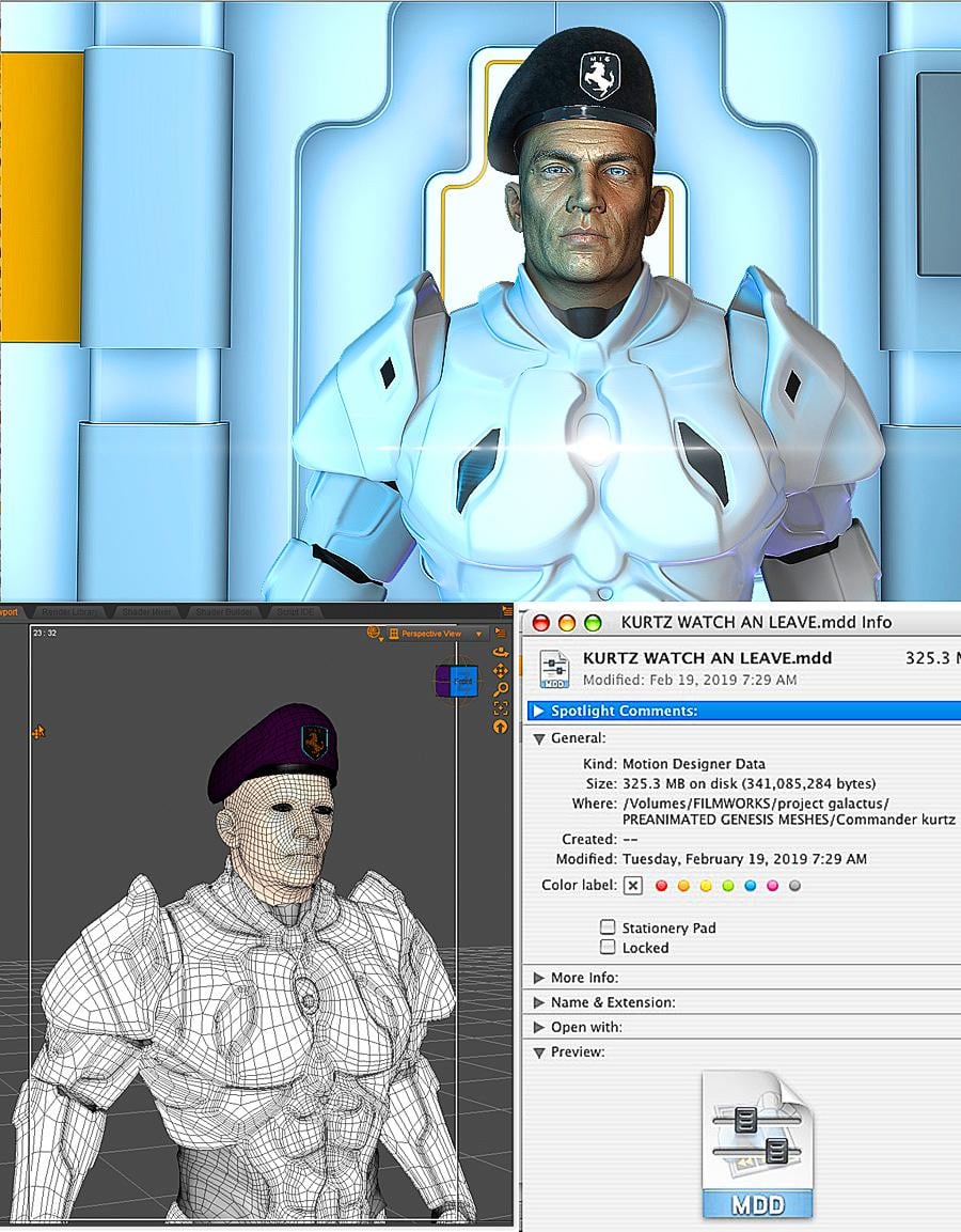

    Hi I render in C4D not blender
    I use MDD because  64 gigabytes for for a single Character is not an acceptable Data size for my pipeline.
    Also All of My UV information is retained with .obj/MDD from Daz studio thus my textures load into C4D upon import.
    And I can send over a Daz G3 figure at ZERO SubD and Subdivide him at render time in C4D  while only having to deal with a 326 megabyte .MDD file for a 300 frame animation!!!
    Note how good this Zero subd exported Ivan 7 looks  in the attached image.
    I can Also grow C4D Spline based dynamic hair from the vertices of a .obj file  that is driven by MDD
    Every genesis Figure in My feature length film is a .obj file inC4D driven by an MDD data file  exported from Daz studio.
    900 x 1153 - 539K
    Post edited by wolf359 on

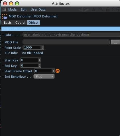

    I would add that your experience with these mesh cache transfers will vary greatly depending on the features supported by the exporting program and the importing program.
    I have not used Blender 2.8 but as of 2.79B the import features of blender are frankly abysmal compared to the options I have with my Riptide pro plugin that I use for handling My MDD imports to C4D which finds applies
    Daz exported the textures  for me.
    And the native  MDD importer for lightwave3D is quite excellent  IMHO
    In general ,establishing an external,Daz content rendering  pipeline typically requires more than a hobbiest/tinkerers level of knowledge about the importing /rendering app.
    This is why most people prefer to just keep everything inside Daz studio or poser.
    So before scampering off and buying all sorts of export plugins from the Daz store you should be sure that you want to committ to this kind of rendering work flow particularly for animation renders.

    For example  a moving speaking Daz genesis figure with JCMs
    is a bit "challenging" to faithfully duplicate  natively in many programs even as FBX imports, without alot work.. yes?
    And there is Dynamic cloth  or fluid simulation that is better handled by some programs than it is by others
    For example Maxon Cinema4D  today still cannot solve dynamic cloth on a moving Characterangrycrying
    However  Daz studio can do so fairly easily
    That's absolutely my case. I got fed up with trying to get dForce to work on a kind of difficult case, and wanted to try the physics in Blender. It turned out better than I could have imagined because it's so easy to Google specific cases and trouble that you're having.

  • wolf359wolf359 Posts: 3,955
    edited September 2019
    But I do have a question about the hair demo you posted: I think you said it starts with the hair from your mesh? Then if my character has curly hair, then it would convert it to curly hair?
    I am using the  Native Maxon Spline based dynamic hair system to grow hair on the scalp vertcies of an MDD driven Character that was exported over without any Daz hair, so there is no converting of  hair involved.
    Of course the Maxon hair system can create curly styles
    if so desired
