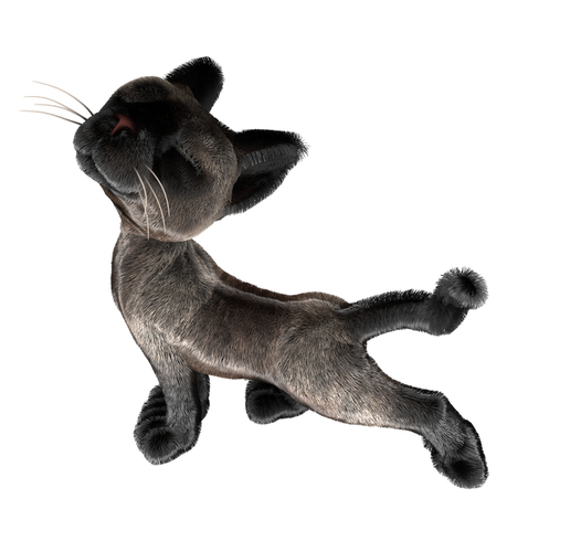

  • GranvilleGranville Posts: 702

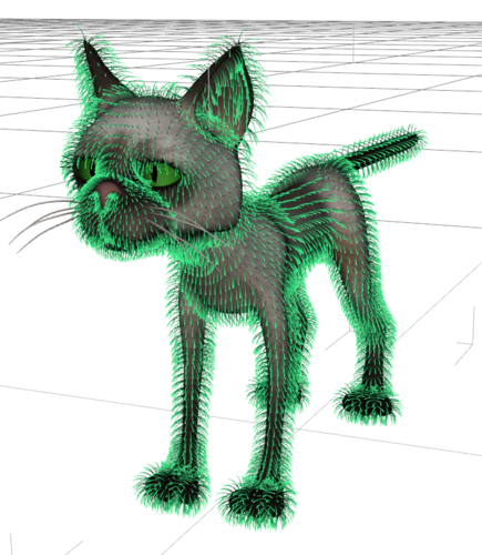

    I'm still messing the the number for hairs and thickness but he is cute.
    700 x 666 - 325K

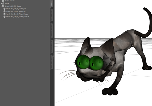

    edited March 2014
    Here Noodle has more hair.
    700 x 666 - 257K
    Post edited by Granville on

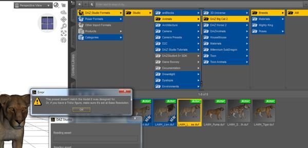

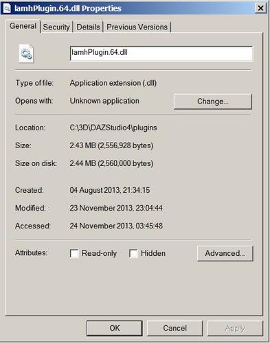

  • Midnight_storiesMidnight_stories Posts: 4,112
    What ever it is I can't say it's the Hyena. I have just got a new computer on Friday. New install of DS, downloaded the Hyena double clicked the Default LAMH Duf rendered it, this is what I got. The windows hourglass icon kept flashing like it was trying to load something but then the loaded the LAMH Player into the panels and that stopped. the only other thing I can think of is if you have the Octane Render plugin installed it plays up with LAMH. Sorry don't know what else it could be.
    1200 x 1200 - 447K
  • Fred Winkler ArtFred Winkler Art Posts: 795
    Yeah no doubt it's not the hyena either, hence I haven't bothered you with a PM, as I don't think it's something you may even know. I have no clue why it doesn't load it with the hair. I don't have octane either. But it is right I only load the one that says LAMH preset, don't need to do anything else, right?

  • Kendall SearsKendall Sears Posts: 2,995
    FWArt said:
    Someone may already have asked this, and I may have missed it, but I looked through it and I don't think I found anything. I bough the Hyena, and trying to load the LAMH part but can't figure out what I am doing wrong. I got the Polar bear, which works great, I load it, add the LAMH and perfect, with this one I don't seem to figure out how to load it at all. If I click on the preset it just loads another Hyena, but not seeing any hair. It is showing when I open up the tree, but no hair on the Hyena at all, wonder what I may be doing wrong here. I got LAMH full version and player, though I seem to only have the option for the player now in the "create" tap, but that shouldn't make a difference as the Hyena works with the player alone as well from what the page said. so any help would be greatly appreciated.
    Make sure that ONLY the full plugin is installed. The two cannot be installed at the same time.
    Kendall
    Hmmm that's strange I have both installed and it's working fine, Even Geo-Grafted object are passing with flying color !!!

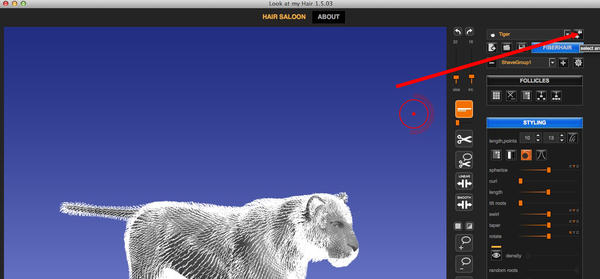

    Hi Jodel, I'm not sure I completely understood but, if you load a preset from .duf, start the LAMH editor, initially you should see the model (and white guide hair) in the LAMH viewport. At that point, just click the switch button (see attached image) and the tools will all be available (you'll notice that also the guide hair color will turn green).
    If you want to remove hair areas quickly, I'd suggest perhaps editing the density map or scaling down the hairs.
    1360 x 632 - 359K

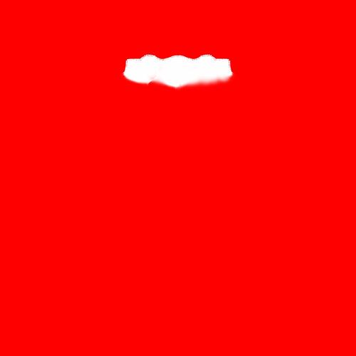

    I'd do it another way. Try to use the attached density maps for the SkinFace and SkinHead. Load them in the materials setup dialog, and you'll get rid of all the hairs from the head, and on the neck.

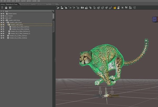

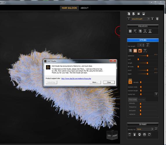

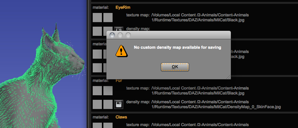

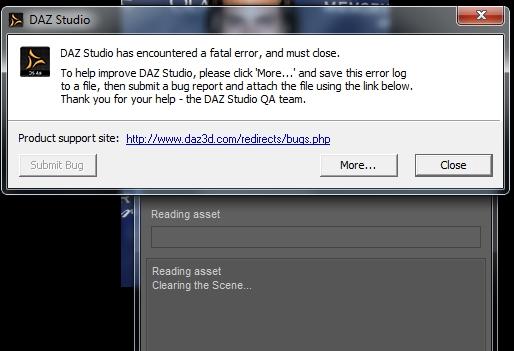

  • JOdelJOdel Posts: 6,322
    Well, doesn't appear to work. I can find and link to the density map. The panel lists it anyway, but it doesn't apply. I hit the update and save button up at the top of the panel, and nothing happens. And when I hit the save button next to the box to apply the map I get this:
    Since it will only list one map at a time I'm assuming that one needs to do this in two passes? Although I suppose neck fur could be hidden by increasing the size of the neckpiece on the headress.
    Still haven't got it to a point that I can export without crashing yet.
    781 x 336 - 127K
    Well it seems bound and determined to act up. Originally when I applied the hair and exported it tossed me back to Studio when finished and there was the sphinx with hair. Including the hair which was poking out of the headdress.
    Now it doesn't ever return to studio, and if I move the window aside there is the sphinx with the green guide hairs. I'm not convinced that anything but the guide hair is even coming in, for when I render it the coverage seems pretty sparse.
    As to the head and neck; there is more than one way to de-skin a cat. When I couldn't get the density map to apply I just shrank the cat head and ears down until it was pinheaded enough to fit inside the Genesis head and headdress. I suppose it's possible that the screwy behavior I'm getting now may be because the head is so whacked out of scale, but am assuming not.
    Will try it again tomorrow and see if starting fresh gives me any different results.
  • Alessandro MastronardiAlessandro Mastronardi Posts: 2,659
    edited March 2014
    Hi, I see some issues with your LAMH installation: some button images are missing, and i doubt you are using latest 1.5.01.
    Please check out if it's so; eventually, as a suggestion, use the DAZ DIM to remove and reinstall LAMH 1.5.01.
    BTW, the button you are clicking is for saving the density map to an external file, while the one you need to click to load one has a "+" sign that you can't see because of the interface missing images.
    If you need any help don't hesitate to contact me, also via email.
