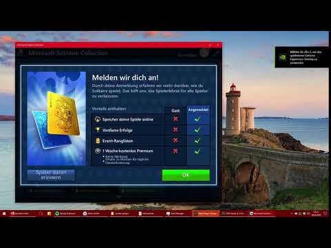

    I managed now to make a video.
    I show it you, if I switch to a other window its blinking.
    See here the Video:
    I just checked in fullscreen my last render and even there did that Window popped up to grab my attention that the render starts in a few seconds -_- I have not checked the box "keep always on top", but its still doing that :(
    Post edited by Loony on
