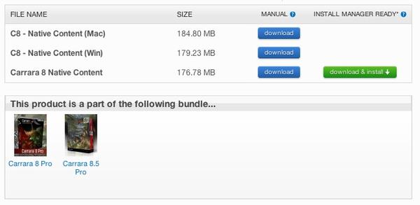

  • CarltonMartinCarltonMartin Posts: 147

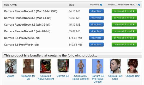

    Fourth try at posting this. Then I believe you missed installing the original Carrara native content. When you choose "Carrara 8.5" or "Carrara 8.5 Pro" (whichever) in your account, you see something like
    646 x 382 - 85K

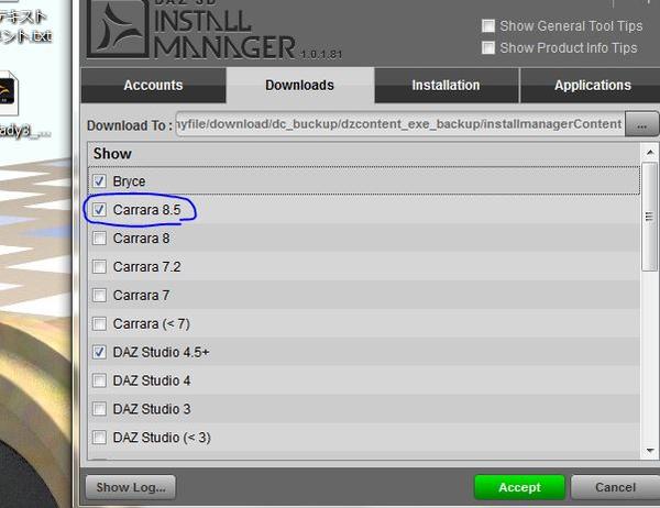

    Second try at *this* part of the post. Choose "Carrara 8 Native Content" at the bottom and you'll see the files to download:
    648 x 316 - 41K

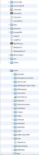

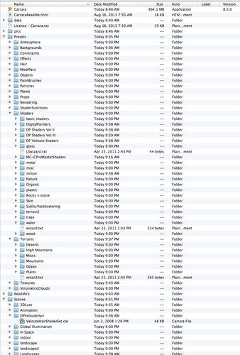

    Then merge the contents of that native content into the appropriate folder within the Carrara package as described in the other thread:
    405 x 1600 - 170K
    Sorry. I've been in posting hell, didn't notice your intermediate post. The order they're put in shouldn't matter, only that they're there. If they're in the package and where they should be, I'm at a loss. Sorry!
  • LamarLamar Posts: 6
    That worked finally. Thanks, Carlton!

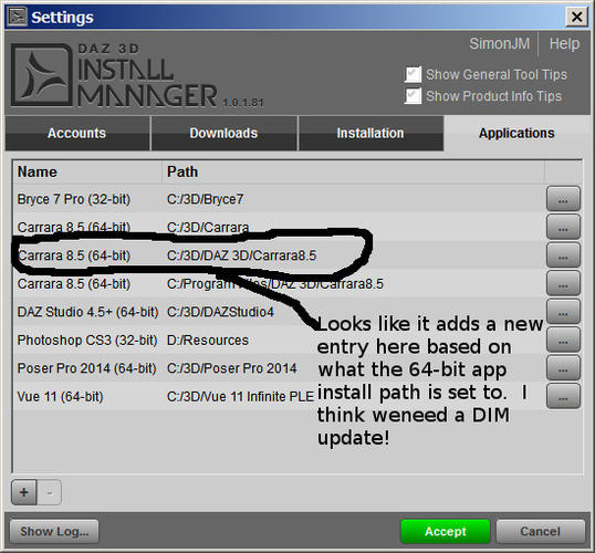

  • ken_7dac5ac5a2ken_7dac5ac5a2 Posts: 54
    I have Carrara 8 installed and now Carrara 8.5. Carrara 8 is installed to C:\DAZ\Carrara8Pro64 and has been for a long time. Carrara 8.5 is now installed to C:\DAZ\DAZ 3D\Carrara8.5. The latter was determined by trial and error, having noted (as others have) that it just adds another path for Carrara 8.5 in the DIM | Setting | Installation tab if you don't do what it seems to want (i.e. DAZ 3D in the path). So far, so good.
    I now have only one entry (each) for Carrara 8 and Carrara 8.5 and they are the paths above.. Both versions seem to work at first glance.

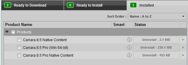

    Now the problem: Carrara 8 Native Content is installed to C:\DAZ\Carrara8Pro64 and DIM lists it as installed 7-31-2013 (before 8.5 was released). The only way I know how to tell this is to do right click then select "Installed Files..." and click on one of the links in the resulting dialog.
    However, I have independently verified that there is a lot of stuff under Presets in the Carrara 8 directory and hardly any in the Carrara 8.5 one. It pretty clearly has not been installed for Carrara 8.5.
    So how can DIM install it in both places anyway? Or is there something I must do to get that to happen.
    Even if I get it to happen, what will happen when I click a link in "Installed Files...".
    In any event I necessarily need a different path specified for Carrara 8 and Carrara 8.5. DIM apparently uses the one for Carrara 8 when it is Carrara 8 Native Content.
    It looks to me like a viable solution would be to make two packages (with the same content):
    Carrara 8.5 Native Content
    Or is there another solution to have it installed for both versions?

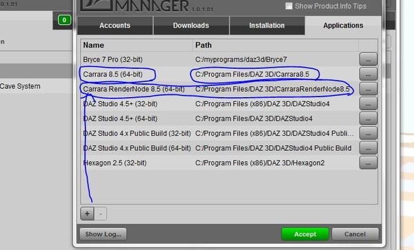

    For starters (I kind of doubt it will work, but you can try it anyways) Go to your Install Locations area and, even though this is normally covered in the "Applications" tab, add both Carrara install locations to the list and label them clearly. In this example, "Carrara 8" and "Carrara 8.5".
    Also, be certain that both paths are within the "Applications" directory.

    Only use DIM for the current Carrara 8.5
    Like BooJum the Brown Bunny recommends:
    If you've been using DIM on a fresh installation of Carrara 8, use the DIM to uninstall everything related to Carrara 8... everything.
    This will only affect plugins that can be uninstalled. Everything else will remain in the installation directory intact and can still be used either in that same location, or dragged into a new location. I like to keep things simple, so I prefer default directories.
    If anything has been installed for 8.5, I would uninstall all of that too. Again... if other plugins or whatever are left behind... keep it - it should easily survive this whole process.
    Now open DIM and remove Carrara 8.1 from the 'Applications' list by selecting it, and hitting the minus sign(-). Make sure that the correct 8.5 directory exists in there.
    If you've added 8.1 to the Download locations tab, remove it from there too.
    Now log in and download everything that has to do with Carrara and have it install after download, but not delete the files afterwards (that check box is in the "Install" tab)
    Now go to Local Drive > Public Documents > DAZ 3D > Install Manager > Downloads
    Install Carrara 8.1 all over again manually.

    I am still stuck with the Carrara 8 Native Content installed in 8 but not in 8.5. Any suggestion on how to remedy this, preferably within the confines of DIM?
  • TGS808TGS808 Posts: 168
    I like DIM. I have nearly 500 packages. It's certainly better than downloading those manually. Much better.
    It's a complicated thing to do and so some learning curve is necessary. It works better if you organize your content in a way that works easily with it. Putting all the content in one directory makes it easier, for example. And keeping non-DIM content in a separate directory is probably a good idea. I put all the presets I make in another content directory, for example. For the most part I've found it works well and has sufficient options to organize your content in a reasonable way (though perhaps not the way you used to do it. ;-) )
    But I'm less interested in commenting on the advantages and disadvantages of DIM (especially in this particular topic), than in understanding this one particular issue. How do you handle content like "Carrara 8 Native Content" that is supposed to be used in two versions. That is relevant to Carrara 8.5 installation, the subject of this topic.
    I don't see how that can work. For example, how would you uninstall from one and not the other?
    I think there needs to be two versions of native content, one for each version. I said above they could have the same content, but I see later that the one for 8.5 should have what is in the one for 8 plus the new stuff for 8.5 since there is only one package named "Carrara 8.5 Native Content".
    Within the confines of DIM? No.
    That said... You are right in thinking that you need "two versions of native content, one for each version".
    The only thing in the 8.5 Native Content folder is some Skin shaders. Everything else needs to be ported over from 8.
    Make a copy of the Native Content from the 8 folder and move it in to the appropriate directory in the 8.5 folder.
    Then, add the new 8.5 Native Content items (the skin shaders) to the appropriate directory in the folder you just copied over from 8.
    When you're finished all the Native Content from 8 will now be available in 8.5 (plus the new Skin shaders 8.5 offers) and it will also still be available in 8.
    The entire process should take no more than a minute.
  • bobhbobh Posts: 0
    And if you're on Mac OSX, Native Content and any content that involves program data like extensions, leaves or presets HAS to be done manually, as explained further up the thread. Unlike DOS/Windows, Mac OSX Carrara requires copying into the software package, which so far has to be done manually and can't be done through DIM.
    You're not too far off from the solution I just came up with (Windows):
    0. Download DIM and save (keep the installation file), do not run.
    1. Install DIM on a clean box.
    2. Go into DIM, logon, and go into settings.
    3. Set up a special folder of your own to place all downloads into (not the default).
    4. Download all your software and bundleware into it.
    5. Save your serial#s in a text file.
    6. Burn it all to a DVD or flash drive.
    7. When it comes time to install to an offline box, you install the DIM, set for offline, aim it at your downloads directory, and let it fly.
    This is WAY too convoluted, but one plays the hand they've been dealt.

    GigaShadow and bobh:
    Thanks for the info. The gist of what you both said is that you can't fix it in DIM, and I would guess that is likely so (and probably won't change ;-) )
    What I did:
    1. Copy the Carrara 8 directory to somewhere for safe keeping.
    2. In DIM uninstall Carrara 8 Native Content.
    3. Remove Carrara 8 from the Applications tab in Settings.
    4. Reinstall Carrara 8 Native Content from the Ready To Install tab.
    The Presets are now in the Carrara 8.5 directory. It also didn't take long. The advantage of this method is that DIM should continue to work with Carrara 8.5, what I plan to use in the future.
    The Carrara 8 directory is now missing most of the Presets, but I have the backup if I really want to use it. It should be out of the control of DIM, which is OK. I don't really want to use it unless I have trouble with Carrara 8.5.
    But if they had done it right, I could continue to use both with DIM, the way it "should" be.
