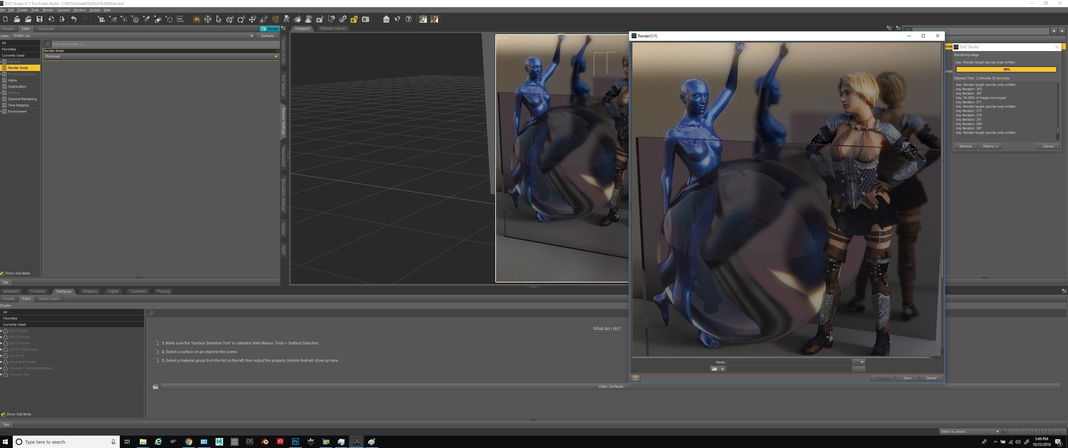

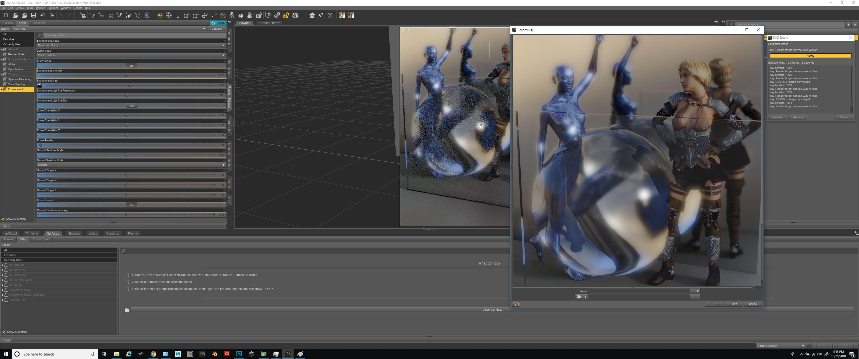

    DOF-weirdness in interactive mode...
    If I have a scene that has DOF, and I use the interactive mode, it gives me the blur just fine in the preview window render, but it doesn't work in the actual render.
    Question: Is DOF supposed to work in interactive mode, or not?

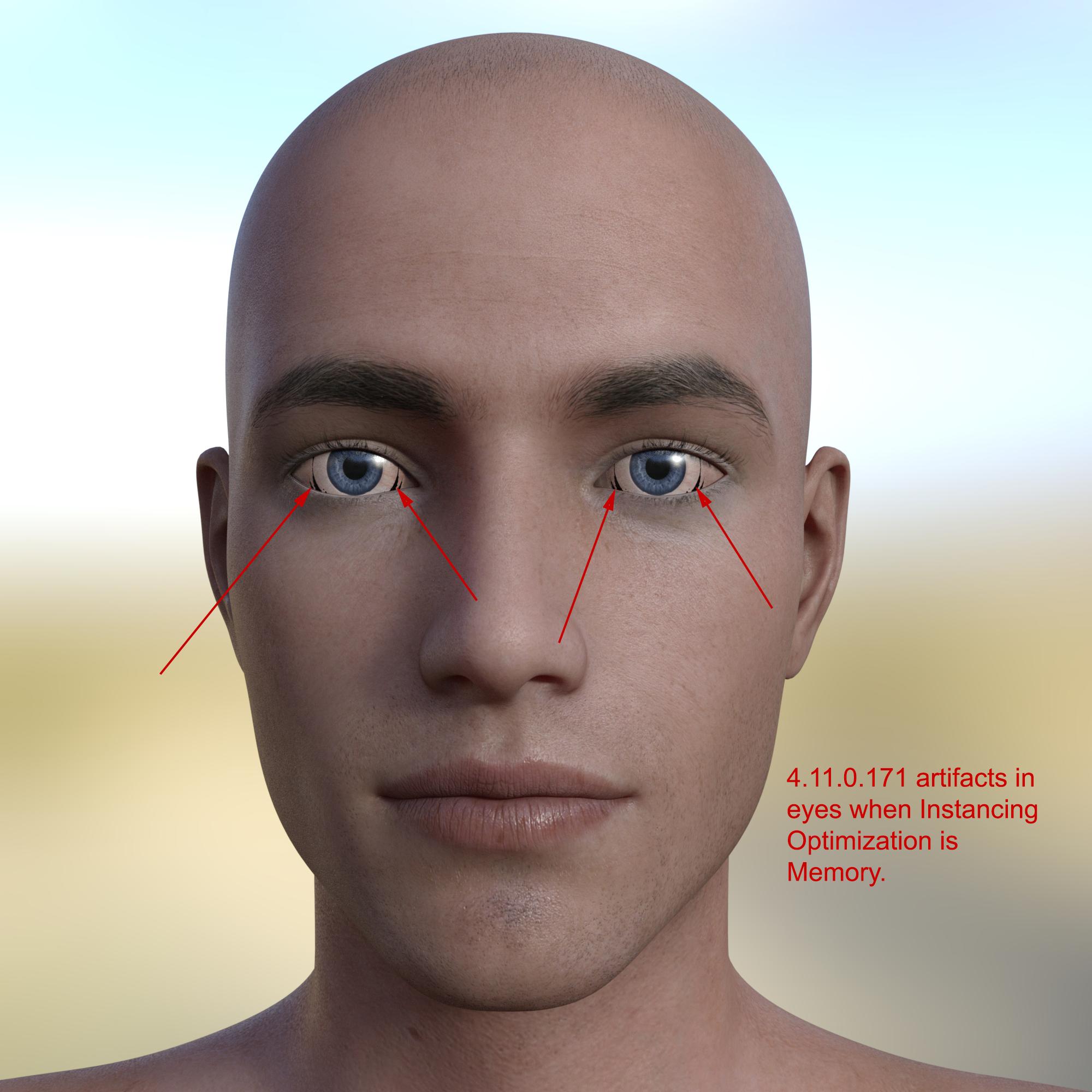

    In DS 4.11-0.171 Beta, when I have a character that is translated away from the origin (z=-100 instead of z=0), Instancing Optimization = Memory causes dark artifacts in the character's eyes. Changing the Instancing Optimization to Speed eliminates these artifacts in this scene. I don't even have any instances in this scene, so why does the Instancing Optimization setting have any affect on my render at all?
    This same scene does not have the artifacts in DS 4.10.0.123. In DS 4.10.0.123, a character has to be moved much further from 0,0,0 to have any of these dark artifacts show up. The fact that my particular scene works fine in DS 4.10.0.123 but not 4.11.0.171 concerns me. Has some prior fix gotten lost?
    I have submitted a Request #277321 with renders and the scene file attached.
