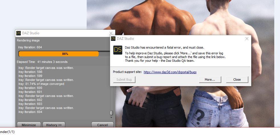

    edited April 2018
    This is what happens to me now.. 2 characters, a house, a bike. Some lights. CRASH. Halfway through rendering.
    I've rendered scenes far larger, with muliple characters, complicated situations... And yet... Ugh....

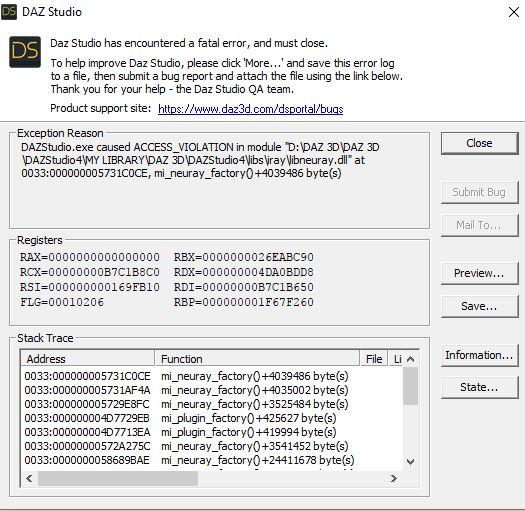

    Click the More... button and it will tell you which module is actually crashing, that may be informative.
    I got another crash... Ugh... 86 percent......    Module screenshot attached....
    982 x 472 - 75K
    525 x 511 - 79K
    I see that access violation fairly frequently.....
  • nonesuch00nonesuch00 Posts: 18,886
    https://www.migenius.com/doc/realityserver/4.4/resources/general/iray/api_reference/iray/html/group__mi__neuray__ineuray.html
    Looks like memory was attempted to be accessed that does not exist. You should file a bug with DAZ.
    I will file a report next error I get.  Unfortunately I do not have great luck with tech support so I usually do not bother.

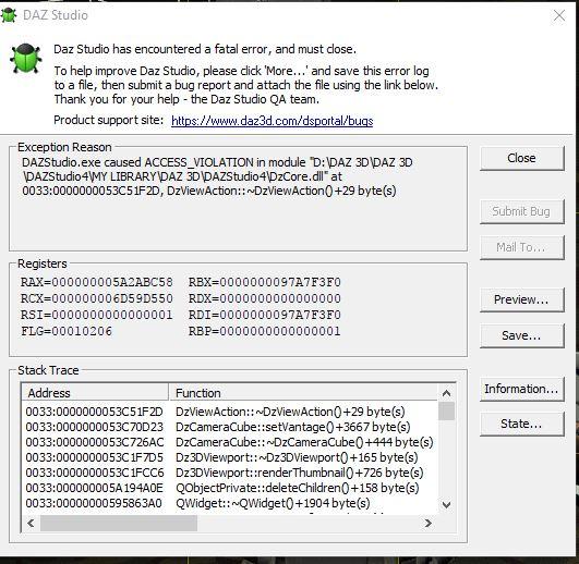

    Nother crash here as well. Had another odd thing happen as well.  I've got my scene set to a custom size ( I render at 2000 and above) so I had it set to Wide2000 which is just 2000 x 2300 if I remember correctly.  I ALWAYS render to a custom size.  I started my render and it started rending to active viewport view instead.  I've NEVER seen it do that and I have zero reason to want to do that.  My scene was still set to my custom settings, which I always check before hitting render as I need the higher resolution.  It was still set to my custom setting despite it rendering to the  active viewport view.  I'm only mentioning this because its like the third time its happened in the last couple of weeks and because Studio crashed right after that.
  • Richard HaseltineRichard Haseltine Posts: 111,937
    This script will disable all additional plug-ins, leaving just those published by Daz and AniMate - it might be worth seeing if that helps with the crashing http://docs.daz3d.com/doku.php/public/software/dazstudio/4/referenceguide/scripting/api_reference/samples/plugins/plugins_load_config/start

    Tonight my machine crashed twice while rendering the new Winter Men's outfit.
    536 x 517 - 75K
    531 x 518 - 84K
    My special library of DAZ crashes seems to continue to grow....  I guess its like Pokeman, I need to get every posisble error there is. =-)
    Those crashes are in the same two functions that the earlier two crash reports you talked were in. If you save the scene, & both crash dump files it should be easy for DAZ support to at least state the reason why the crash is happening both times. If it's a problem in an external library like iRay they can't really fix it unless they are sending the library bad data.
