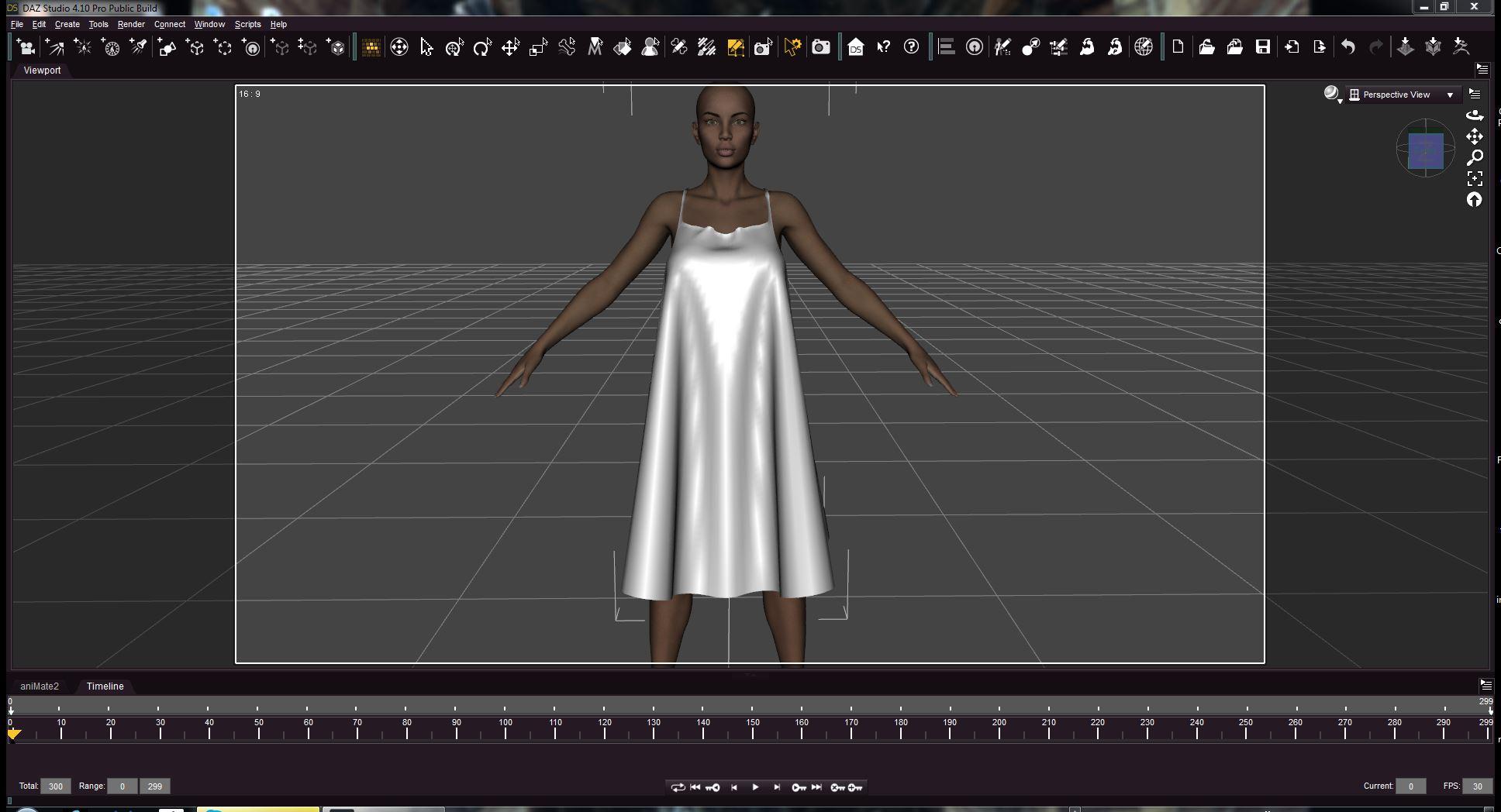

  • WendyLuvsCatzWendyLuvsCatz Posts: 41,845
    edited January 2018
    this was a DAZ studio cone primitive
    I hid and deleted bits with the geometry editor
    I added subdivision and dialed it up and exported and reimported an obj for more detail and it rounded the armholes I cut out
    I sized and translated it to fit the figure better the added a dforce modifier dynamic surface and draped it
    1936 x 1048 - 187K
    1936 x 1048 - 264K
    1936 x 1048 - 214K

  • this was a DAZ studio cone primitive
    Thanks! Looking great!
