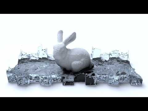

    So I am doing some beta testing for Alberto and it is all working well so far. Once I have done more testing and tried all the functions, I'll probably make a tutorial video to support this and for all potential users - It's not that complex but it does have a particular way of working that people will need to be aware of. I'm enjoying it so far and just delighted to have this working in Carrara!
    Here's a video of some of my early tests.

  • DUDUDUDU Posts: 1,945
    Very promising!
    It's difficult to do better in Realflow, I can't wait to make the comparison.

  • Wow Phil - those tests look great.
    I especially like the one with the water flowing between and around the cubes - we'll finally be able to make nice beach waves using something like that. What were the calculation times like for that one?

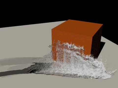

    In case people haven't seen the video done by Ryan L. Guy to promote this plugin - this is not Carrara specific and I don't think we have the "lego blocks" render option, but it gives an idea of the scope of what you can do with this. I'll have more Carrara examples in the next couple of days.

  • I wantz nows heart
  • ImagoImago Posts: 5,782
    In the video I see meshes becoming fluids... Looks interesting, REALLY interesting!
    Little question: Can some kind of force be applied to those meshes? For example a char that hurls a tomato against a wall.
    If we can do such a thing, added to the ability to have adehesive fluids (heart!!!) many of us will...*Drops on the floor drooling*
