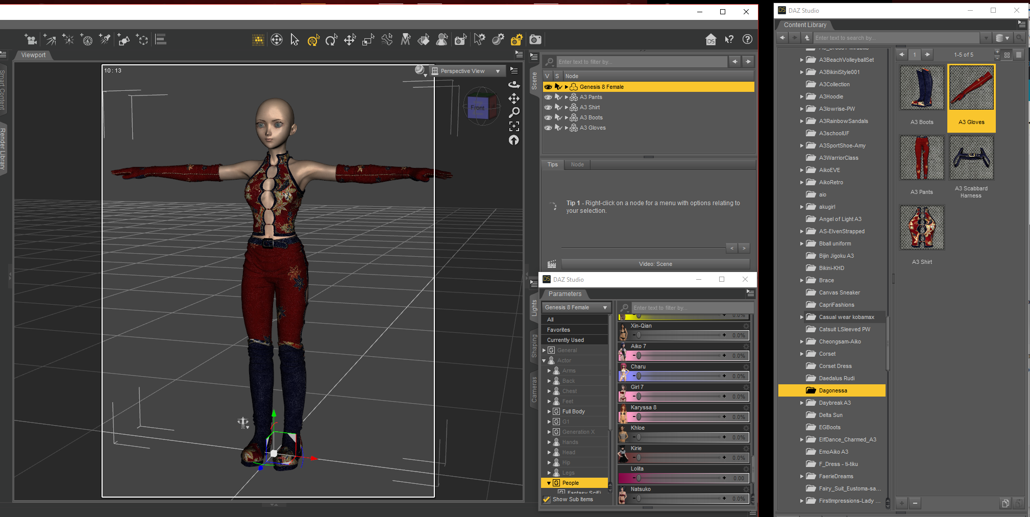

    Had a problem with the final steps in making an Aiko 3 clone, getting lost at step 4, can someone post a screenie/s showing what to do ? :-
    Loading the Clone:
    3. Select Genesis 8 Female. Under the Parameters Tab, enter Hidden/Clones.
    4. Enter the properties of the newly created clone morph, then change the Type to Modifier/Clone.
  • Bunyip02Bunyip02 Posts: 9,345
    edited March 2018
    Loading the Clone:
    Finally worked out what I was doing wrong - now got it to work !!!!
    2018 x 1013 - 528K
    Post edited by Bunyip02 on
