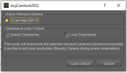

    edited May 2022
    New version of CamLock2022 has been released. Check out the related video.
    CamLock2022v2 allows you to easiy lock your Beauty/Production camera during scene composition.
    Updated with "Camera Locked" scene indicator.
    Files linked below
    https://sites.google.com/site/mcasualsdazscripts9/camlock2022v2

  • mCasualmCasual Posts: 4,607
    Hi there
    I posted CamLock2022V2 on its own google-sites site page
    this way :  https://sites.google.com/site/mcasualsdazscripts9/camlock2022v2
    i will also make a thread for it in the freebies forum
