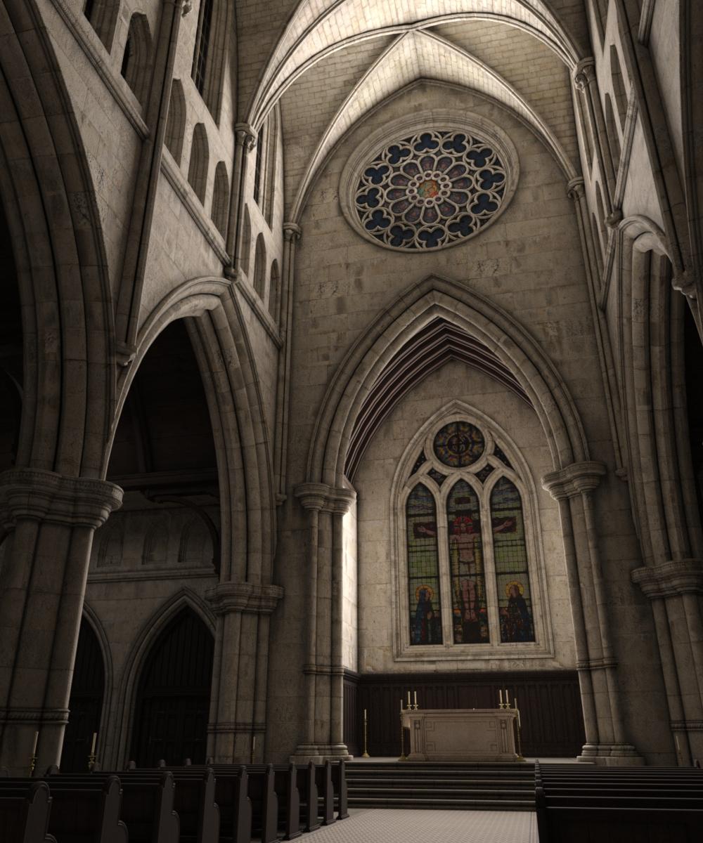

    RGcincy said:
    Great test rich. There's a lot of dark space's reliant on bounce light here, so i think Iray stacked up quite well all things considered. The 200k light facing the rose window - was that needed to clear the area?
    I originally didn't have it, then added it to try and bring the window out more. I didn't want to make the 1000K light facing away from that window two-sided as it was so close I thought it would make the window too bright, so I added a second light, flipped it around and made it less intense. You can see the difference below. The first image is with 1 light by the rose window and the second is with 2. The latter highlights more of the stonework  in the window.
    [Note: the images below use a whitepoint setting of 1, The one I posted previously had a light blue white point to give the image an orange cast.]
    kyoto kid said:
    ...I wonder what would happen of you put one behind the rose and stained glass windows.
    I tried that too and it didn't add a lot of light to the window. The surrounding stone got lighter but the color pattern in the window itself stayed the same. If I reduced translucency on the window's shader, it let a lot of light through but then it washed out all of the color pattern.
    One interesting thing I noticed when I went back and did some test renders is that the render image has much brighter window colors than the saved .jpg. You can see below where the first image is a screen grab of the  render window and the second is a screen shot from the saved jpeg. The window's colors are greatly muted and the blue mostly disappears. Is it better to save a .png or .tiff? Both screen grabs are jpgs, so it's not inherent in the jpeg format.

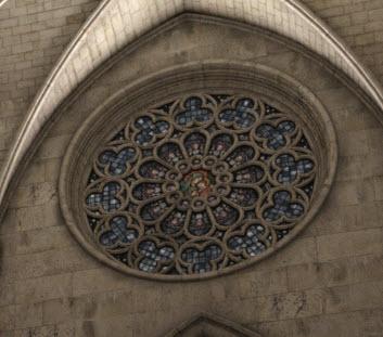

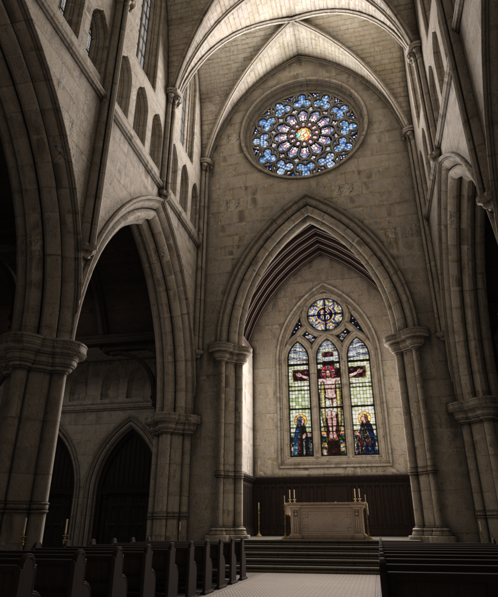

  • RGcincyRGcincy Posts: 2,864
    edited January 2017

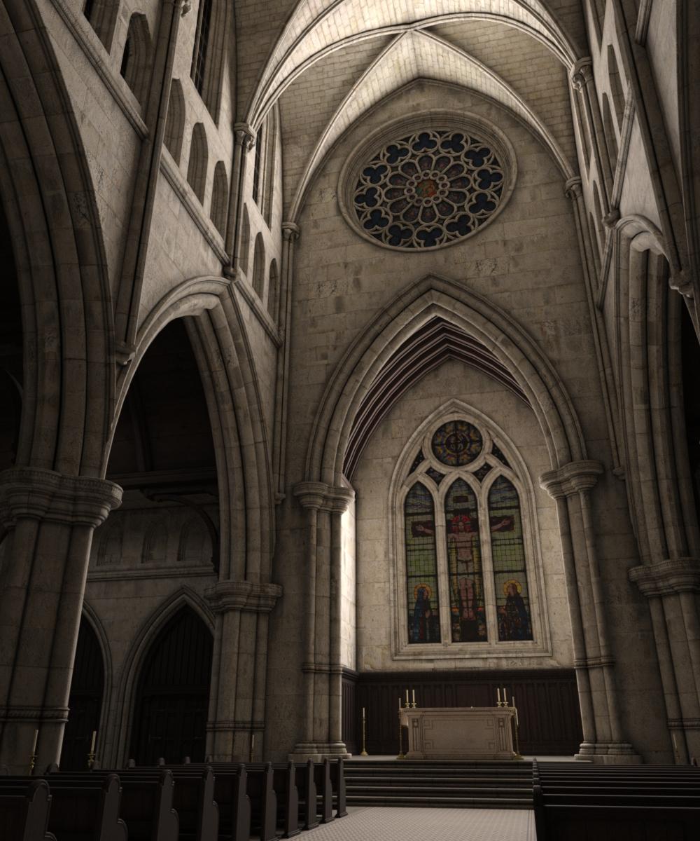

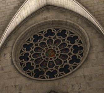

     If that glass were set to a low ambient value (about 5 kcdm/2) i think it would boost the realism. I know this is more than likely GI testing, but it would be interesting to see if that affected render performance. You would need to drop the diffuse texture into the emissive texture slot, otherwise it would look flat. I don't have that particular set, otherwise i'd check myself. As usual, thank you for all the testing!
     Ok, I got the rose window light to work. There were two things I did:
    1. Put the diffuse texture into the emissive texture slot as suggested by KA. This is key to get the colors, otherwise you get just white (I learn something new every day!)
    2. Removed the 200K ghost light I had pointing at the rose window. I iterated the luminance value, finally settling on 250 Kcd/m^2. On revisiting the settings, I saw I previously had it on cd/m^2, an order of magnitude lower, which is one reason I wasn't getting much light output. I  went ahead and illuminated the bottom window as well. For this I used a 75 Kcd/m^2 setting which gave results similar to the rose window.
    With the windows emitting, the render convergence ramped up more slowly without the fast jump to 96% with ghost lights only. But the render time to 100% convergence was 29 min 39 sec, not much longer than what I posted previously 23 min 58 sec. Just for the record, the rose window glass has 36 polygons and the lower window 16.
    Render is 1000x1200 saved as a png.
    The non-illuminated window I posted previously would be representative of a night scene as there would be no sunlight. This version is better for a daytime render.
    1000 x 1200 - 2M
    Post edited by RGcincy on
    Oh yes, miles better. You are going to take a render time hit on the emissives, there's not much i can do about that (for the moment at least), but it's all a balencing act. As ever, a worthy effort and interesting results, thanks for your time Rich.

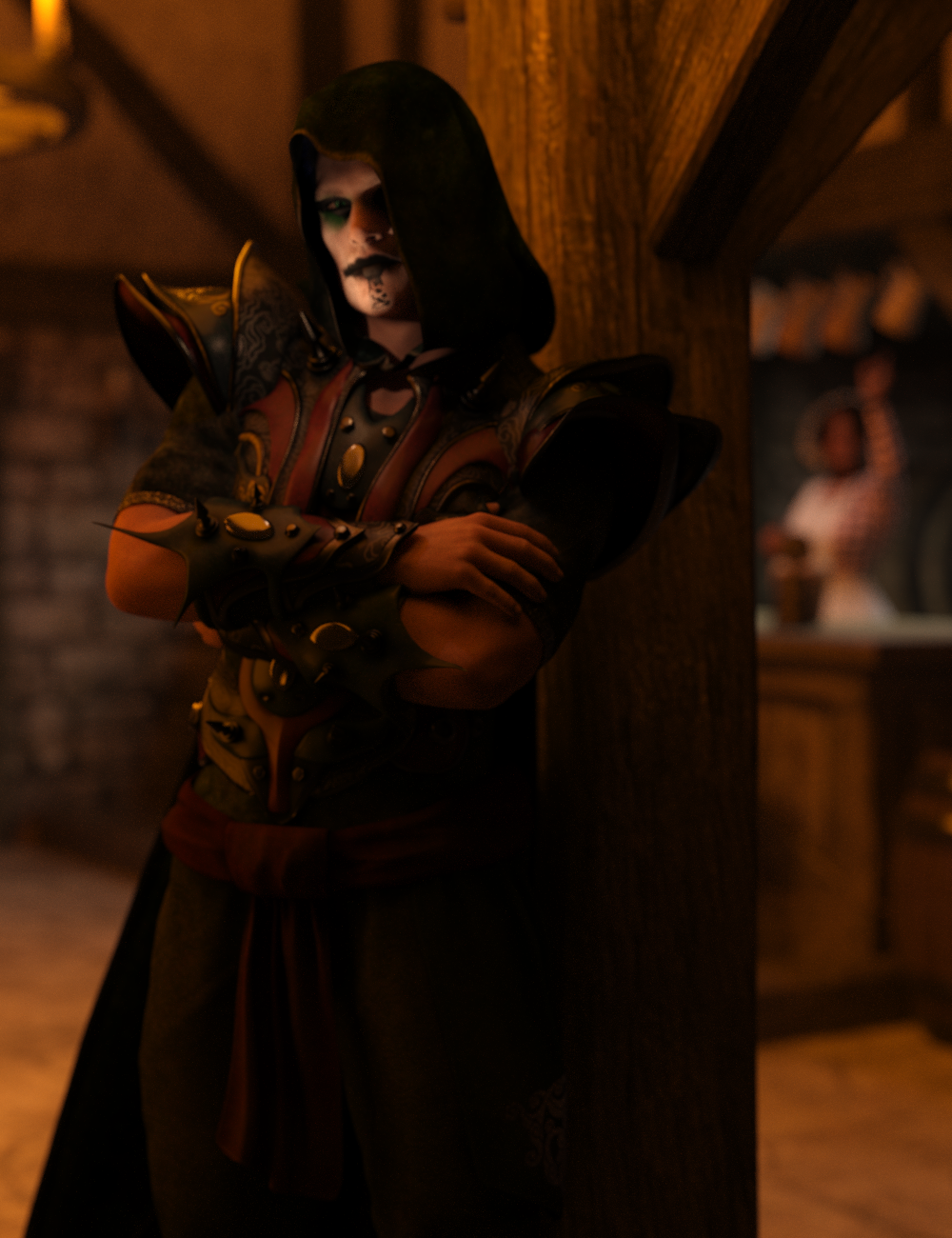

    I did a setup and joking named my little setup "Boo" Lights because it's a mini setup using Ghost Lights. Not fully grown because you can add so many more lights and make things as complicated as you want.
    That dress is Romance on Faith and Side Tail Hair.
    These lights are SO much fun to play with!!!  One suggestion- I would add a dark light (black or black cherry) in the options because my render used a dark light to help with the contrast on the right side as we look at it. It came from behind, and made a difference in her outline. (Yeah, go back and look, you know you want to now that I've pointed that out LOL)  I remembered that from using 3DL and some vendors had it, and I thought "Oh, interesting." And I used it a lot to dim walls where spotlights hit (you know, when you are shining on a character and that darned wall behind him/her gets hit with it too. Put a black/dark gray/dark whatever light on it and mute it.)   So a dark light option (or several) would save us the trouble of having to go into Surfaces>Diffuse.

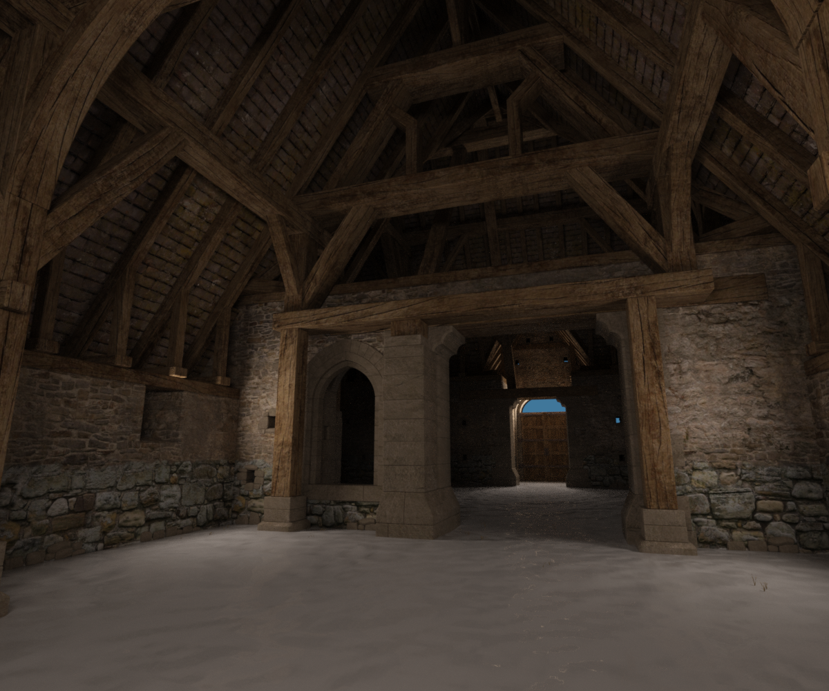

    Tried out another set, this time Tithe Barn. It has a interior lit by a lot of tiny windows so tends to being very dark. As the product was setup for 3DL, I removed the existing lights and added the Iray Uber Base to all the materials. I then added 6 lights, 3 in the front room and 3 in the back room. The front room has lights of 700L, 500K, and 400 K. The back room has a 2000K light above the door, a 50K light in the ceiling, and a 200K light to illuminate some small windows on the left. The luminance values were set by doing test renders - ran just long enough to get an idea of how much different areas were being lit then made adjustments. Render time was blazing fast: 100% convergence in 3 min 2 sec for a 1200x1000 render. I tried a few other lights (e.g., Architectural Lighting Rig) which also render fast. What I liked about the ghost lights was how easy it was to set them up to get illumination in a large space.
    (Click on image for large version)

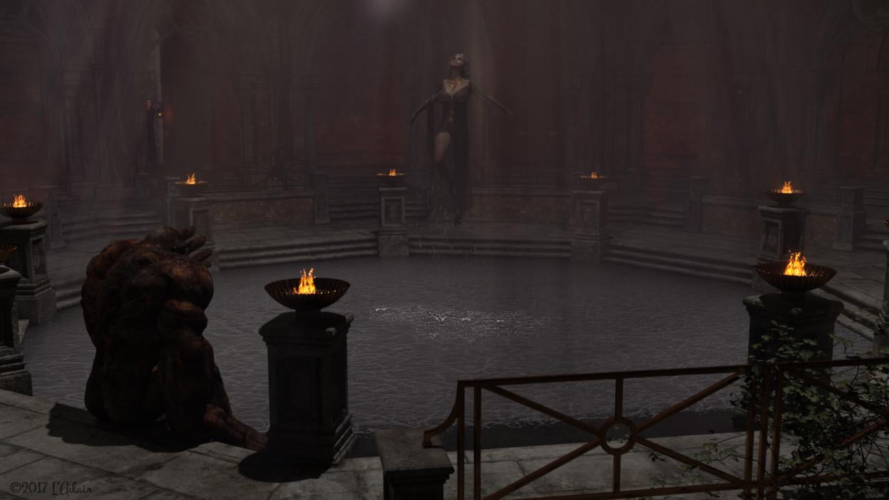

    Okay. One redone image coming up. laugh
    This is "Rise" from last July...
    Rise, by L'Adair
    And this is close to the same image, (there were some changes, apparently, in the duf file,) with ghost lights added...
    Rise, by L'Adair, reworked to use lights from the Iray Ghost Light Kit
    It turned out brighter overall. I added a ghost light to the left of the scene, tall and skinny, shining at the godrays prop, (Epic Props: Godrays & Volumetric Light for Iray,) making it more visible. There is a ghost light in front of her face to make it lighter. It also made the shadow under her chin less dark. There is a spotlight on her face, but if it gets too bright, it spills over onto the godrays prop. I also added ghost lights to the hallway-like area on the back side of the columns. There is one on the face of the acolyte and four sides around the lantern she is carrying.
    I suppose I should mention, also, that the original image was rendered in DS 4.8 on the "old" HP in CPU only mode, with a lot fewer samples. I think I let it render for three days, maybe. That was about average back then. The new image was rendered using the 4.9 beta, which is the same version just released today, on the new machine using a GTX-1080. I let it render overnight: 15000 samples in just under 8 hours. It's a much cleaner image... :)
    ..now that looks really good.
  • mcorrmcorr Posts: 1,105
    This is such a really awesome render. The only thing I could suggest to improve it is to maybe add some slight blue and light red color reflections from the rose on the top/sides of the dome.
