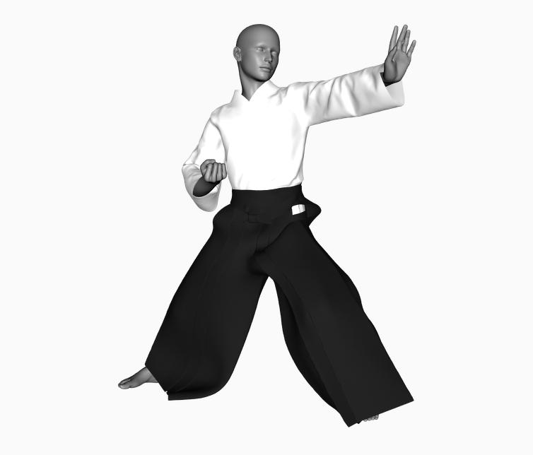

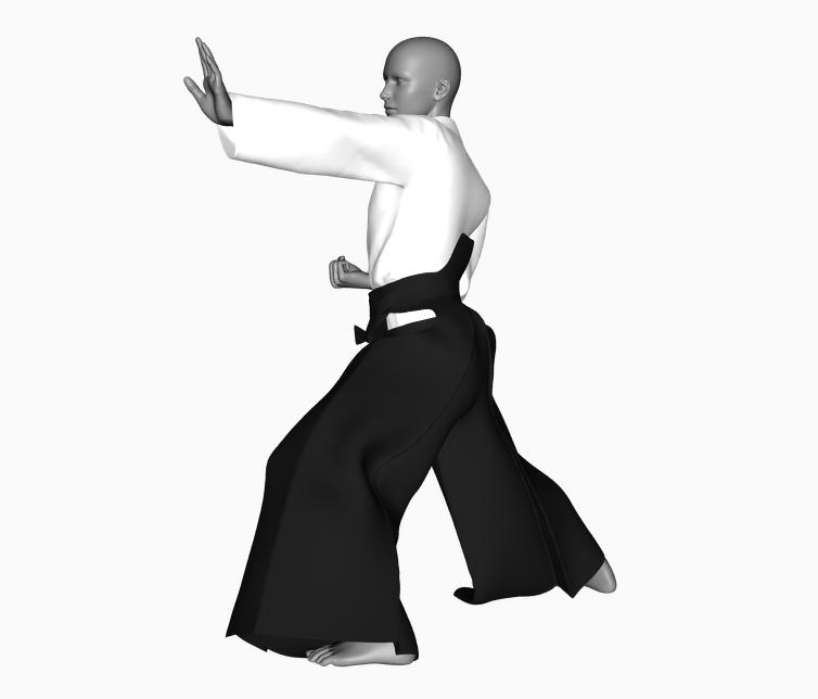

    DaremoK3 - thanks for the detailed explanation. Another example for using By Extension rather than By Neighbourhood is if you have an outfit with multple layers, lets say a vest and a jacket. If you use By Neighbourhood, the jacket will "stick" to the vest and will not move as freely as it probably should, while By Extension (assuming that each clothing item is a separate mesh) will produce more natural movement in each item. (Actually, I would be tempted to separate them into different objects and sim them separately).  You can always use the Rigidify option after importing to "attach" (still with virtual "springs") if you need to prevent slippage in certain areas.

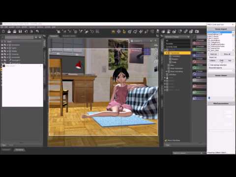

    You can also use Fix, and Clear Fix shown in the above image; if it's a pose series you're working on it wont work, but for a single pose, it's a fast and efficient way of stopping parts moving; I use it in my video tutorials (sorry about the umming and ahhing I do if you decide to watch em).
