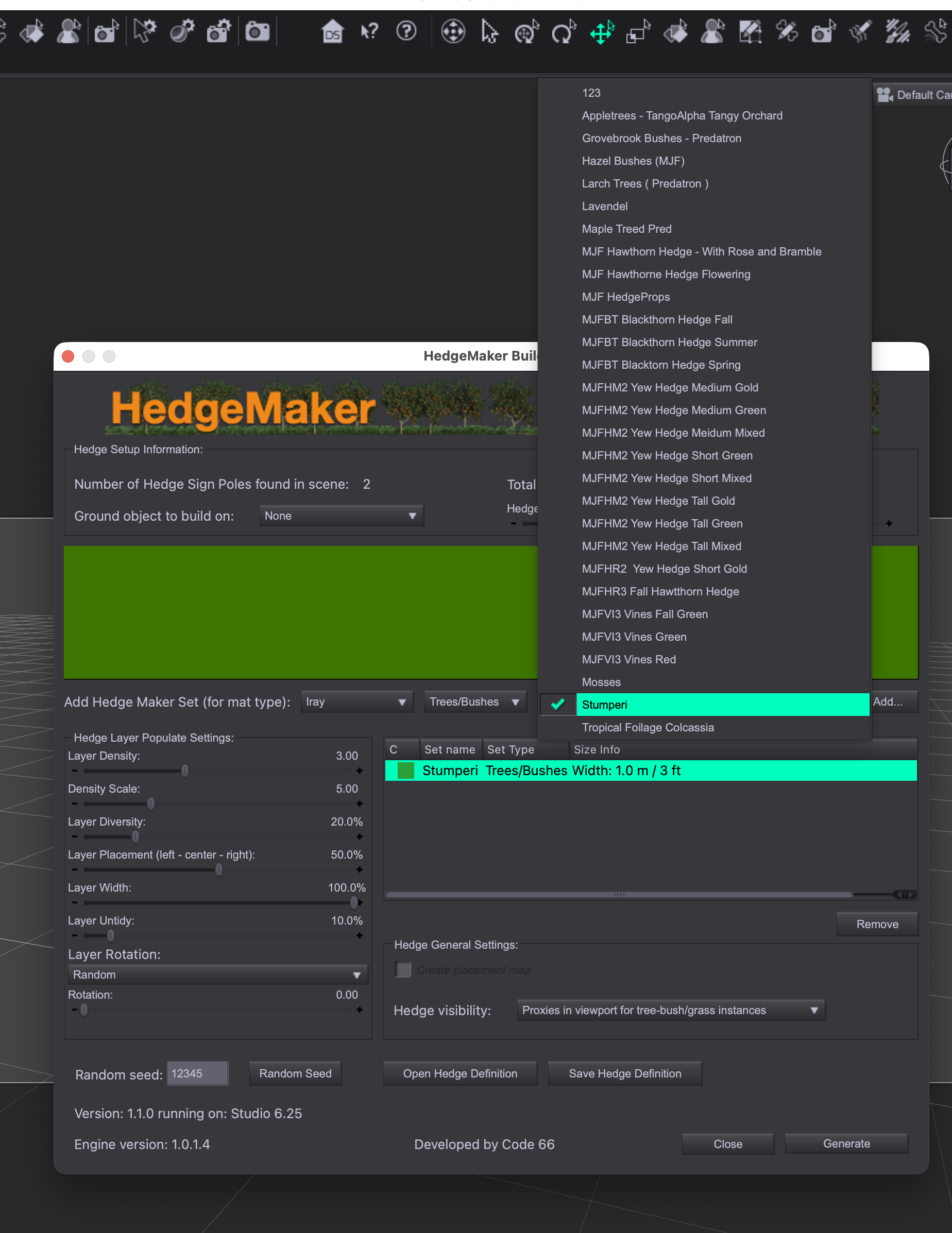

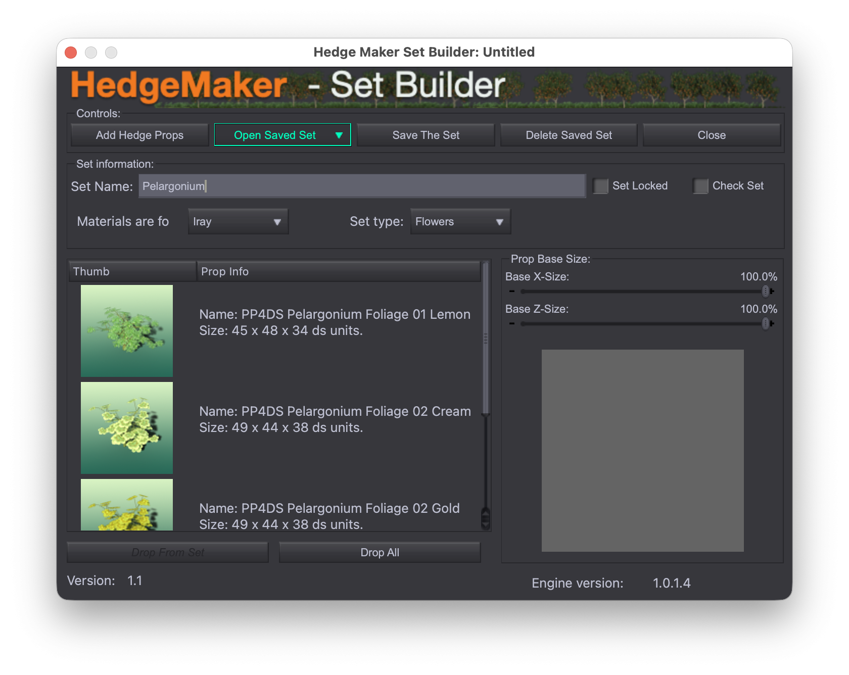

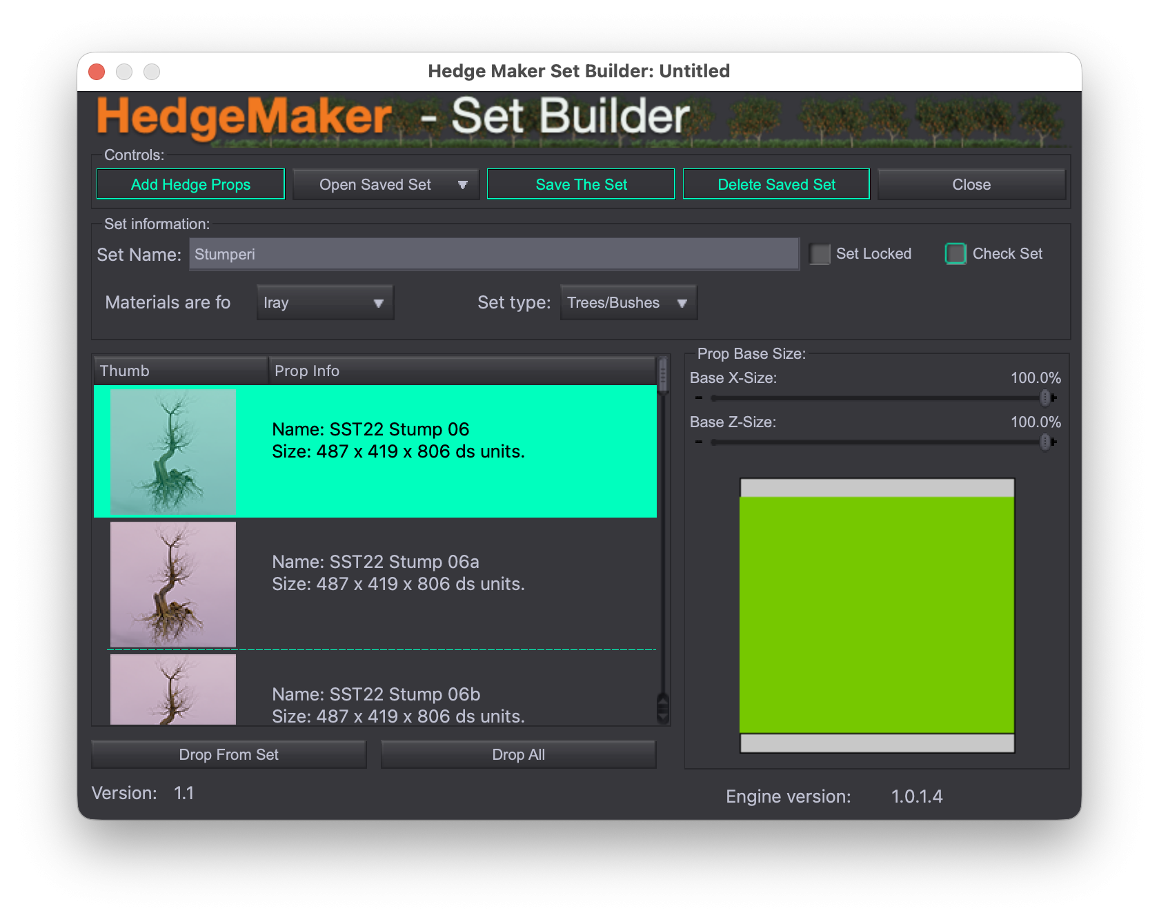

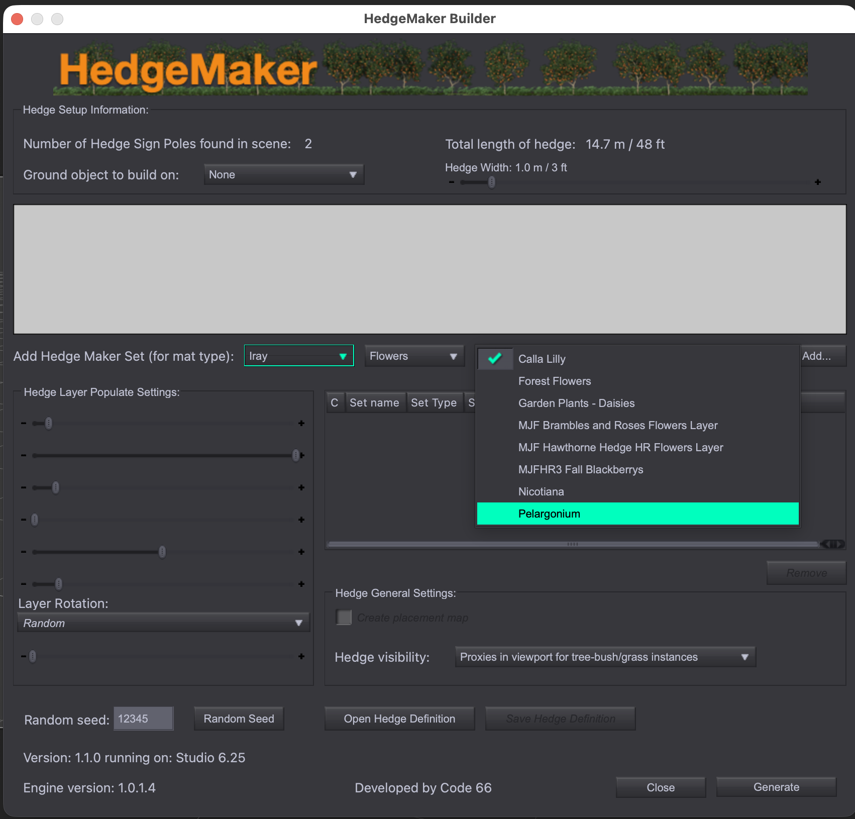

    If you use AnyType, all should be seen. OK  made two new sets, both Iray, one Tree/Bushes and one Flower
    Created a stump set
    Checked it in HedgeMaker
    Created a flower set
