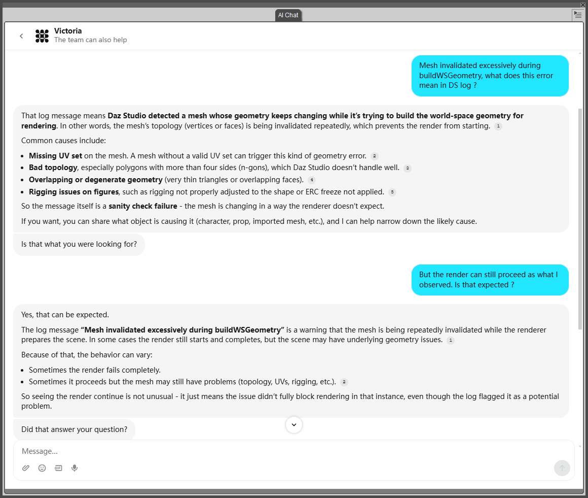

    Well then, I asked Victoria, here's the message for your reference... so it seems not a big issue to me ~~

    Thank you so much for all your help. It's nice to know what everything means, at least.
    (The concept of Studio having to do a "sanity check"...)
  • crosswindcrosswind Posts: 10,330
    I'm glad that helps !
